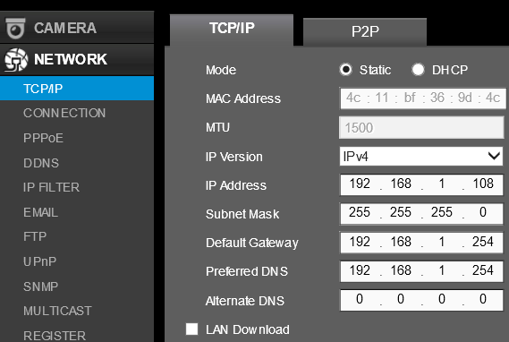

Make sure your Amcrest Video Security System uses a static IP. For example:

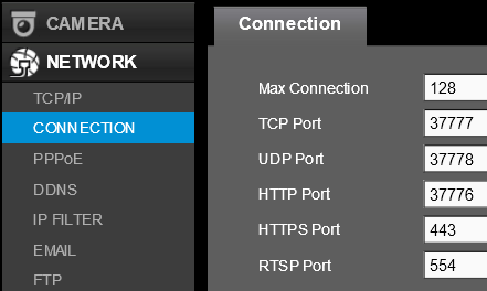

Also, my example code assumes the default ports. 37776 for HTTP, 37777 for TCP:
Then, just use the -L flag to tunnel your HTTP and TCP ports. This is like port forwarding, but your Linux system is doing it, not your router. This means a secure connection that you are in charge of.
Here is how:
Code: Select all
ssh <user>@<host> -L 37776:192.168.1.108:37776 -L 37777:192.168.1.108:37777
