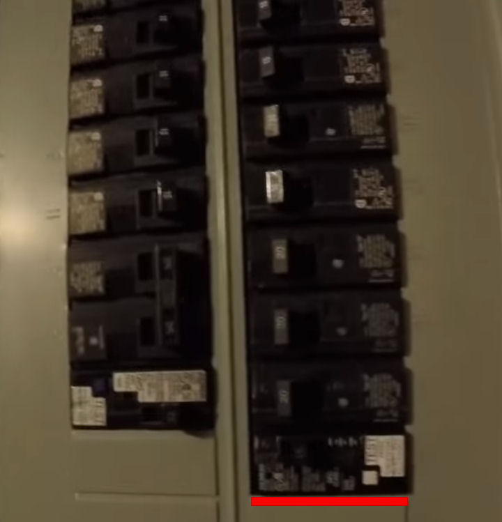

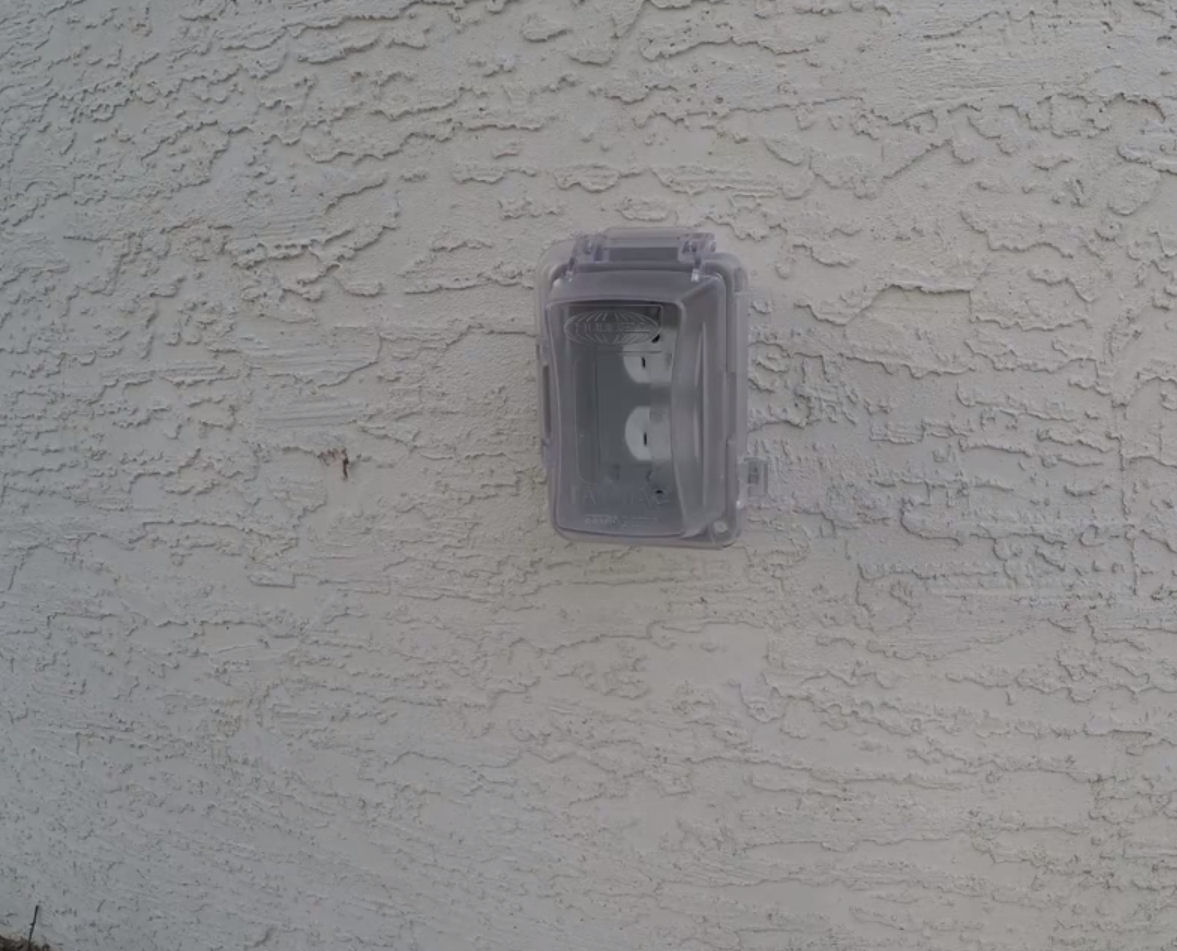

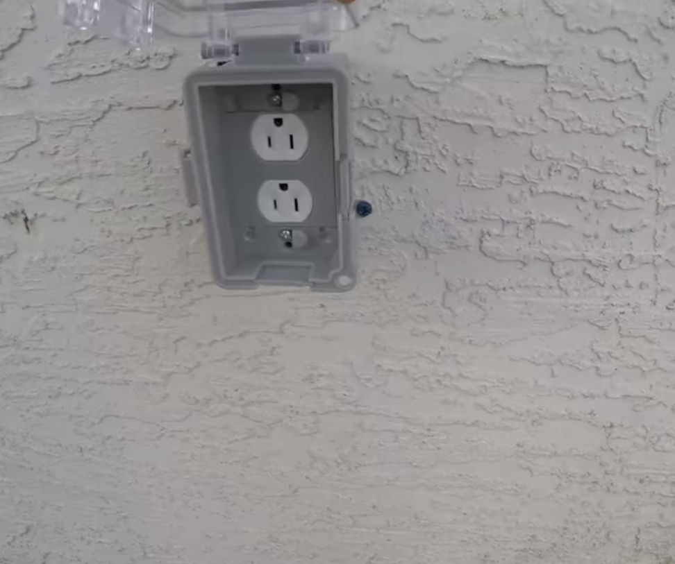

Well I guess I would need more info about outside plugs I have a few of them in and around my home property and Cabin. All wired by law and pass NEC standards. Even in the Dry location I have them setup with outdoor setup. Sometimes I have to go and close the cover if my Kids forget to when they are done... Plus when I would put up Christmas lights I have some on my Front and back porch that are tied into my Lights so I can turn them on and off with the lights...
I would NEVER leave a HOLE drilled from in to out open without some Fire Block sealer.... Fire Needs Oxygen and leaving that open will not only help with a fire but would also raise your Heating and Cooling if you live in an area like I do anyway...
For a Outdoor box that will work well with Amcrest Power blocks is a Taymac outdoor box with cover. Also it might be a pain in the backside but I would get a Box GFI rather then the ones that are outdoors. Sure you have to go inside to turn it back on if it trips but they last longer then the Outlet ones... There are codes like no more then 6 1/2' off the ground and easy access however they do sale outlet box covers that has lock or some that have security screw.. What is important is that it is water tight...
Oh and just look at the code and while I haven't looked in a while.. I see it now says for new houses or rebuilds that 2 outdoor outlets are required one by the front door and one my the back.. Also says best to have 2 each one on each side of the door. That is because they don't want you to have a cord going in front of the doors...
I will put some pictures for the outlet and breaker. The Breaker is the one with the red line under it you can see a Test button for testing the GFI I used to do it monthly I don't do it much this days lol...
