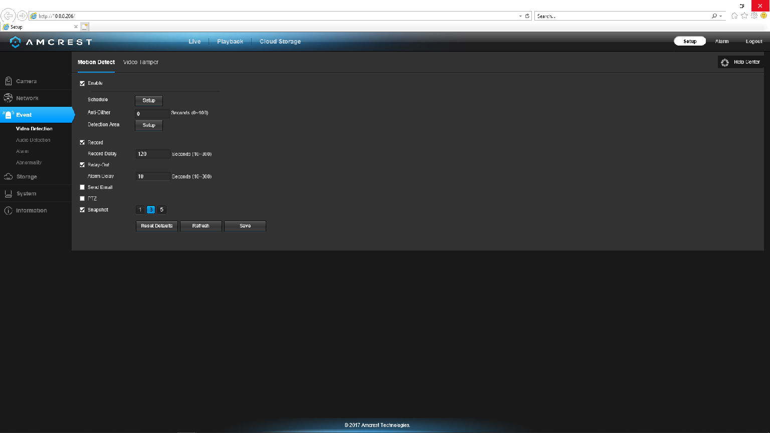

@jack7 Thanks for the help.. I see making sure the packet size would matter even with making adjustments without it set higher then your delay it would still only record 1 min. I just going by what I have done for mine.. While I set most of my Cameras that I put a MSD card for max 10 min pack size I have an 841E on my Stairs with a 32gb card and packet 10min and had the anti-dither set to normal and the Record delay. I was getting 30 second or less recording time because of how I setup my Grid. Packet size didn't matter. SO I wanted to record 2 min each time motion was detected there again my max is set for 10 came out of the box if I remember right at 8... Most people don't bother with that setting in General...
So I turned off the Anti-Dither (0) and turned up the Record Delay to 120 now with the Grid the way I want it and the delay 120 my recording has all action on the stairs from the start to end of someone going up or down do to delay in recording and the Pre record settings.. The main issue for my setup was someone going down the stairs if they paused to talk at the bottom it was out of the Grid so that would not get captured plus I have even though it is ok by code I have a stair that is thin on the inside and if someone was to fall it wouldn't be captured without making my adjustments..
Screenshot (1635).jpg (81.27 KiB) Viewed 5144 times
