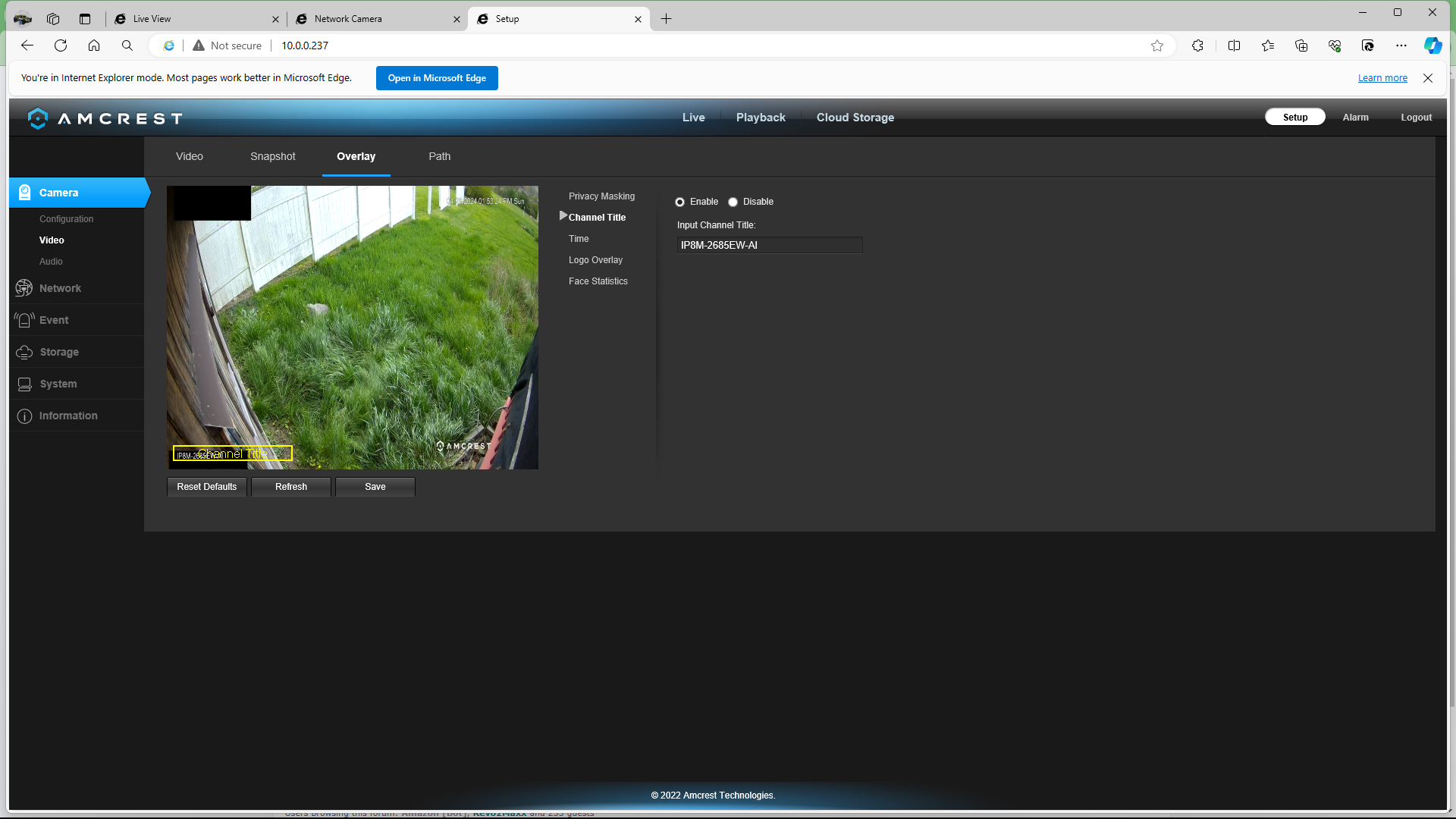

Re: How to Change Camera Name
Some cameras might have it called OSD others Overlay. Either way the area would be WebUI, Setup/Configuration Camera, Video. Then in the top of the screen for the camera would be some Tabs in there *my case Overlay* then Title... See picture below.
Screenshot (1895).png (555.73 KiB) Viewed 3749 times

Thank you, @Revo2Maxx. I don't believe I would have found it without your direction.
Greg
