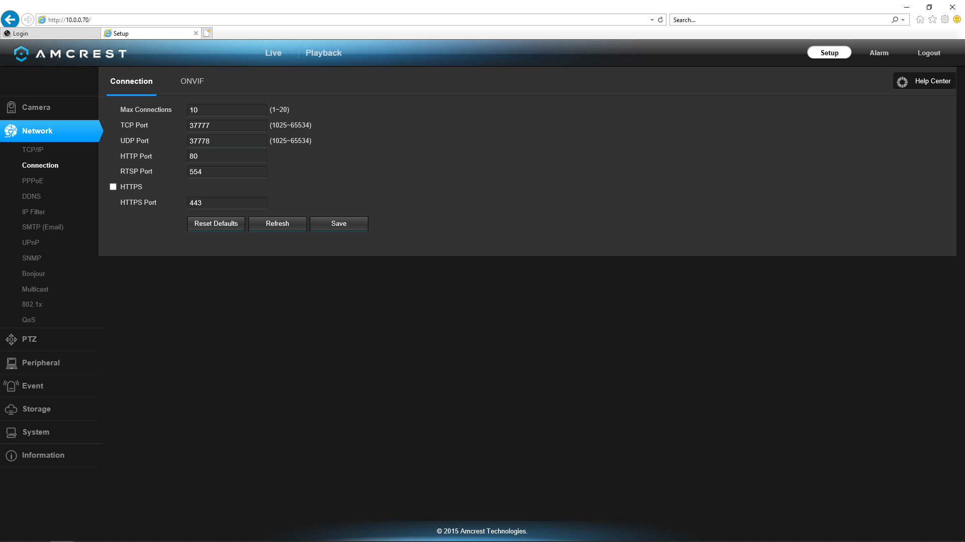

ASP will keep the system view logged in. I mean I understand what you mean about having it online full time. With WebUI yes the system needs to be logged in all the time. However with ASP you log in and turn on the view you want and it stays there on the monitor. Just trying to keep things easy without having to spend extra on NVR's However yes I would say that if you keep your cameras connection count on 10 I would keep the amount of NVR's connected at 6 so there is the ability for people to access the camera from the NVR's without getting a message about to many accounts connected. However if you need more stations then as you will see in the picture below you might be able to change the 10 to 20 to help with how many connections you need. Just remember if you have access to the cameras from outside on AVP you will want to take into account on all connections. So if you needed 14 stations and you changed your system to 20. That would leave 6 other connections. So I know it should be rare for all stations to need to be looked at outside all the same time. Just wanted to put it out there that any number over your NVR's number can close up fast. It has happen to me a few times on my own systems.

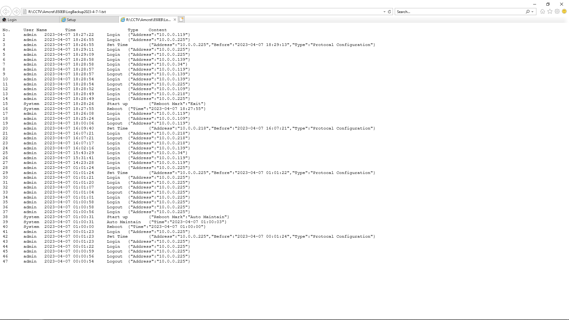

For ASP I personally would prefer WebUI, So here is a log of today from 3 different computers running ASP and 2 NVR's the first main NVR for this camera and then I just added in the seconds at 218. IT shows that it logged in and out then in that is because when it is added first time the way I added it, The cameras loads as admin admin and so it logs out after updating the right password it shows that it logged back in. The system here is showing 225 last logged in after the system reset, then the camera reset at 1ish am then today about little bit again I started to turn on my ASP on some machines. All of them are viewing the Live View and I have 2 NVR's and the 1 WebUI that this backup of the logs was from.. So right now in total the camera is connected to 2 NVR's and 3 ASP, One is older version and one is Dahua SmartPSS and then one on this computer is the newer Amcrest one and this computer is where the WebUI is open from as well. Camera is working as expected and no lag or delays that I can see besides one of the computers that is showing 100% CPU right now because it is running a update
So that is really why I personally like a NVR over ASP if there is cameras that need a NVR. Because when systems update the ASP can have some issues. However When NVR are in system already then for monitoring I say ASP is the way to go..
However if you didn't already have a NVR and wanted to ASP for your recording or Blue Iris, I would say get a NVR because they are designed for 24/7 recording and use for Security Cameras..
So I am clear on what is being seen here these are all online all at the same time. I tried to log out the camera view and bring it up again so they would all show the same log in time however it didn't work that way. However they are all online
My main computer, 119, ASP139, ASP34, ASP119, NVR218 and NVR225.

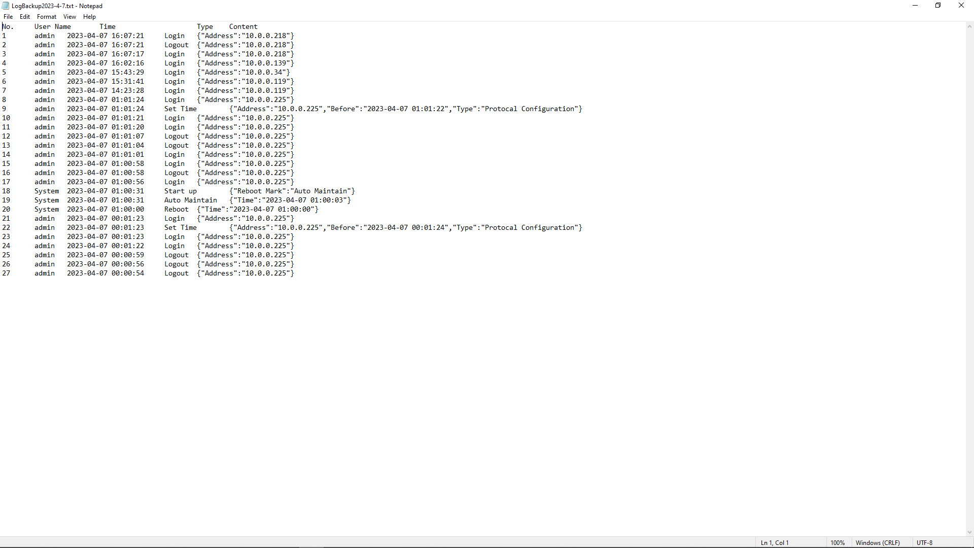

So I now have 4 ASP online, 2 are the new version, 1 is the older and then I have the Dahua Smart PSS as well. Then also as before logged into using my main computer on WebUI. I am not sure why the 1 is showing a older time then other. However what I did was had them all online the camera, I then Reboot the camera and that logs into them all once the camera comes up. When I did a search the first time the second NVR wasn't showing it logged back in even though it was the first one to come online so I moved the time from 27 min after to 30 and that was when 1 and 2 show up and again not sure why it is showing log in before others in the time line but that is how it loaded.. 6 devices and my log in with WebUI for 7 in total and with it setup on 10 connections it is working well without an issue that I can notice anyway. I am able to move the camera PTZ seeing it is my 850EB camera. There is no lag in any of the feeds outside what is normally there when I am only looking at 1 NVR.
Edit: about resources on NVR yes it would take up some of the devices resources as you connect them to different systems. So maybe best doing them at camera level if your cameras are connected to your normal network range. However if the cameras are on your NVR's POE port and wanted a cameras fed from there then that is how it would have to be connected. Once you setup your ASP for cameras you want monitored there at that station you can make a view and each time the user logs in they could load that view rather then having to load them back in 1 at a time. So it is a Flexable way to monitor at different areas for difference views. Either way using ASP or NVR it would take up same Resources to stream to the station.
