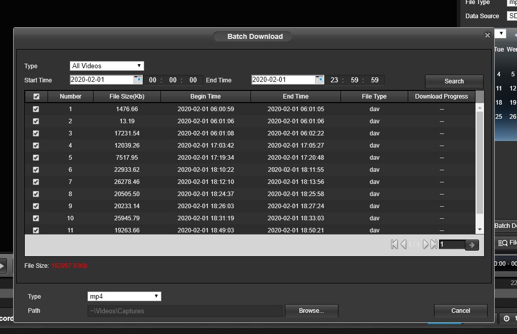

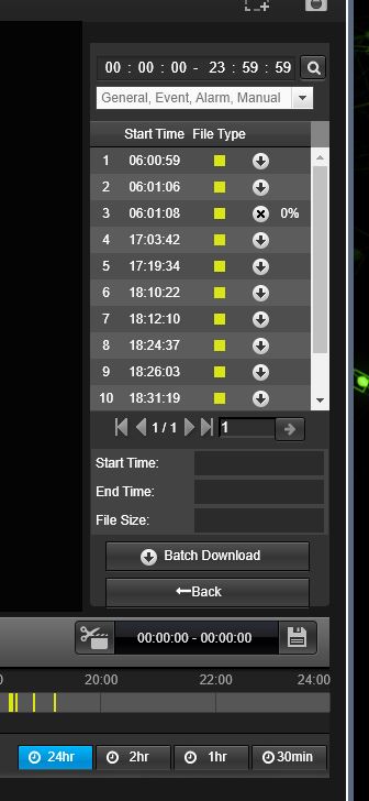

fsunaval
Posts: 2
Joined: Sat Feb 23, 2019 9:49 pm
Re: How do I download video clips from camera?
Post by fsunaval »
Same here.
I also have the Amcrest 4K camera with the latest firmware (V2.622 Build Date: 2019-10-24).
Single file sometimes downloads as Type: mp4.
However the file itself does not play in Windows Media Player, VLC or Amcrest's own Smart Play.
Batch file download simply hangs forever.
See attachments.
batch.jpg - Showing batch download just hanging. This snippet taken after 15 minutes.
singleFileHangs - Single file download stuck at 0%. This snippet taken 5 minutes after starting download.
Will be happy to work with customer support to fix this.
