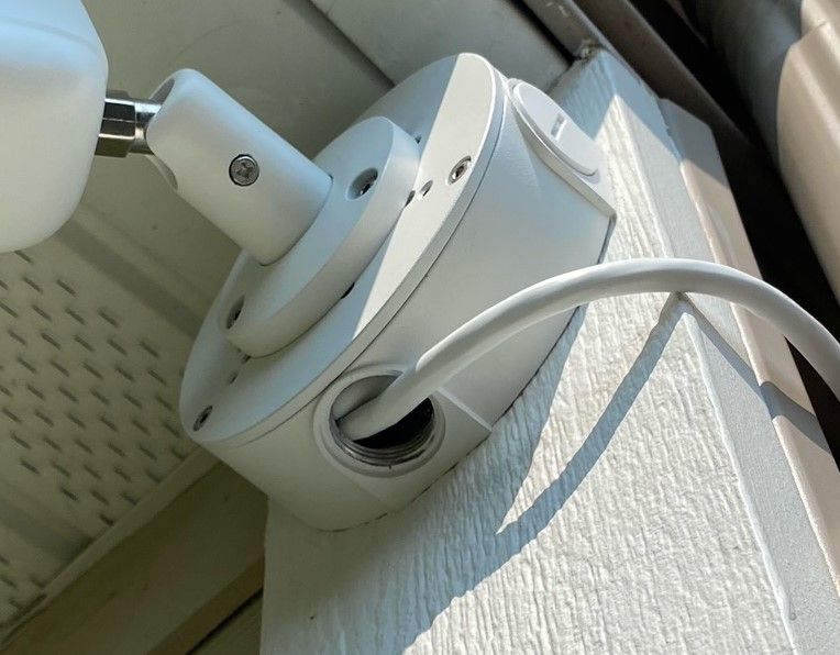

Hi,
How are folks sealing the camera cable entry locations on the mounts.
See hole in attached picture where the ethernet is going...
Thanks!

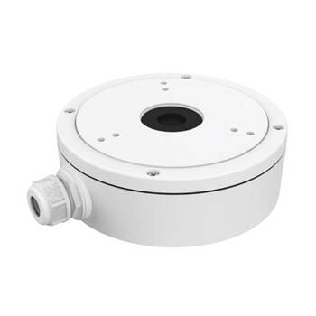

Not sure where you bought your Back box from. My guess is that you will have to buy the parts that are missing and maybe I understand better why the ones I buy are little on the Costly side.. All the of the boxes I buy have come with these that are on this picture even my PTZ Back boxes come with them for Large and Small.
It might be that the Knock outs in yours is designed for going from 1 box to the next with Conduit between..
Re: How are people sealing the camera mounts?
while these are black I am sure there are others that have them in white this was just in a fast search of what I found maybe that will help
Edit: Also thought I should add there are a lot of different sizes so you would also want to make sure you find the right size unit for your backbox. Ones I know of are like PG7 PG9 and PG11 and I think I might have a PTZ camera with a PG16 not sure it is larger then the others.

Another method would be to screw back in the round plug that you removed from your box.  Then route your POE cable through the camera mount side slot and back into your box.  Put a little silicon sealant around slot/cable entry point.
Cable going through slot in camera mount side is shown below.
