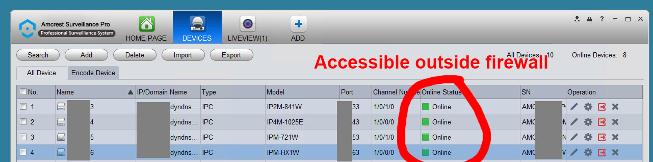

1. Accessing via Web works.

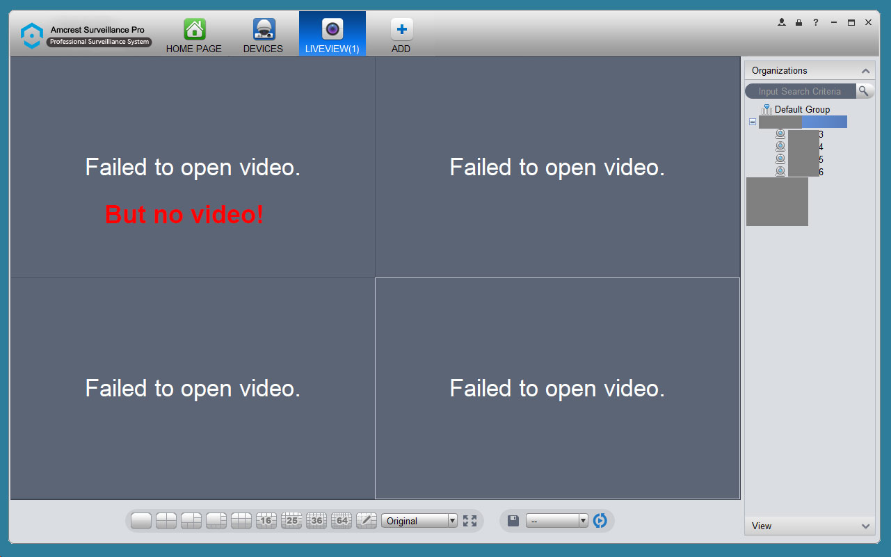

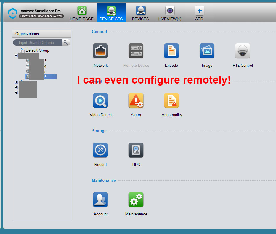

2. Accessing via Port 18708 allows me to change the settings of the camera, but not view the video! For any of my 4 cameras! ARRGHGHGHGH! :oops:
Any idea what changed in the firmware that broke my set up?
