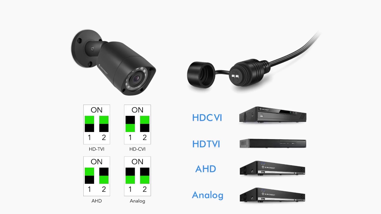

Camera works during the day without problem, but does not provide any night vision. Could this be a bad wire that needs to be changed or possibly a bad port on the DVR? Will try to do further testing tonight.

Re: HD CVI Camera Problem no night vision amc1080bc36-w
Post by Salty124 »
mine does too but it was in cvi mode. My cameras have a mode setting in a little round cap on the camera. When I changed mine it worked
