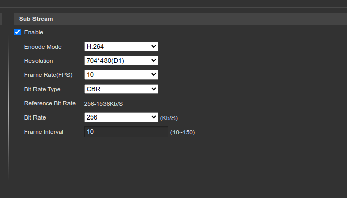

I am trying to get my camera to display on my website, but it must be H.264 and not RTSP.
As you can see from the screenshot, my substream is set to encode at H.264.
I think there might be a problem with the URL endpoint for streaming the H.264 content (one major problem being that rtsp://) But, I'm not finding any documentation on what the URL should be if its H.264

- Screenshot from 2022-10-27 07-30-26.png (21.18 KiB) Viewed 1600 times

Camera should send RTSP video stream using whatever Encode Mode is specified in Camera Video Settings.

RTSP is the protocol and H.264 is the encoding format of the data stream. The latter is sent using the former. They both work together and there's no such thing as the H.264 URL string.
