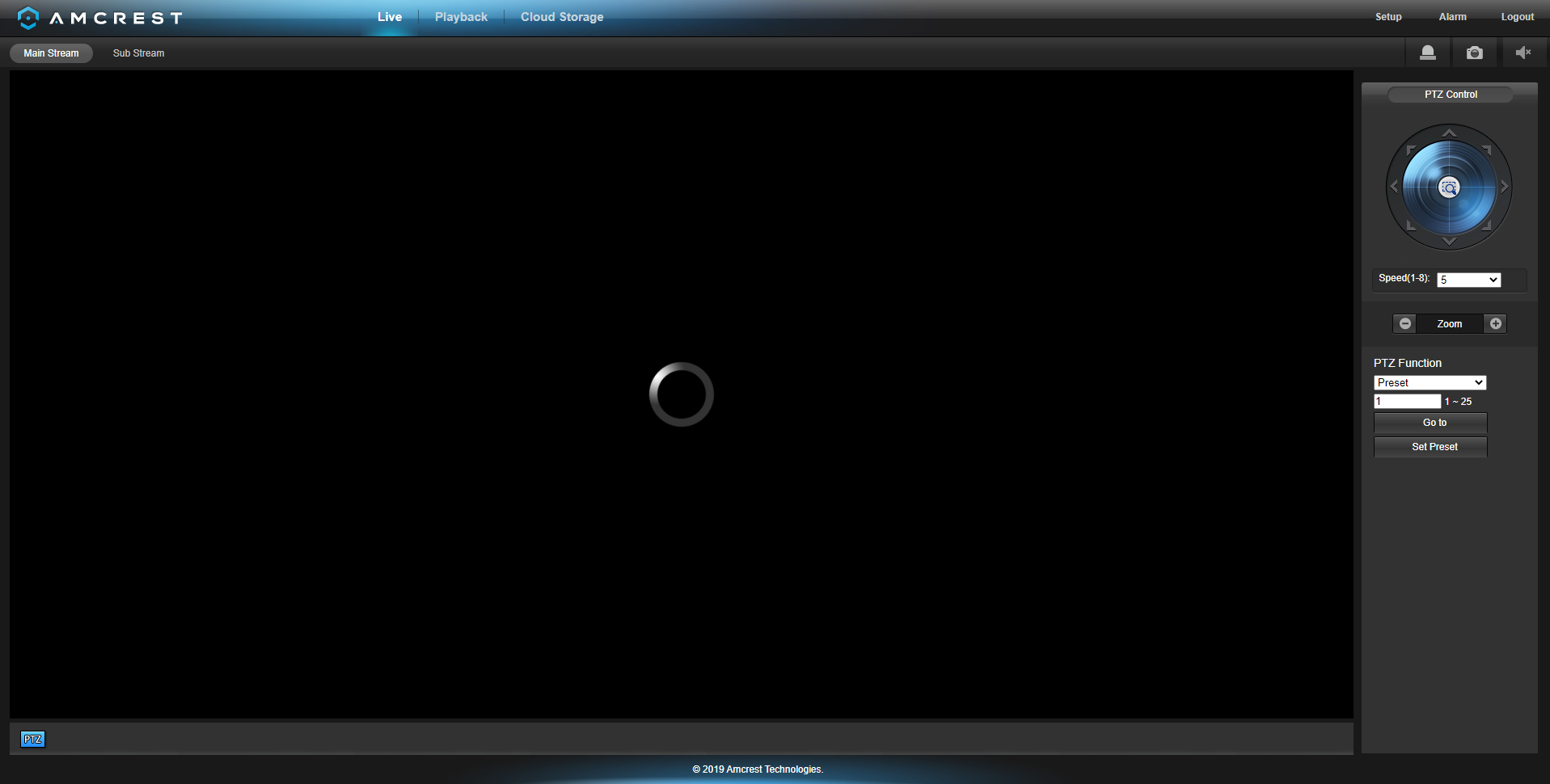

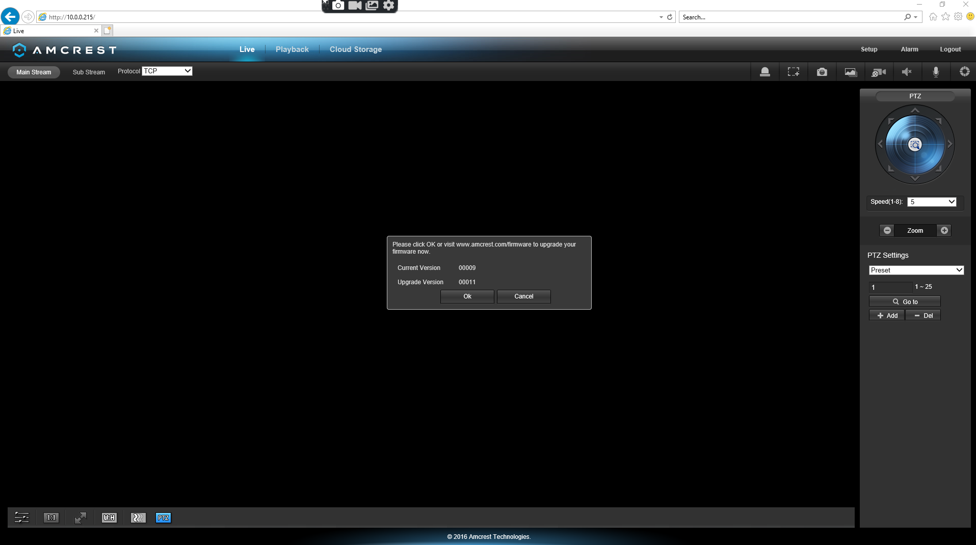

So here is 2 Pictures one that will show the 2019 FW and one that is showing one of my cameras that has 009 version of FW and offering the one yours has because it is the last non JS stable version and when Network setup right and push button to look for new FW as long as you don't have the 011 installed like yours it will offer that one.. Update to JS fw has to be done by the End User. https://amcrest.com/firmwaredownloads
2.420 predates the 2.520 so this picture the camera has 009 FW that is dated in 2016 and is 2.420 being offered the 011 and that one is the 2.520 version made in 2017.. This is one showing the difference in page layout over the older FW and some things that was removed it don't matter the image has not loaded this is how it looks even after view loads.. Both snap shots taking today
