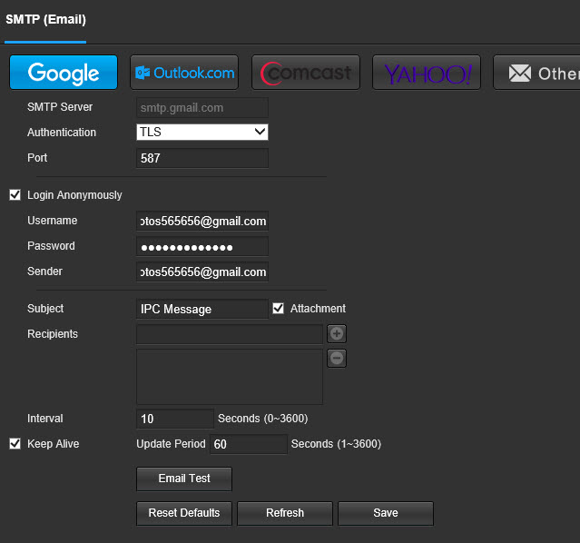

Hey Everyone ! I have the Amcrest ProHD Outdoor 3 Megapixel Wi-Fi Vandal Dome IP Security Camera - IP67 Weatherproof, IK10 Vandal-Proof, 3MP (2048 TVL), IP3M-956B ... So far it's kind of been one problem after another... The latest problem is that I can not for the life of me get the email notifications to work. PLEASE HELP BEFORE I TARE MY HAIR OUT!!!! Customer service has NOT been helpful.
I have done the following:
- It Is a Gmail account.
- Setting are 100% Correct ( see attachment ).
- I am 100% Sure my password is correct.
- I have turned off " second Verification"
- Turned the Less Secure option thingy on in gmail.
- Tried both types of ports.
Does anyone else have any solutions? PLEASE !!!!!!!!!!!!
Thank you for your time!
Becky
Failed Email Test ... I TRIED EVERYTHING! * PLEASE HELP! *
- gmai.jpg (47.78 KiB) Viewed 24104 times

Hello rebepa3,
Is the mail test failing? Please change the port number to 465 and see if that works. Also note that you should add atleast one email address to the recipient field. Try again to see if it works. The less secure app option in Gmail should be set to 'On".

Re: Failed Email Test ... I TRIED EVERYTHING! * PLEASE HELP! *
I have the same camera as well as a few other Amcrest models and I cannot get email to work any of them. FRUSTRATING!!! I too am using gmail and have tried all the same troubleshooting steps and config options as the original poster has tried, including making sure there is no two-factor auth and the less secure apps setting is on.
I have also tried Outlook and Cox email accounts therefore I believe it is safe to assume I have ZERO problem with the Amcrest SMTP email set up itself as I am 100% all the email accounts I have tried work properly and I have entered the correct name/password info. I have tried SSL/465 as well as TLS/587.
It may be worth noting that as soon as I click "Email Test", I receive "Email Test Failed" ... absolutely ZERO delay. I am wondering if there is some sort of port forwarding or other config I need to perform against my router?
Any help will be greatly appreciated. The cameras are worthless as a security force if they cant talk to me via email. Everything was so straightforward and easy to set-up on all four cameras until I got to the email setup.
Hello pbearcc61,
For Gmail, please try port 465 and encryption as SSL. This works fine in most cases. It is also possible that some firewall is blocking outbound traffic from the camera.
Please give us a call on 1-888-212-7538 if possible so that we can take a deeper look.
