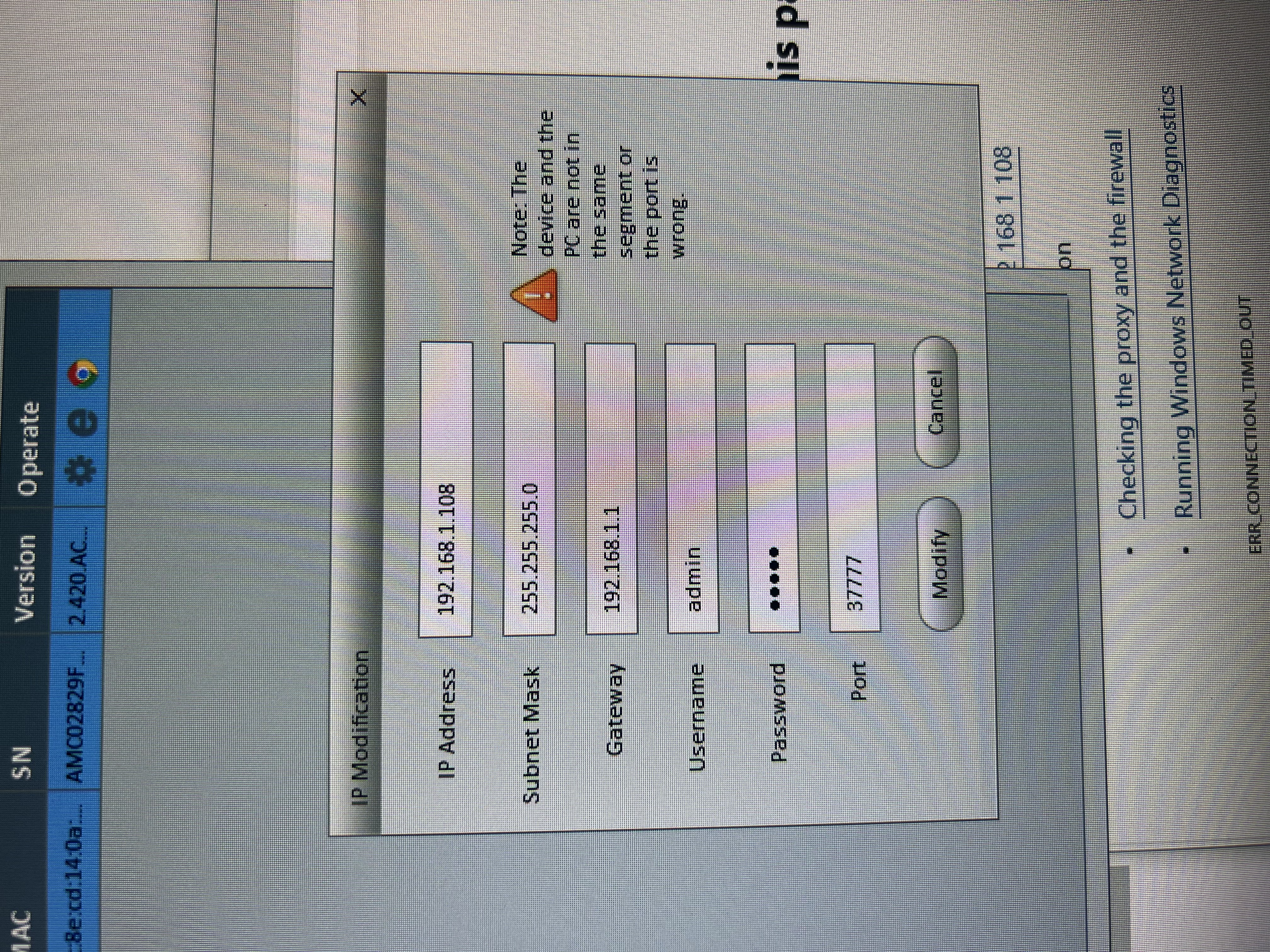

MI did another factory reset, I now have an IP if 192.168.1.108. It appears the password is now admin.
In the config tool if I click on the camera I get a IP Modification screen. It has all the info regarding its network stuff but it has a warning that says “the devise and the PC are not in the same segment or the port is wrong”
Not sure what to do with that info.
- IMG_3208.jpeg (7.17 MiB) Viewed 5642 times

What is the model of camera? Maybe a NVR only camera?. Not heard of Amcrest having such camera but could be the case.
Re: Fail to connect
Ok your post was same time as mine. Press Windows key and r at the same time. Then type cmd the command prompt will come up type ipfonfig and please confirm that your computer is in the 192.168.1.xxx range if it is something else that is why the computer and camera are not talking.. Again like I said before normally the camera would load on NVR Switch at 10.1.1.xx So doing what you did there almost seems like you are able to work with the camera and it isn't dead..
Then type arp -a and see if the Mac address shows up in the Router Pool table.. It would start with 9c:8e:cd
Edit: The Firmware starting looks like you are working with a 841EB maybe or something from that era...
