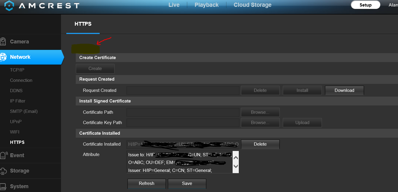

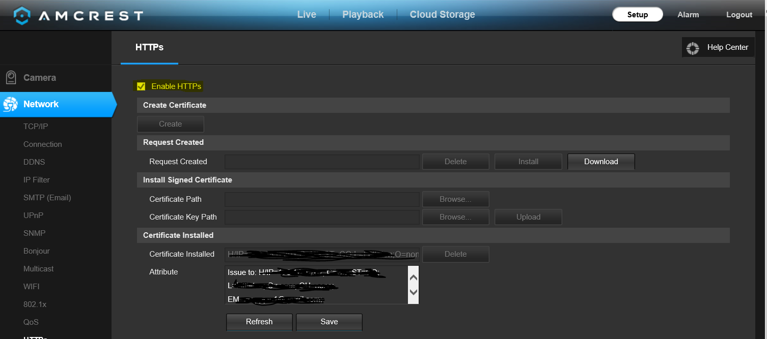

I have updated 2 IP2M-841B to the new firmware and found that it does work for email but broke logging in with HTTPS. The Enable button is missing from Network/HTTPS and connection is refused every time. Screen Shots attached
I also have other models but do not want to update for fear of not being able to login via HTTPS as this is a huge security issue for us. Please advise or comment.
Amcrest before FW update.PNG (119.37 KiB) Viewed 1631 times
Amcrest after FW update missing Enable HTTPS.PNG (101.53 KiB) Viewed 1631 times

No comment on the HTTPS not working?

preppym1 wrote: ↑Thu Aug 15, 2019 12:29 pm No comment on the HTTPS not working?
I think the techies are so tied up on the phone dealing with new firmware issues to pay much attention to the forum lately. Too bad, because their comments are usually pretty helpful.
