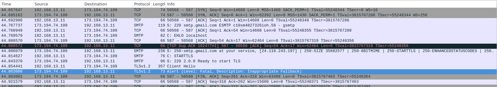

This is what appears to be going on. Attachment #1 is a packet capture of an attempted connection between the camera and one of the many GMail servers. Notice the line highlighted in dark blue: Alert (Level: Fatal, Description: Inappropriate Fallback).

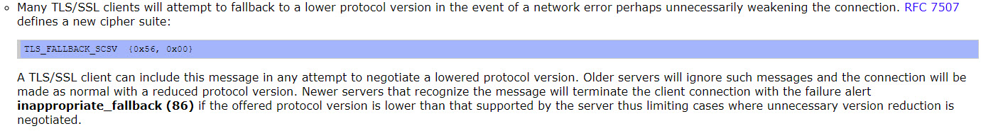

The explanation in Attachment #2 provides background on this fatal alert.

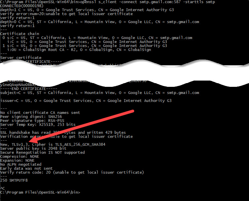

Attachment #3 shows (truncated) output from the openssl s_client command when making a connection to a GMail server. Notice that GMail is using TLSv1.3.
I suspect that Amcrest needs to upgrade the client (camera) to support TLS V1.3... and not offer any fallback to lower TLS versions when connecting with GMail servers.
