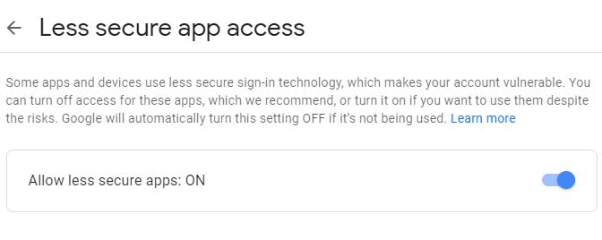

Not sure if you tried this already, but I had the same issue with my gmail 3-4 months ago, where all my cams stopped emailing. I eventually solved it by allowing less secure apps (and making no changes to my cameras' email settings).
This link should take you straight there if your browser is signed in: https://myaccount.google.com/u/1/lessse ... ageId=none
- google_less_secure_apps.jpg (30.21 KiB) Viewed 13777 times
