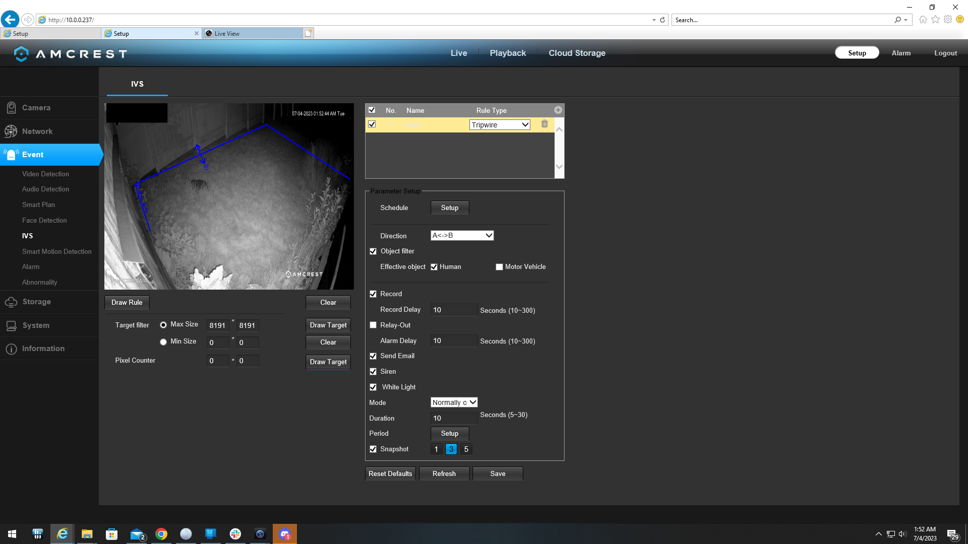

So not sure what camera you are working with so I show Motion and IVS setup for Email alerts.. This will give you a general Idea of what you are looking for to get emails once you setup the Email server in the Network area...
Also keep in mind that Push Notices is setup and works better then Email, You don't have to worry about storage of pictures on your email servers. Now keep in mind that if you setup push for a video or images them are stored on your Cameras Micro SD card and same for email. If you don't have a card installed how will it take and send you an email with images unless it has something to store them on. Also keep in mind that might also work and key word is might also work with your footage going to FTP. I mean you don't need Micro SD to send to FTP just that it might send email or images in push or email if you have FTP setup for storage.. I have some that do and some that don't..
This is IVS and on my Tripwire rule,

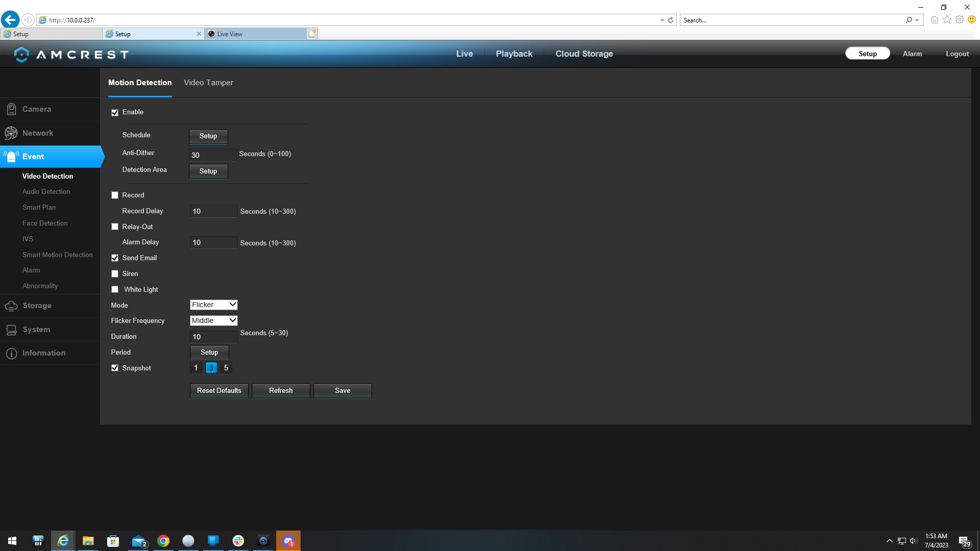

This is for Motion detection and will happen even though i have it setup for no recording it will send an email and 3 images.
