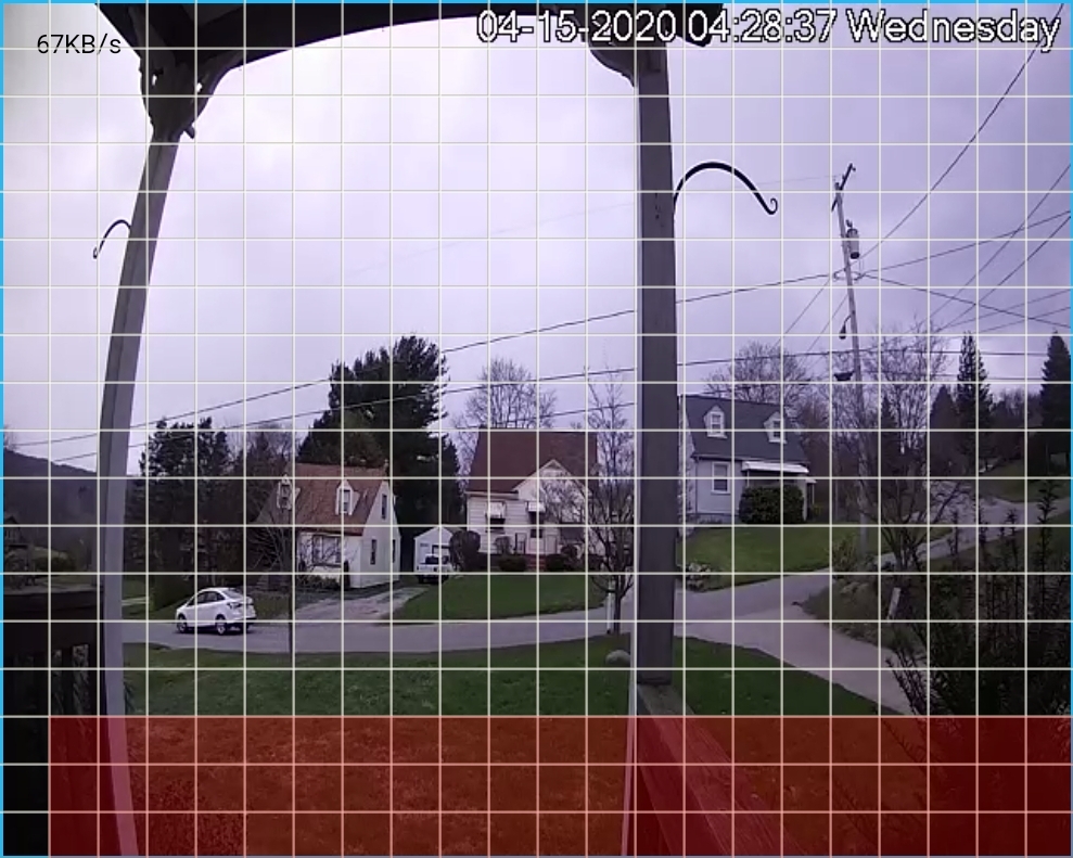

Aww Ok... Hummm interesting... I have my 4108 connected to my AD110 just don't make changes and I record there full time... While I do have motion set I am not sure why I don't get Motion alerts on there anymore lol... I do have mine set 1 bar and was getting loads of motion alerts but as of last couple of weeks only button press alerts and that is fine... I have other things in full sight of the front door on Motion PIR and I can use the 4108 footage for all my door needs...
Maybe no bar set and enabled is like all checked I am not sure that is strange that you have things going off with no grid marked out...
Edit I did only have 1 but I see changed to 3 still get little alerts if any
SmartSelect_20200415-162843_Amcrest Smart Home.jpg (451.23 KiB) Viewed 3211 times
