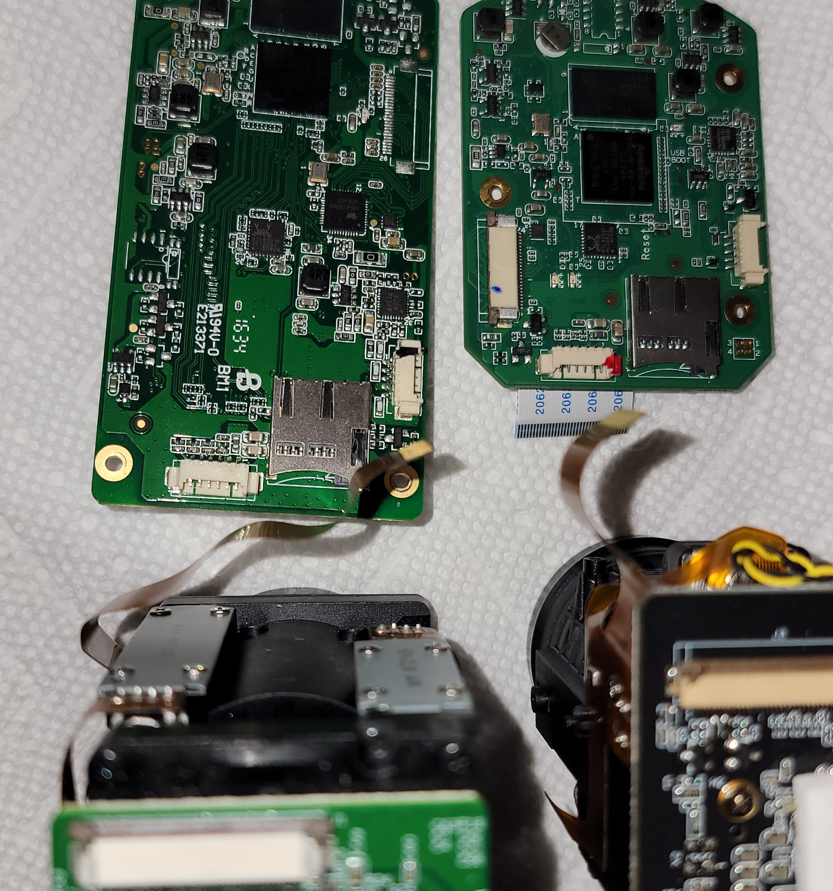

It might be in early stage failure of the camera Realtek network adapter or might have been a building error maybe. Never seen how they are made but my guess is that the main part of pick and place and auto soldering of the part in question with many others. The pads might have bridged to another pad and might be making it not work right. I am guessing part is a BGA part and not easy to notice bridged pads
Re: DHCP not Working IP8M-2498EW-V2
Sorry said BGA however I am guessing they are QFP rather. Took a 12x and 20x ip camera apart and both, one from 2017 other from 2018 are both QFP for the Ethernet chips both are Amcrest cameras so my guess yours will have QFP and with that much easier to see bridges so no telling what the issue is. Bigger board is older 20x camera chip center of board the other is little chip next to CPU closer to micro SD slot
