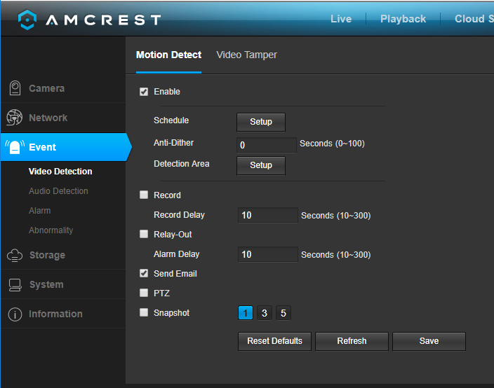

Updating on this if I turn on motion detection with the above screen to "send an email" WITHOUT an attachment, and WITHOUT taking a snapshot, I get the failures a good percentage of the time.
If I trigger the snapshot by placing a motion detector right next to the camera (but not using the camera) it NEVER fails.
It appears that when motion triggers via the on-camera detector (and sends an email to a target, which succeeds) an attempt to fetch a snapshot using the API within the next few seconds WILL fail a good percentage of the time even though you did NOT tell the camera to take a picture on motion detection (one or more.)

OK, so here's an update on this....
It appears if I set the dither time to "0" (so I get immediate notification, and handle delays if I desire in my application -- say, if I get a bunch of notifications in a row before I can respond to them all) I get failures. If I set the dither to "1" or any other number I do not.
Is this a bug or expected behavior (in other words, should I not be using zero -- ever?)
Re: Determining why connections fail on web CGI
Setting dither to "1" (or any other number) REDUCES but does NOT eliminate the failures....
