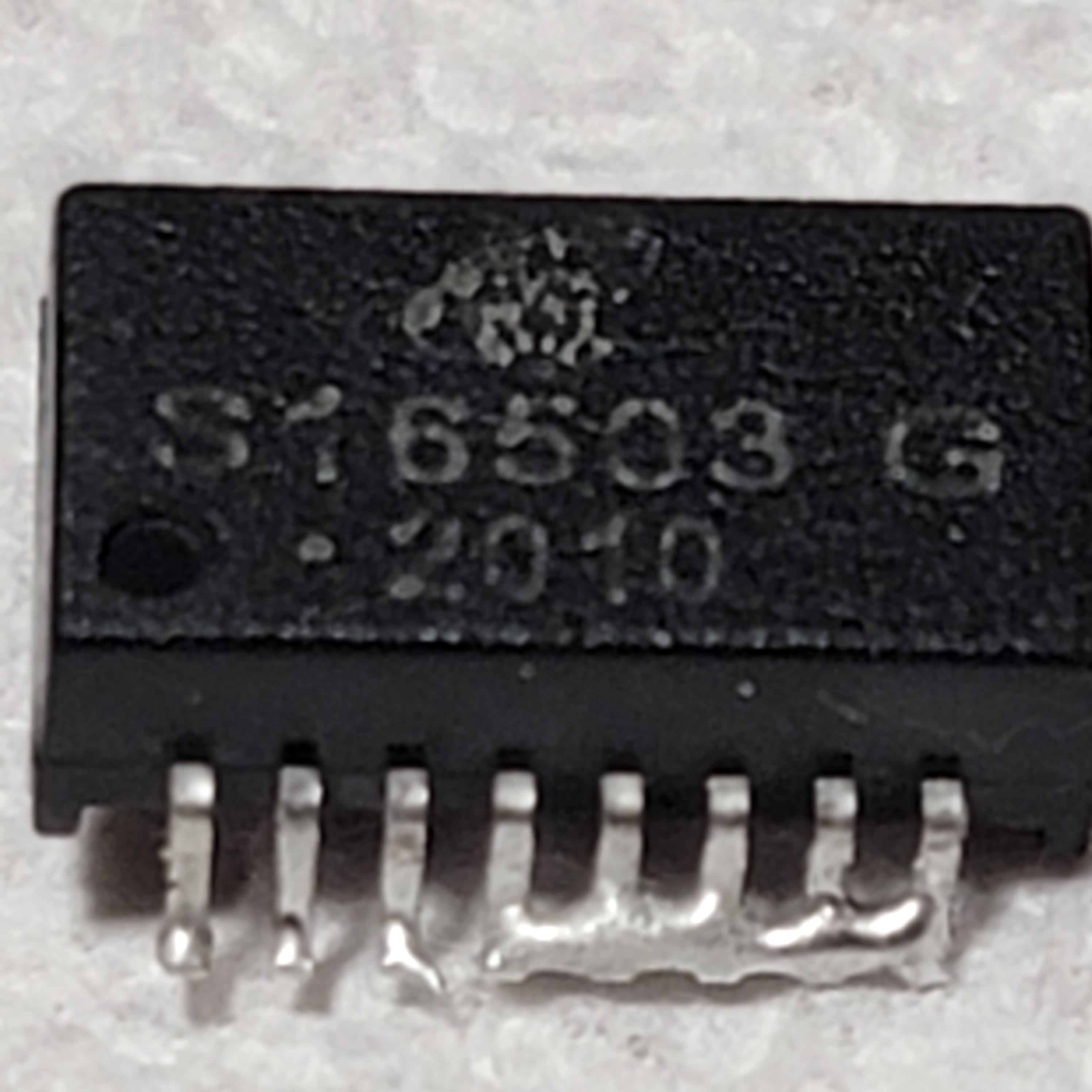

So one of the craziest issues that can happen is you turn on your IP camera and the IR works and you can't figure out why it isn't coming online. There is no network activity. While I don't want to say 100% that this will be the case and testing isn't easy really. However looking at the pictures below for the bad part.. It is the Network Transformer.
However first thing you should do before you think that the camera is bad is double check that your network cable is in good working order. This means running a new cable that you know is good to the camera and make sure there is not something wrong with your currently installed cable. This is normally the #1 issue with a IP camera that goes offline. Bad cable or cable ends.

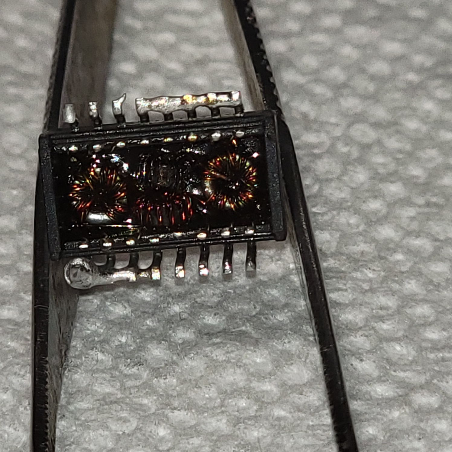

So this Transformer in the picture below was on one of my AI Dahua IP cameras from 2020. It would have still been under warranty had I bought it from a dealer that was Authorized to sell it. However it wasn't so there was no warranty. It is a color night camera with white LEDS. When I plugged in power it didn't light the LEDS in darkness because I turn them off in the location it was in. SO I did a Factory Reset and the camera showed that it had LEDS just not a working camera. So this tells me that there is a Network issue. What is funny is the Camera is also a POE camera and would power up over POE also, so again it comes down to something in the Network line. After removing this Transformer you can see there are 4 cores inside. However you can see 3 of them well the 4th one is black because the tiny wires that go around the core have burned up.

Took this one off, Installed a new one and camera came back online..
On this camera 1 thing to note. There are some Very fine (Small) traces that are under the package. So if you don't know what your doing. I wouldn't mess with the repair. Keeping your soldering iron in the area to long will burn them up and you will have more of a mess then one want to mess with because these traces go through a Via. While I didn't go probing or looking for where it goes or if it just went to a center of the PCB plane. I thought I would make it known there are some things easy to make worse then you started with...

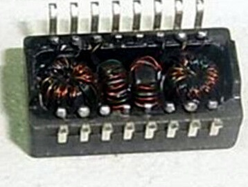

good working one
