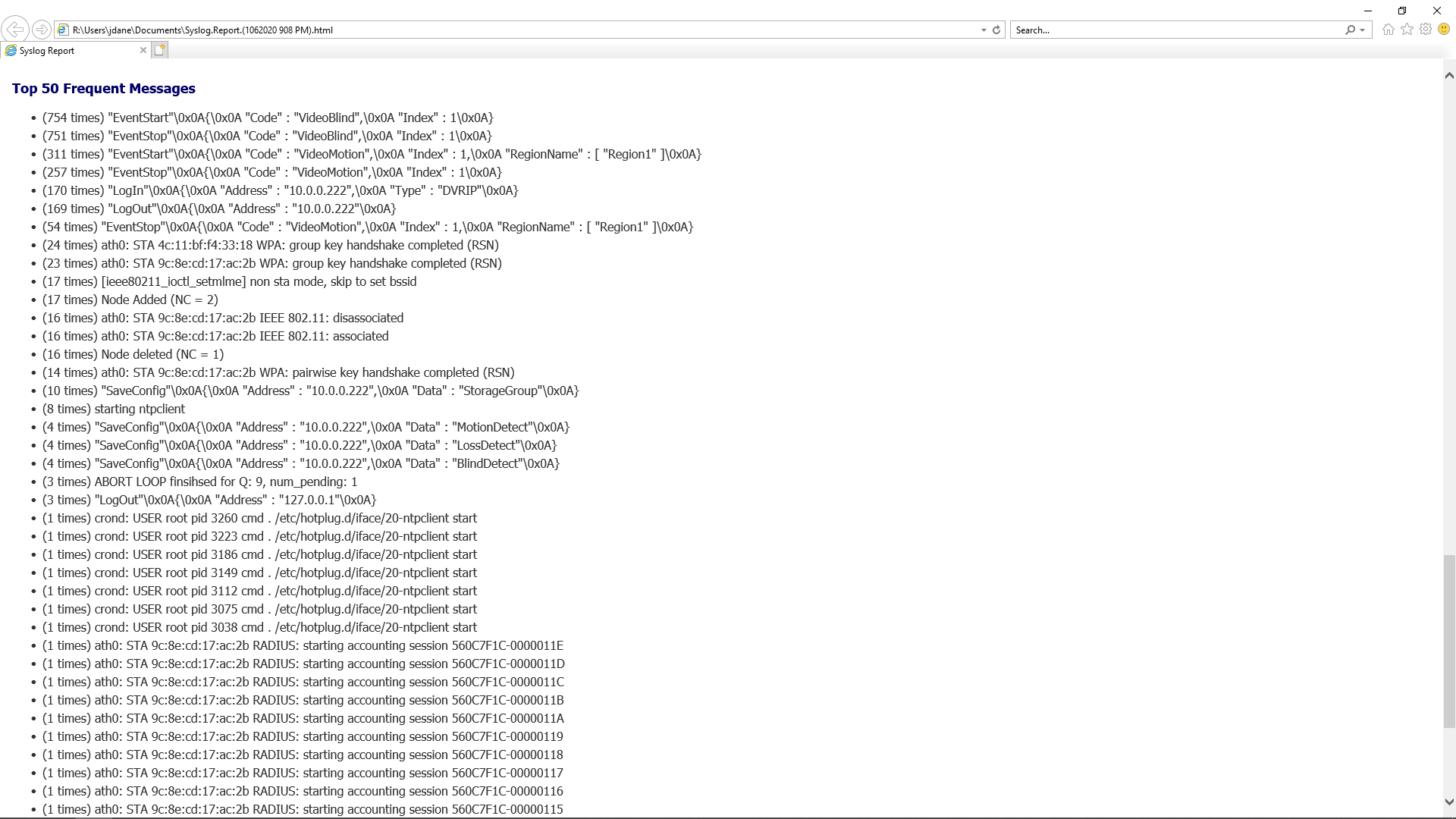

Re: Configuring "Remote Log" setting on IP3M-941B
So just wanted to show you what the Report looks like. This was one of the reasons that I liked it was above what I am going to post there is a Graphic bar and pie of devices and what has what type of logs then this area will give you an idea what type of logs are being generated and let you make a Choice on what you want or need to do to fix it. SO while I did have loads of syslogs I left the Log Motion on so you could see what happens if you leave it on for the cameras.. One of the reasons some people have 1024 logs a day is because they log every Motion event and it hasn't been snowing or loads of Humid nights or that number would have been higher.. I turn off Log Motion but after setting up and wanting to show what things could look like when someone does have it set to Log Motion Events it will and can be a large number. One because there is a Start and Stop of the event..
Been meaning to get this one on this Network because I do like the format over the others that I have used.. Easy and gives good data..
Also my NVR on 222 in the logs the HDD died so yeah I had to replace a HDD in my NVR today sad..
