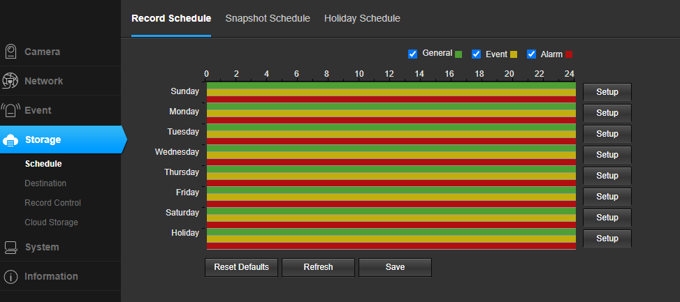

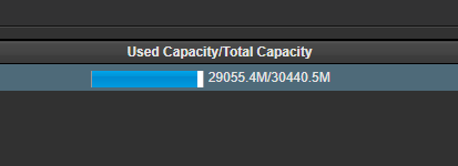

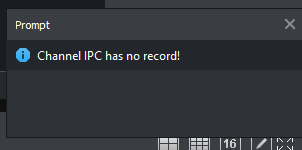

Hi all. I have an IP5M-B1186EW-28MM camera i just setup. I factory reset the camera. Installed and formatted a new 32GB MicroSD card and is set to read/write. I set the record schedule to record all the time. I see the SD card is being used and filling up with data however when i try and playback captures using surveillance pro software it says "channel IPC has no record". Also tried the browser to playback video but it doesn't show any timeline or captured video either. I'm confused. Any ideas?

So there is a lot of info there however there is a lot of info missing as well.
So here is some important things to look over, 1 double check that your doing a Search for the right type of Recorded file!? Meaning in your Pic1 there is a Record Control, Make sure in there your not setup for a Sub Record for type and if you are that your doing a Search for that type of Recording.
Also what type of Recoding did you search for? I mean lets say with the way you have your camera setup for Full time alarm and motion if your doing a search for Alarm or motion and there was none in the time you did a search for then you would have no record?
From your Camera WebUI where you have your Pic1 and Pic3 from if you playback in that format does your camera play back?
