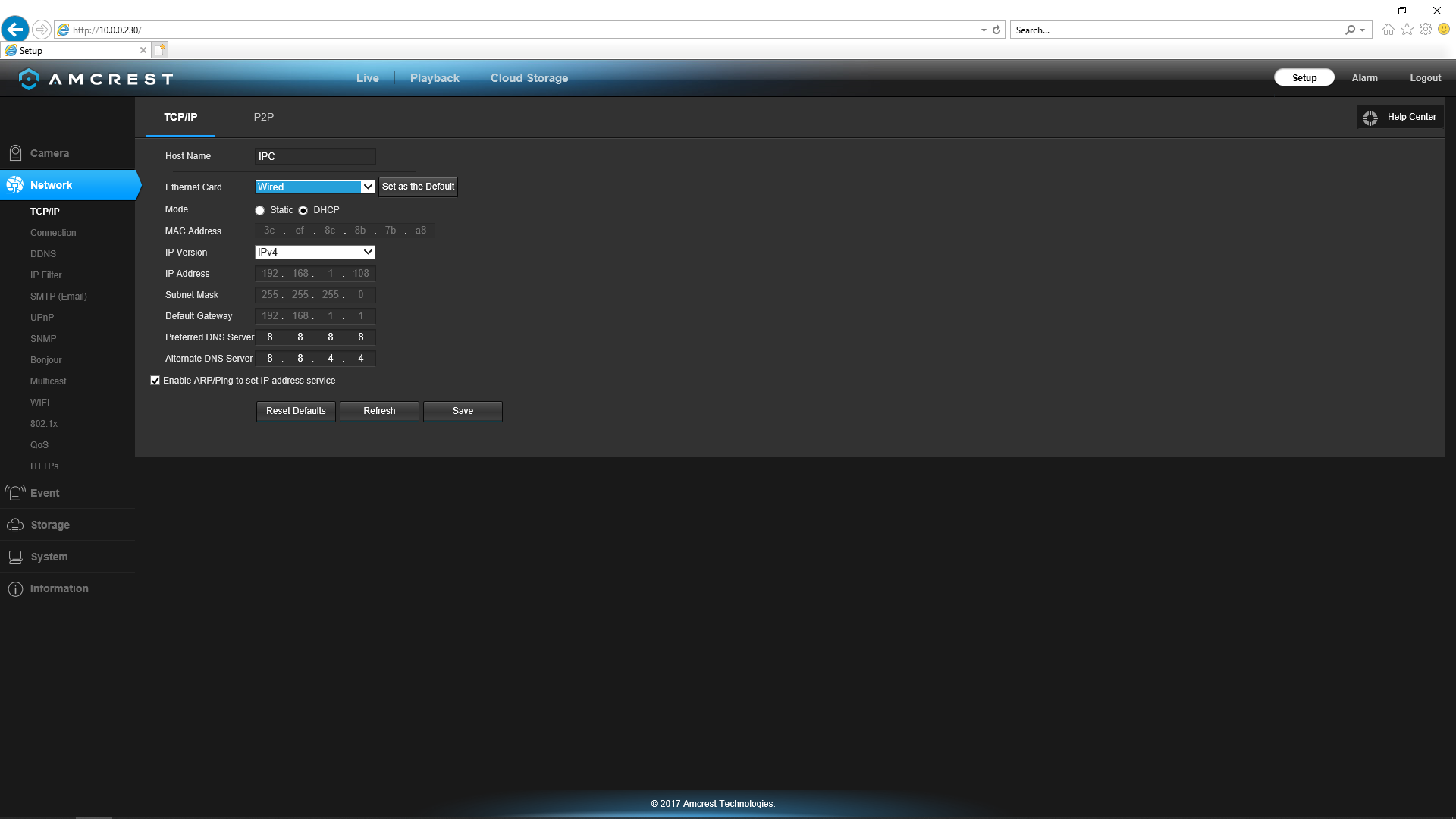

Re: changing ssid name
So I was typing when you said your last post Please post a Shot of the Wifi IP for a better understanding of your problem
Also if your going to have your camera working in Wifi I would change your Default to wifi and don't leave it on Wire

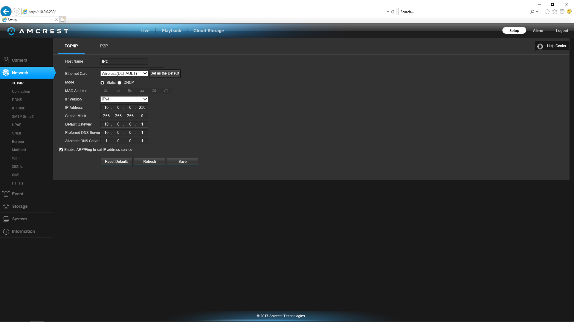

Here is what a Camera looks like that was Setup on Wifi only.. This is a 841W from 2015 and was able to setup the camera on Wifi using the Tones when setting up the camera you will notice that the Wifi setting is Default.. you can also change that from your current setting of Wire to wifi by clicking the button next to that area when on Wireless and it will setup for your Wifi to be Default connection...
Because I didn't change any settings within my Wire connection area it is still set on the setting the camera came with from factory...
You can right click Image and open in new tab to look at the images in 1080 size aka full size to see the images better if needed
Notice the 2 different ranges
Screenshot (239).png (116.36 KiB) Viewed 825 times
Screenshot (240).png (116.22 KiB) Viewed 825 times
Sorry ASP is Amcrest Surveillance Pro it is a APP that you can on your computer connect to view and even setup PC-NVR to record just keep in mind you would have to keep your computer running full time to record...
Anyway it can work the same as your Amcrest View Pro app.. I love the App my self and I use P2P.. So when you said that you can't log in your Camera WebUI but can over your phone that tells me that you connected your Cell on your camera over SN (P2P) and not using IP.. That is why you can still connect over Cell phone app
So as I said if that is the issue and your Router is on a network stack of its own you can setup that Router as a DMZ to the camera if the feature is setup in the device...
What this means is the ip address that you are connecting to the Router on if you have been anyway.. Seeing now your IP is 192.168.0.xxx if your same router is at 120. When you type that you can log into the router UI however if you were to setup as DMZ for the camera you will not have access to log into the routers UI after setting to DMZ that IP address would be a direct line to your IP camera...
