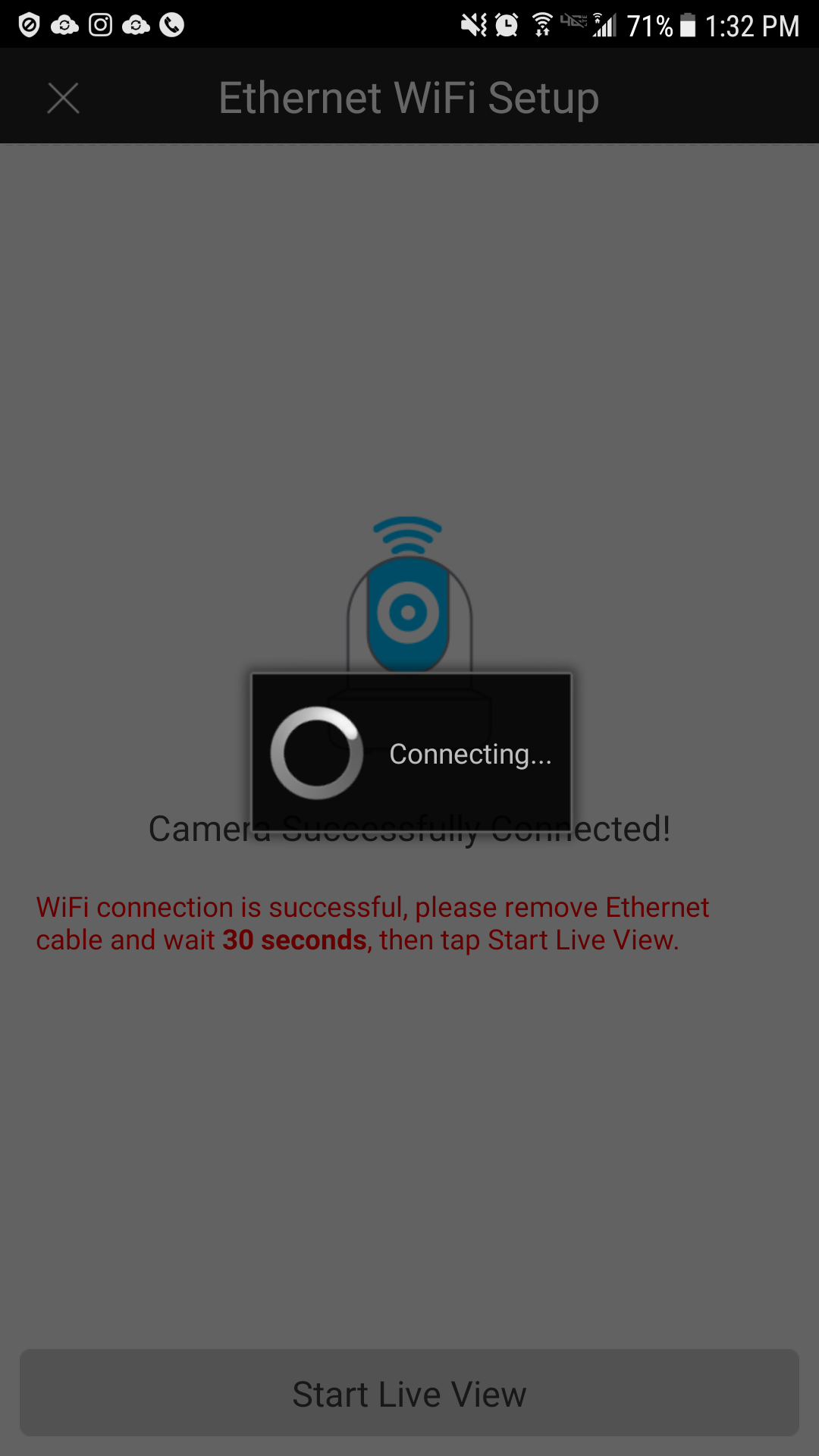

Re: Changed Router but Can't Connect Camera
It's me again. I got a little further but I'm still not connected.
Here is a little more info. My new router is a ZyXEL EMG3425-Q10A. It is the router that came with my new ISP (MetroNet). I connected via the Ethernet method. (I can never get WIFI to work.)
I connected and even got the screen that said "WIFI connection is successful. Disconnect Ethernet cable, Wait 30 seconds and tap "live view." I did as instructed. My phone buffered for a few minutes (see image) and finally said "Failed to Connect."
What now?
Solved! My MetroNet router apparently had problems. I switched back to my TP-Link and it's working fine.
What now?
