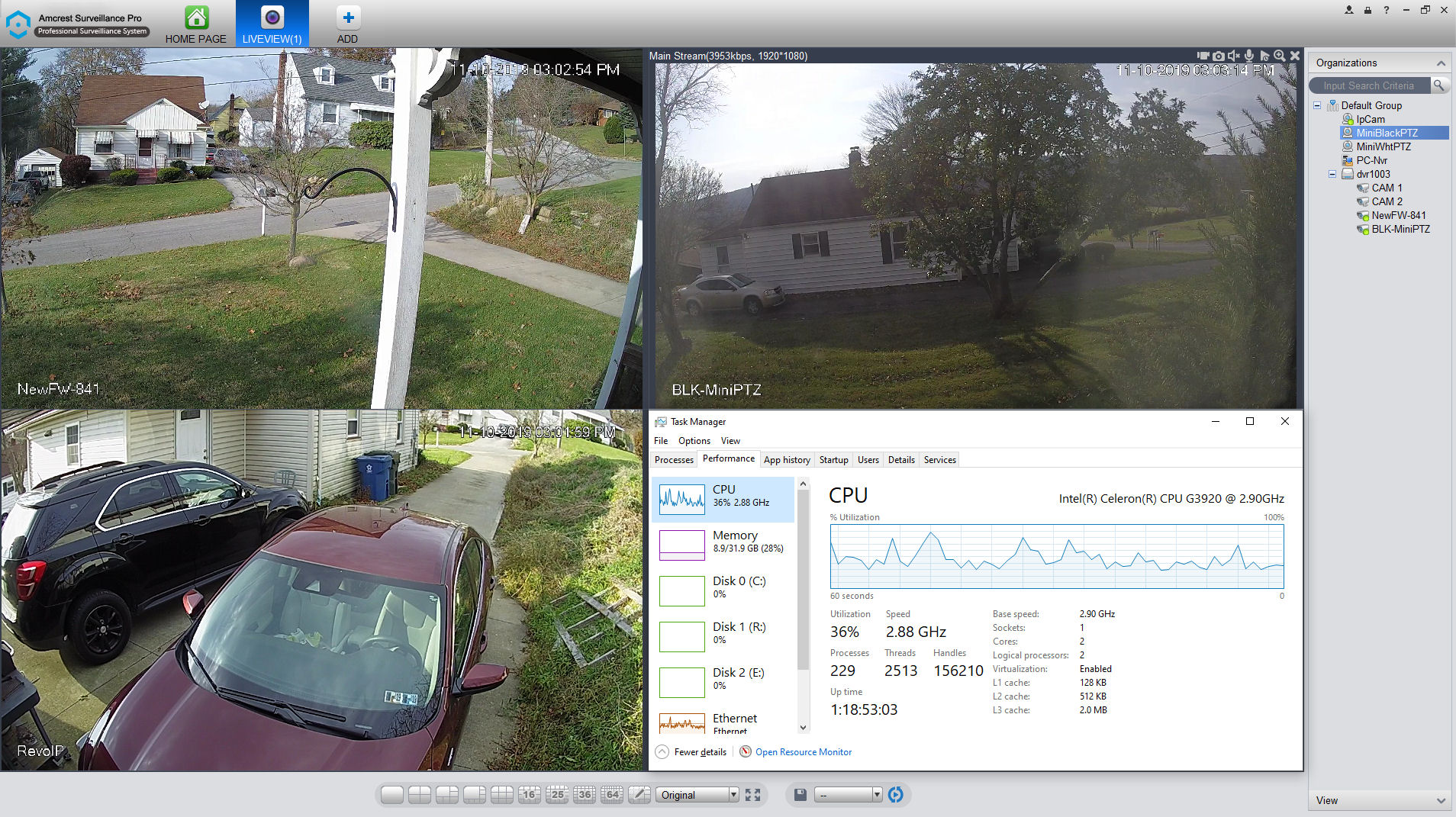

So I just took some time to Revisit this testing... I just did some now. While working today on my 2018 computer with 32gb ram. This one I can't get PC-NVR loaded and working anymore. Not working for over 2 months.. This one did not max my CPU the whole time only a couple of times. most times with 3 cameras loaded it ran at 35% to 60. I picked Playback with the 3 cameras and this was with the LIve View off. I was around 65 to 80% Ram was running at 8gb of the 32. On 10 Pro.

Just the live view I took a screen shot of one of my 2018 computers running ASP with 3 cameras and Task Manager. This is one that isn't running PC-NVR I couldn't get that one to bring up Task Manager.
Screenshot (284).jpg (516.69 KiB) Viewed 5180 times
