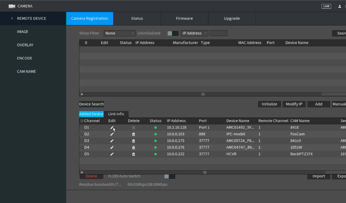

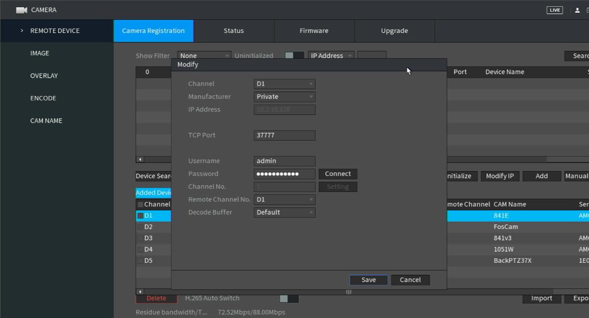

Ok sorry I am not 100% sure what you mean about not letting you edit it at all? Are you trying to in the area of the Pictures below?
If you have a open port have you tried to move the cameras to a different port to see if maybe they will come back online?

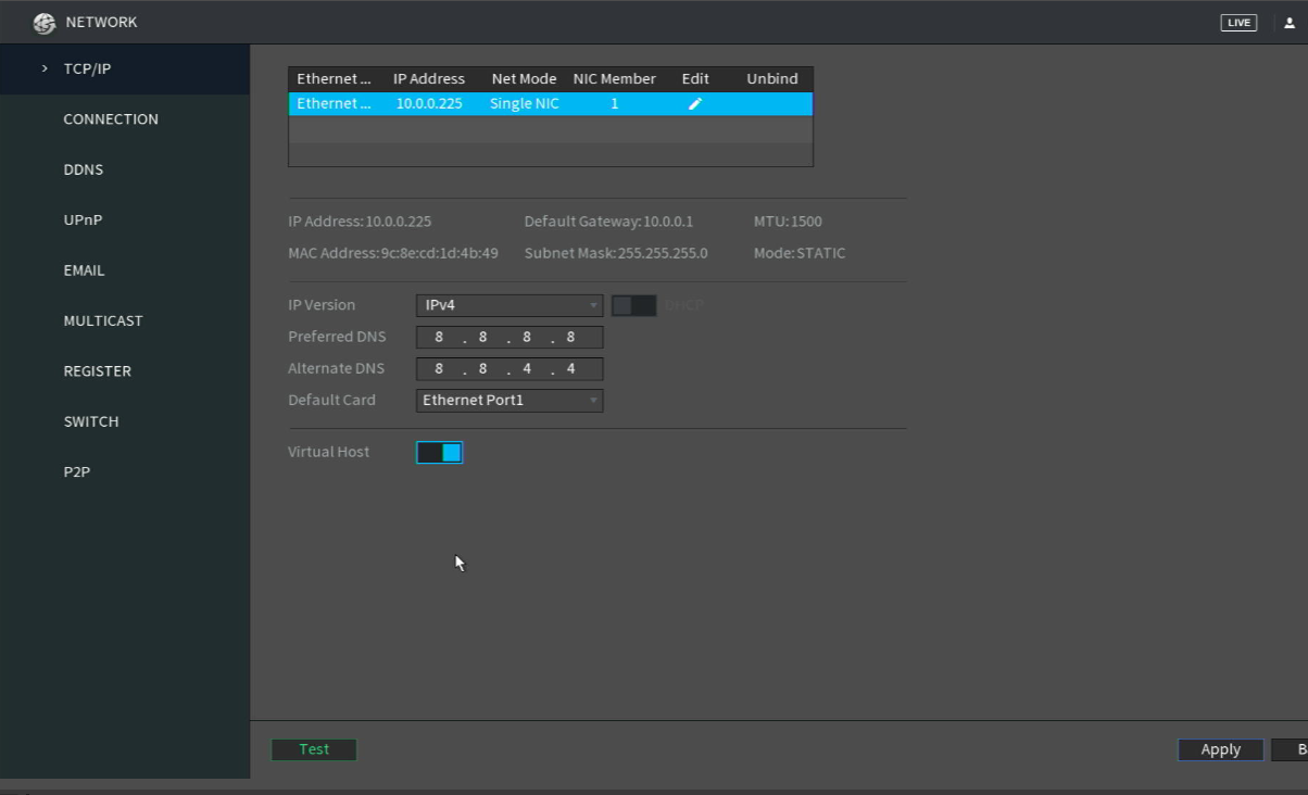

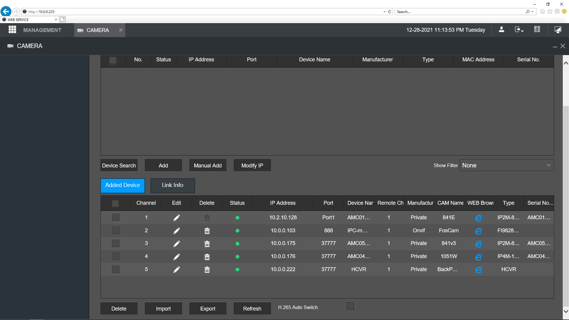

Also in the devices if you want to access a camera that is behind your NVR it will need to be done using WebUI over the NVR's IP and in the NVR you will need to have the Virtual Host enabled.
Screenshot (1713).png (163.94 KiB) Viewed 3167 times
Screenshot (1712).png (175.86 KiB) Viewed 3167 times
Screenshot (1714).png (116.28 KiB) Viewed 3167 times
this is area for WebUI if you wanted to edit a camera on the NVR's POE port pressing the e will open a port if you have Virtual host enabled

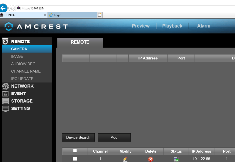

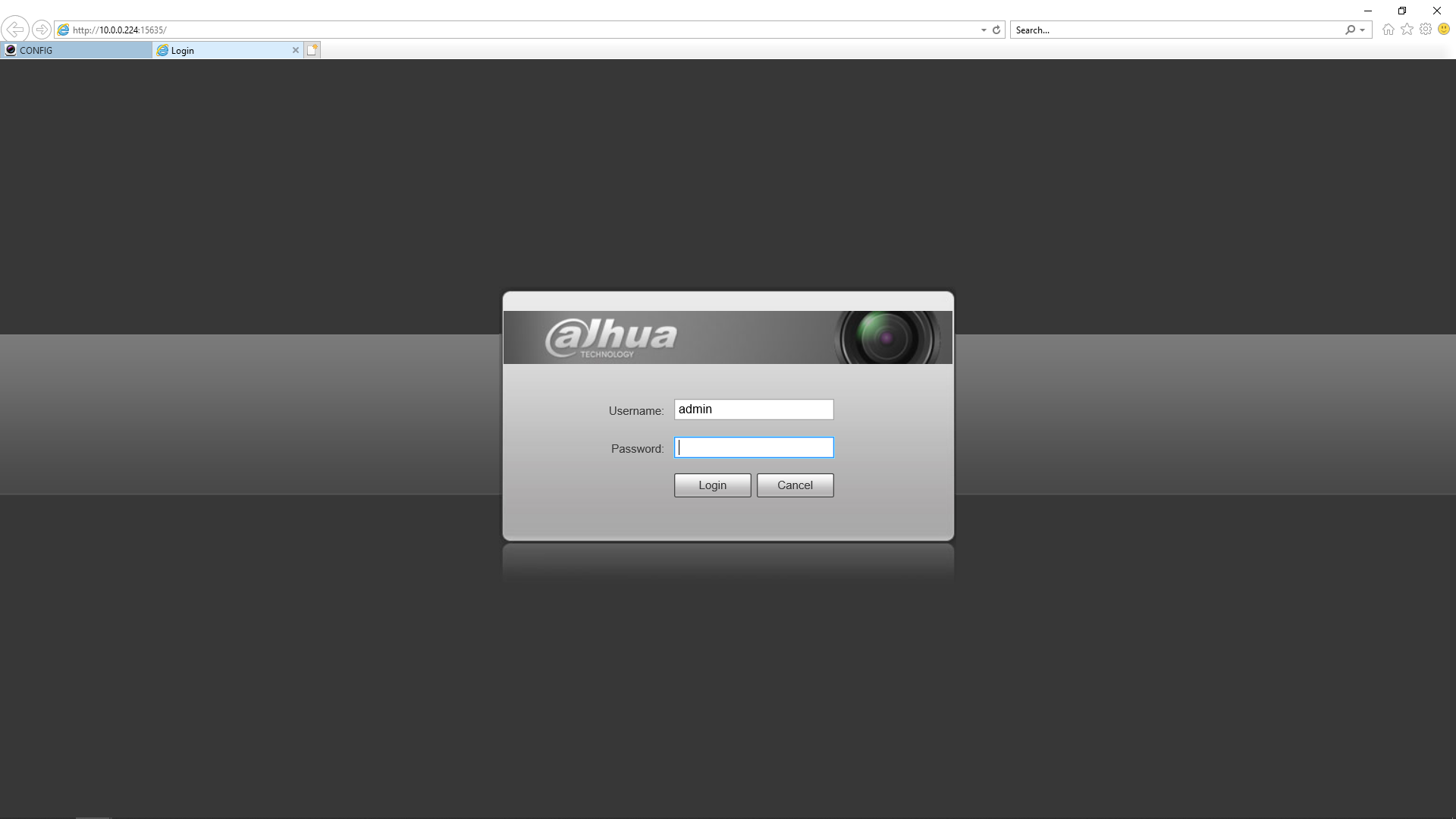

I looked at my 4018E and it is different then yours so that makes me think yours has to be a HS. In my old FW 4108E when I log into the webUI you can see at 10.0.0.224 and going to main menu, camera I can click on a e to gain access to the camera that camera I have connected is a Dahua on that NVR.. you will need to right click open image in new tab to see port number for my older unit when I click the e in the WebUI of the NVR for camera
Screenshot (1724).png (94.02 KiB) Viewed 3138 times
Screenshot (1725).png (72.28 KiB) Viewed 3138 times
