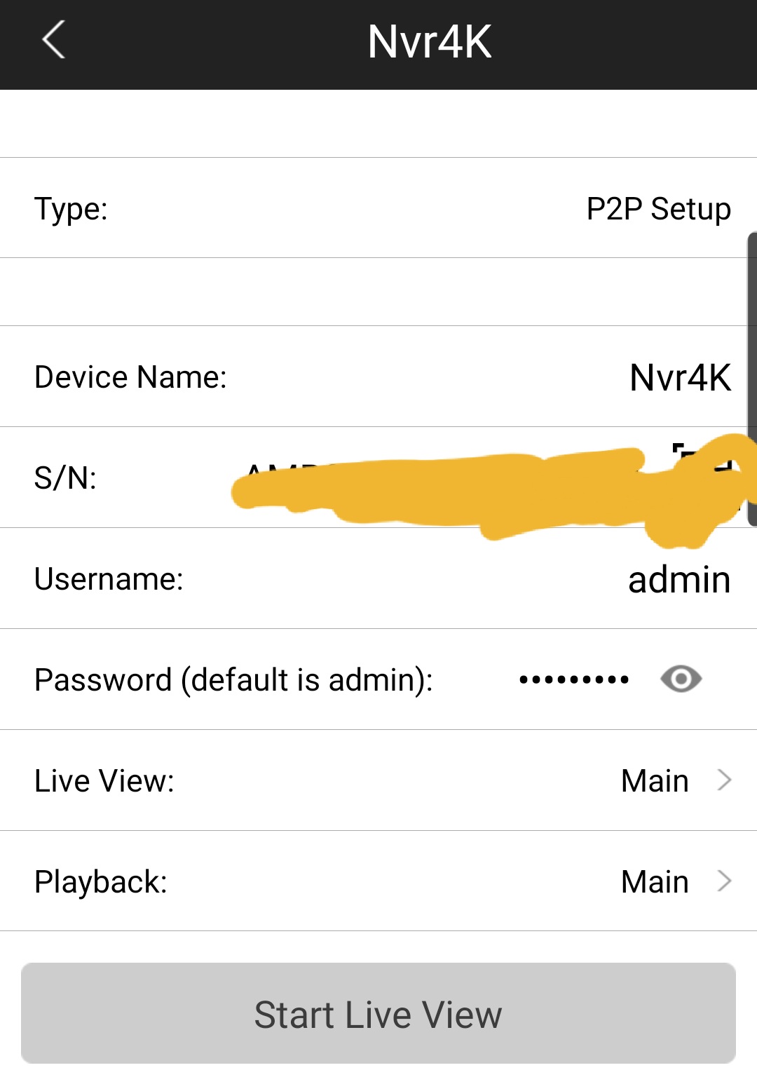

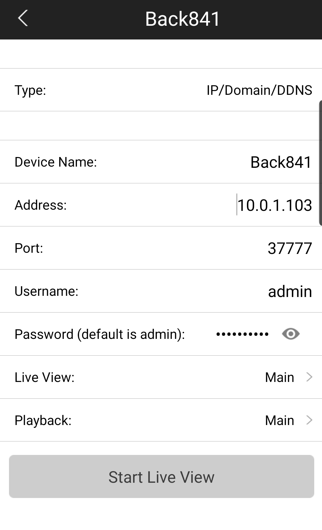

You will need to look at your Settings in your Phone app to tell how they are set.. I am going to guess that your 1 camera is setup with P2P and the other 2 are setup with IP and because they are setup under IP setup there is no way without Port Forwarding and having some other hardware config things playing to get your camera and outside devices working.. P2P is what you want..

Here is a couple of pictures from my APP so show what I am talking about...
If you look at one it will not have access to the Web because I have it setup for IP The other one on my NVR I have it setup for P2P and can't be seen outside my Network...

REVO2...… unbelievable!!!!! After having these cameras for 4 years, I can finally see all 3 cameras remotely thanks to your help!
You were exactly right, setting up for P2P, and the one that I could see was accidently already set up that way, I can now see them all. So with 3 cameras, I currently have 6 entries into my CFG database and I'm thinking I can remove 3. Now that I have both P2P and IP setup in the database, I'm thinking I can remove the IP one, correct? I manually logged out of it and the remote and local both seemed to still work.
