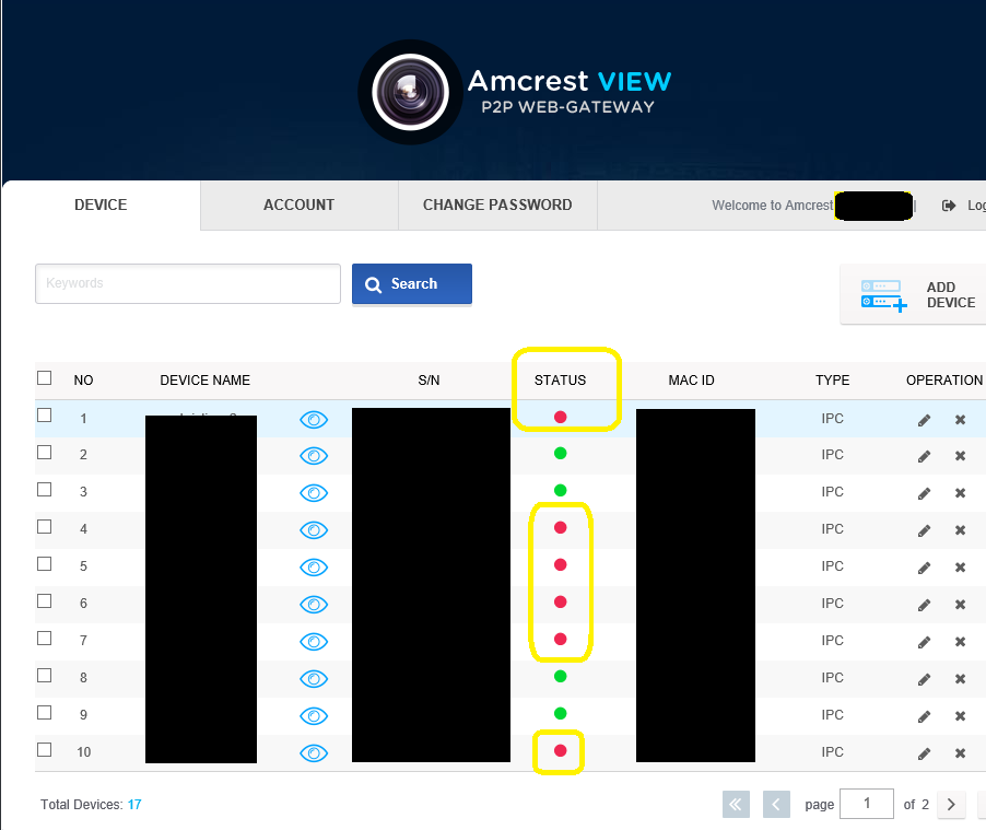

My company has many Amcrest IP cameras (different models like IP2M-841W-V3, IP2M-841S, IP3M-956W, IP3M-941B, etc. )
After setup (only wifi connection done and new password. nothing is changed after that) there is no problem reaching them over SN if the client in the USA but outside the USA we cannot reach SOME OF THEM over SN. Very strange cause for some of them, no problem connecting over SN even if we are abroad.
I check from amcrestview.com and see that the cameras that we cannot reach from abroad seem offline. But they are reachable from the USA at the same time

Re: Cannot connect cameras outside USA over SN
hello @Revo2Maxx
thank you for your reply
I take a screenshot from amcrestview.com.You can see offline cameras there but these cameras can be reachable by people from the USA. But others from outside cannot reach them. For Green Cameras, no problem. they can be connected from everywhere
Actually, I am not sure about the inside/outside USA thing. Because we don't try it for every country but to be more specific, our some employers are in Turkey now, and all of them cannot reach these cameras. My opinion about inside/outside the USA is related to this example
This is a really big problem for us. Hope you find out why
Thank you
Thank you
