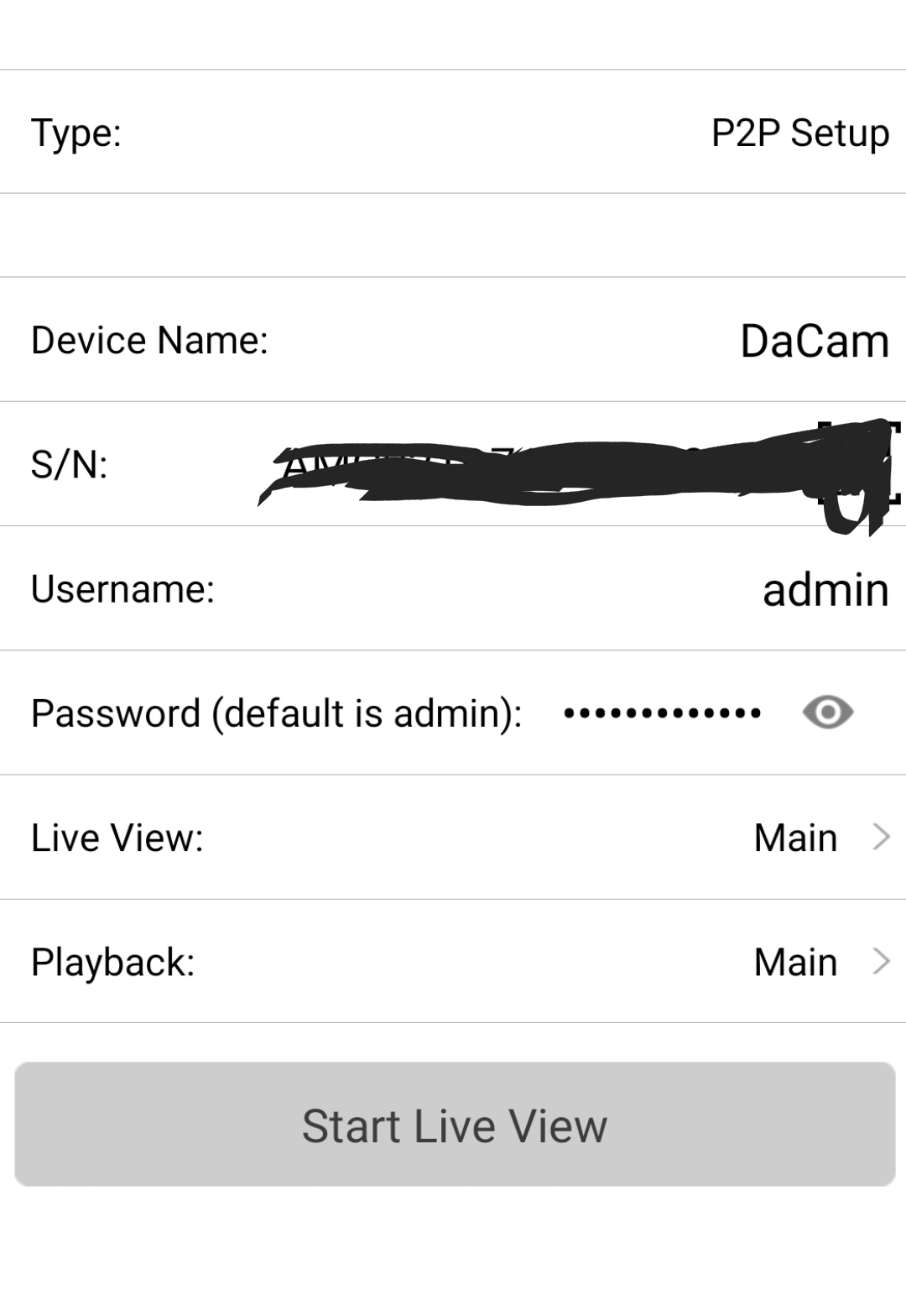

I will take a Guess. Did you set your cameras back up under the P2P or under IP connection? For my system anyway I have to many routers and they are on different IP's Only way I can access is back wards so if I log on my computer connected to my IP cameras Router I can access my network that is on my Server router because it is the DNS server for my IP camera router but I can't access my cameras from that Server router because the Firewall in that router will block it.
So for me I have my Camera setup P2P and i can access that over my phone on the Verizon network or other outside networks that I may connect to.

Thanks for your response. Mine says P2P like yours. I just used the phone to re-install, don't know any other method. Just scan the serial number and follow the steps.
For some reason, I am now able to access all but one of the cameras. When I installed this camera, it did not give me the normal opportunity to change the password. When I opened the camera gui in Chrome, it asked me to change the password, which I did. Now, the phone has the wrong password on it and it won't let me change it. I guess I'll just re-install this camera again.

From the phone bring up the camera you can't view. Click on the Device Manager on the Left side, Then click the name of the camera in the list, Then click the little Pencil/pen looking thing. Then there you can change the password from what you had it to the new one without installing it again....
