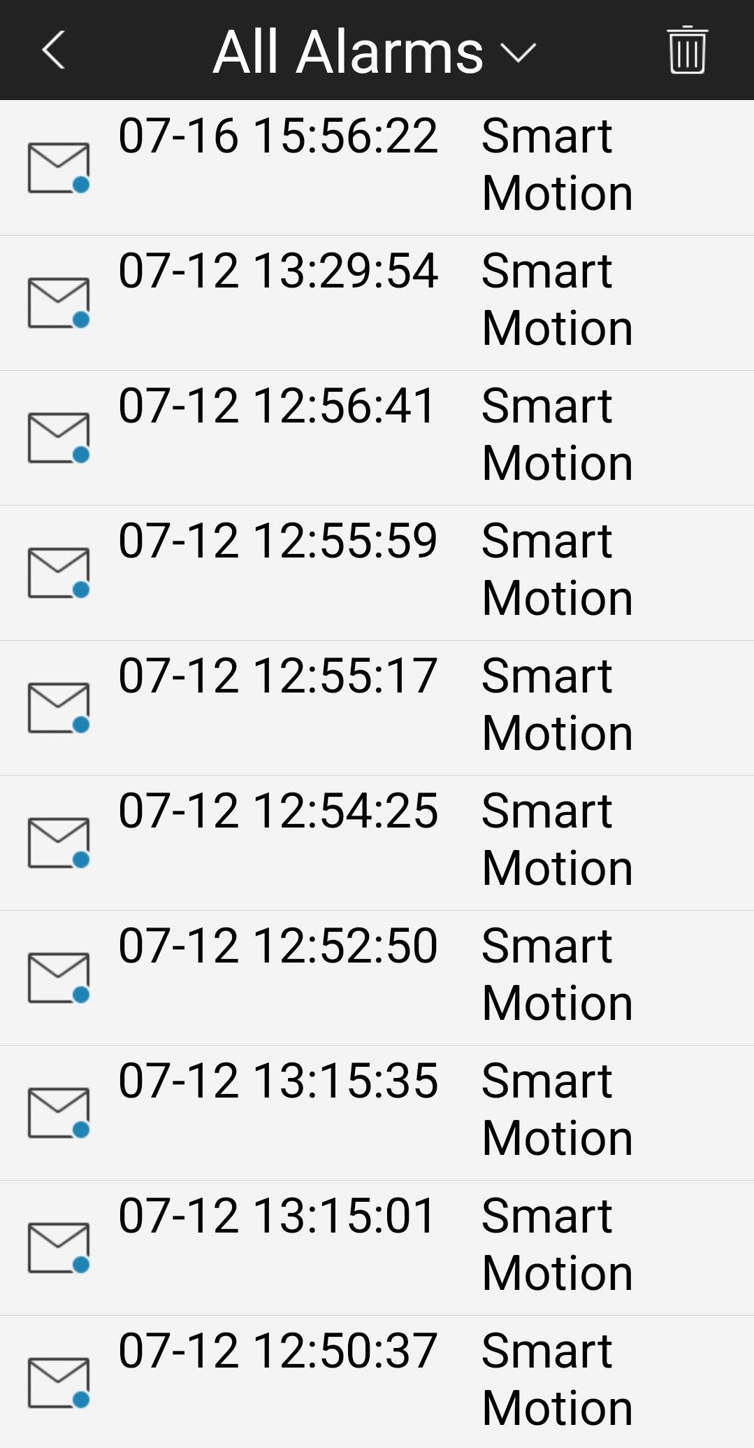

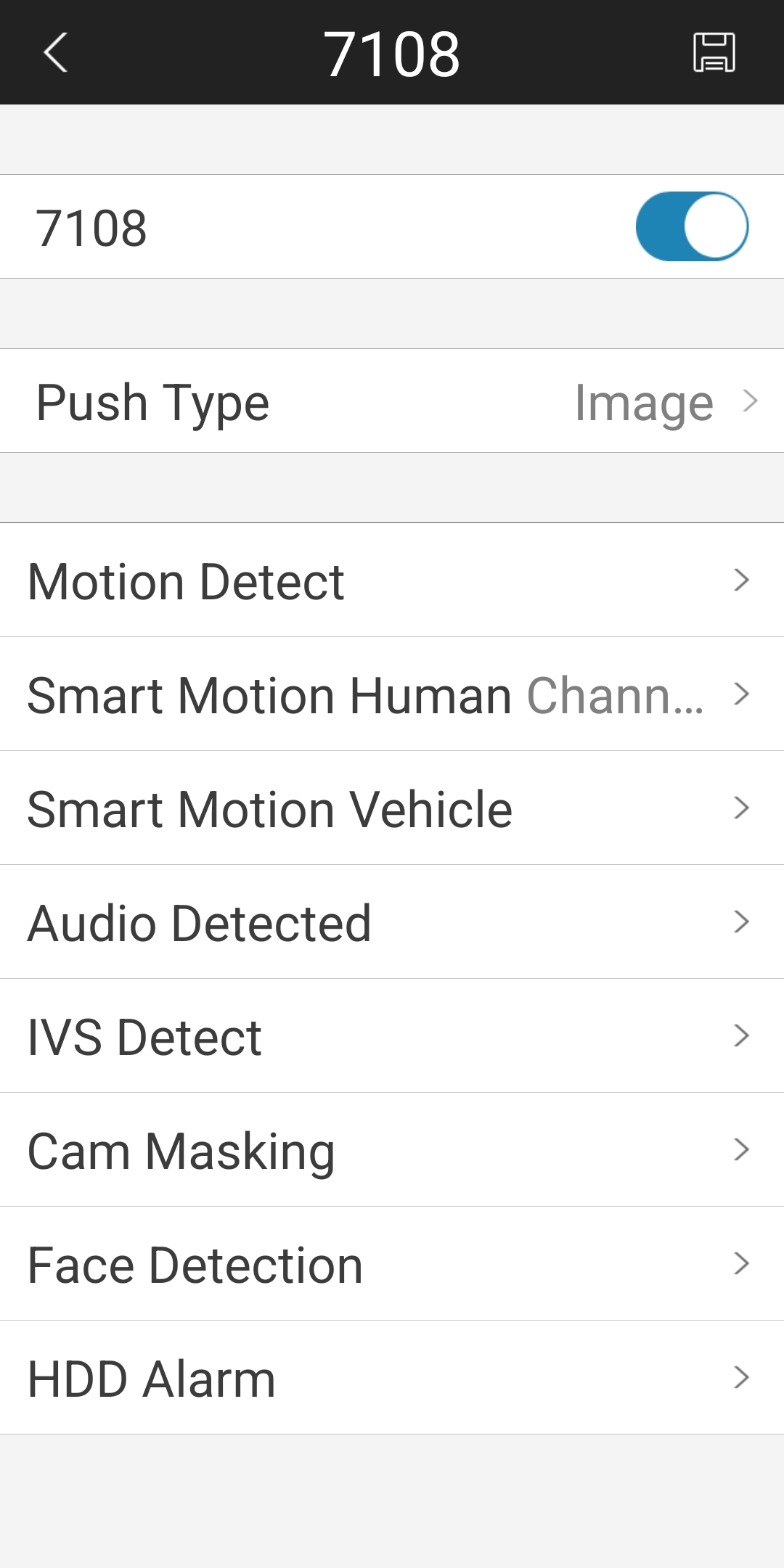

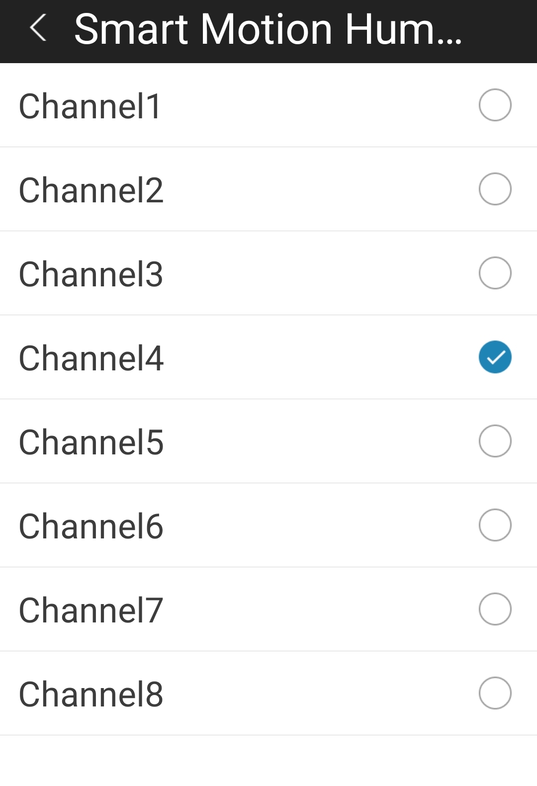

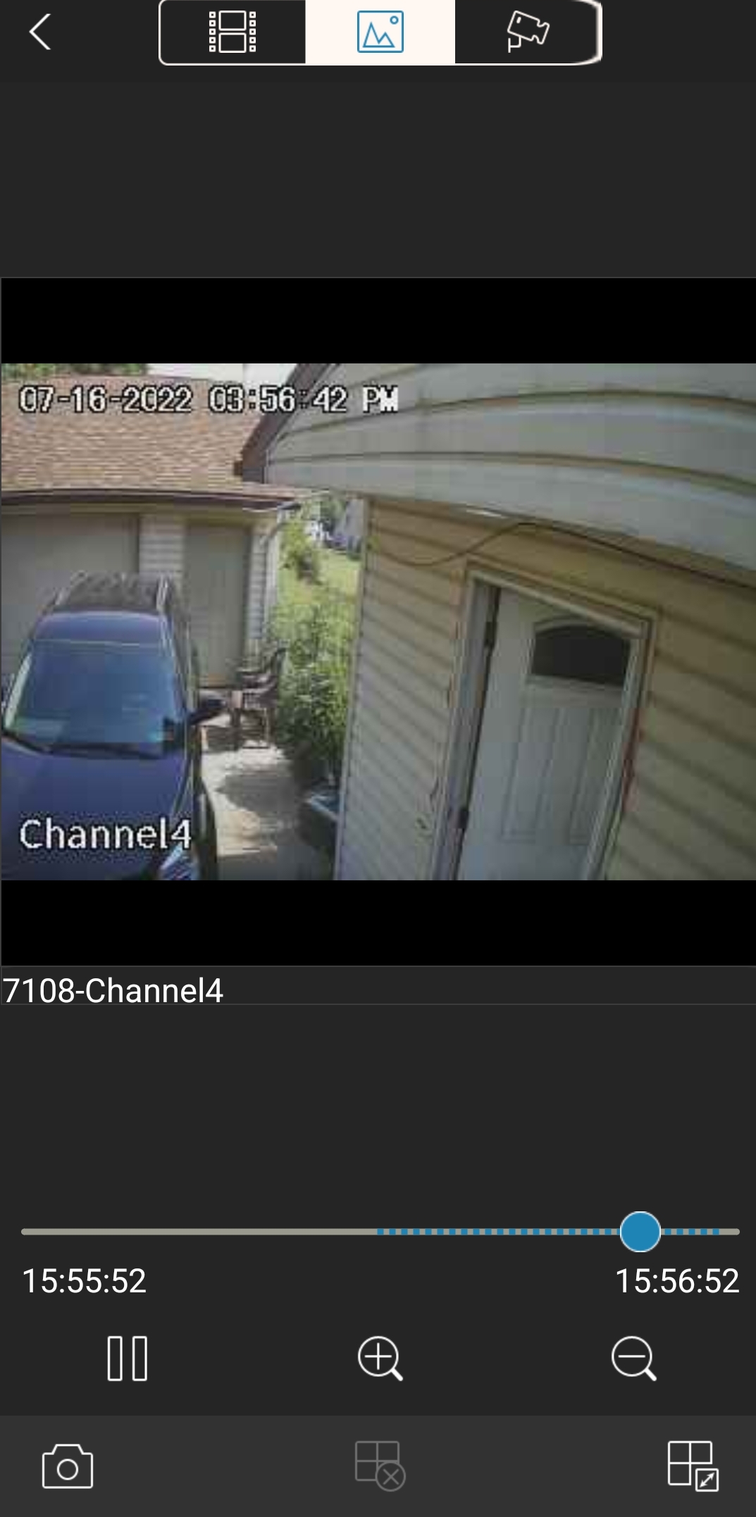

I have had my push turned off for a few days however I did turn them back on to make some snapshots of images and my settings. Please note I am at this time using my 7108-AI DVR for SMD and had it setup for car and humans. Had my son step out on the back step and it played the images back I grabbed a snap shot after he started to go back in so he wasn't in picture to upload but you can see in the image there was a good amount of images in this Push.
