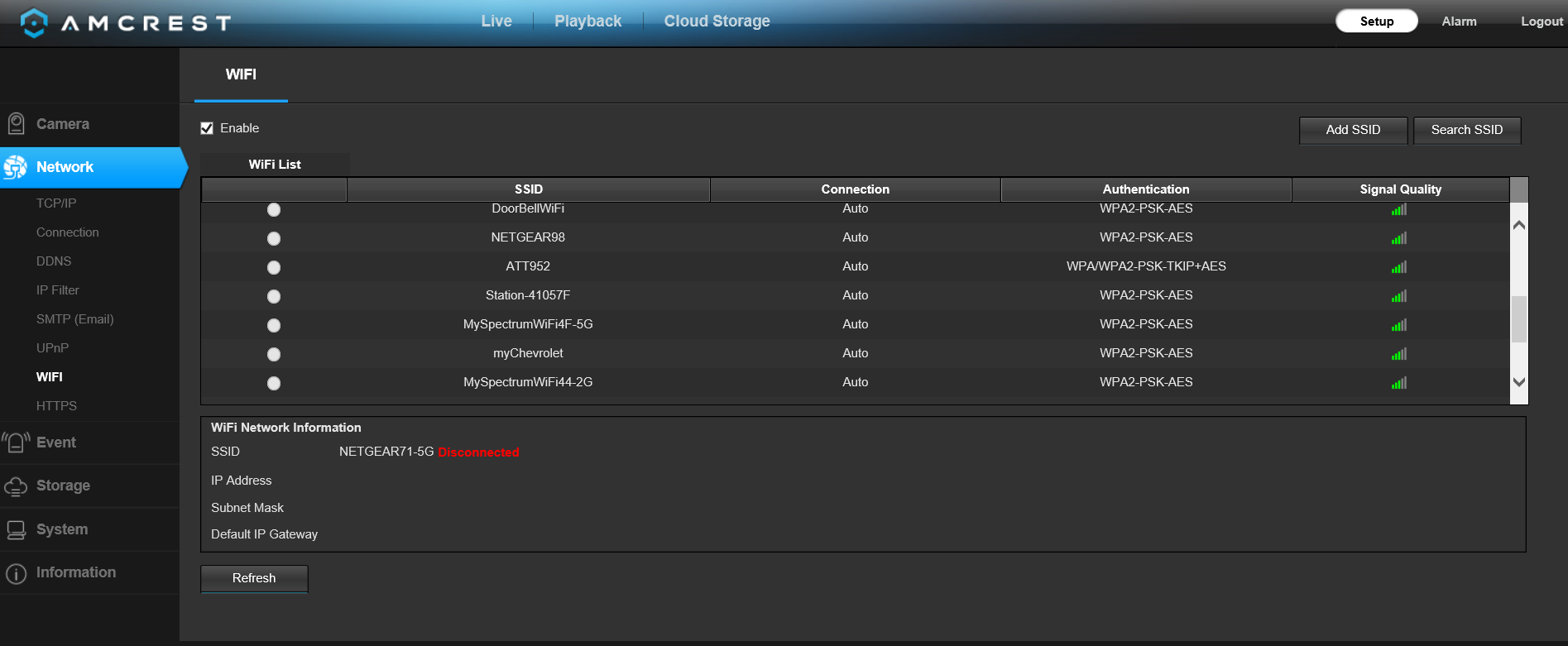

IF you are connecting VIA Wired connection then yes you can change the info from 1 SSID to another. However if your working with a NEW SSID and no connection via cable then only way would be to Reset the camera..
Log into the Cameras WebUI, click on Setup, Then Network, then Wifi, then in there you can Disable it.. Looking at my picture you will see my 1051 that I did have connected VIA Wifi and then I moved it to a location that has a Cable, so I now am using cable, In this list before it was Not Checked, However just now for the Picture made a Check in the box and it now show what Router SSID I was connected to and shows Disabled click on the one you want to Enable to make the changes needed for it to work. ONce done Remove the cable and let Wifi take back over.. In most cases it is best Practice to just Reset the camera and setup to new Wifi for best connection..
