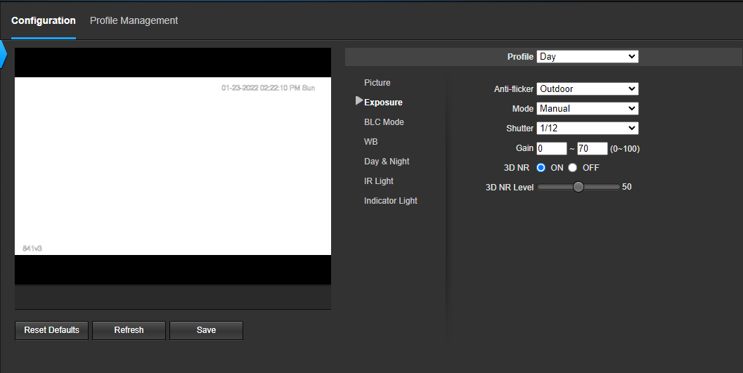

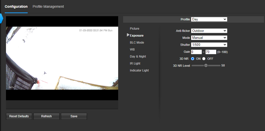

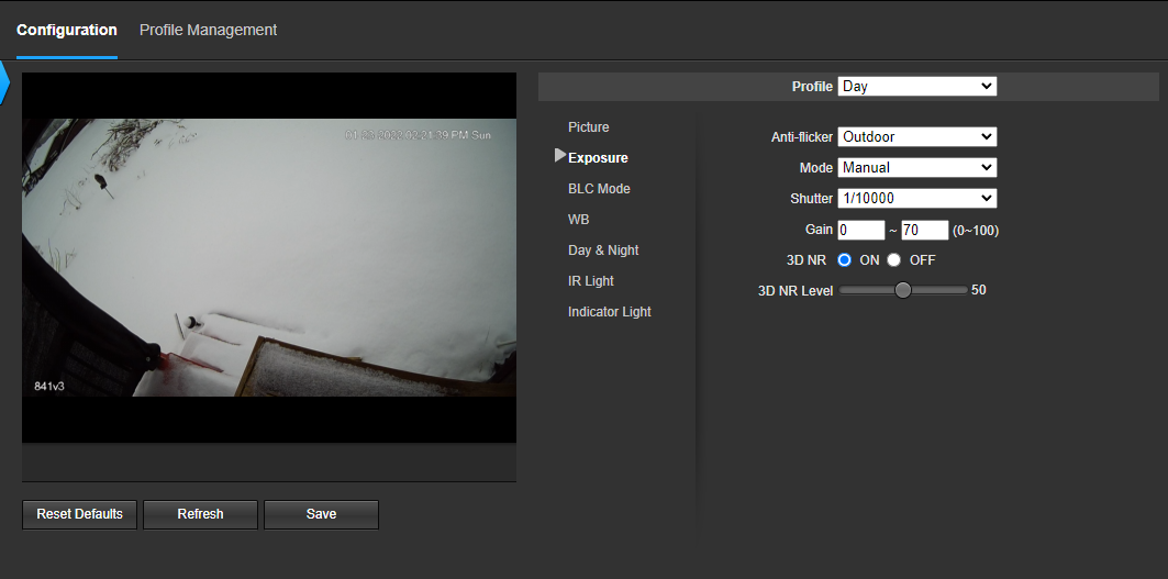

To give better understanding of what I am talking about looking at the 3 pictures the top one is what it really looks like outside, center one might be good setting for someone to use to make sure they can see the scene well and the last picture might have been about what the camera was using when you got the alert. (software for Tamper isn't always smart enough to know it is Program)
Screenshot (1804).png (167.15 KiB) Viewed 677 times
Screenshot (1805).png (87.11 KiB) Viewed 677 times
Screenshot (1806).png (28.97 KiB) Viewed 677 times
