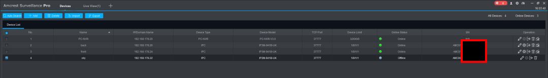

OK, this is my devices page.
The third column shows me what the IP address (Yes IP/Domain Name) of each device is (3 cameras and PC-NVR which is treated as a separate device). Note that I have deliberately logged out of one camera (the bottom one) and the icon is different. As I said, it's a toggle i.e. it does something different depending on the current state. If in your case it currently says "Manually Login" when you hover over it, then that's the problem. Login and all should be well

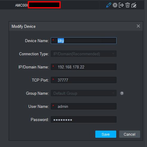

If you click on the Modify Icon (the pencil) you should see something like this
I would be inclined to delete that camera and start again by adding it using the LAN IP address. The way I get the IP is to log into my router admin page and look at devices currently logged onto the LAN. If you search the Amcrest Site you will also find an app called IPCONFIG that allows you to 'discover' devices.
