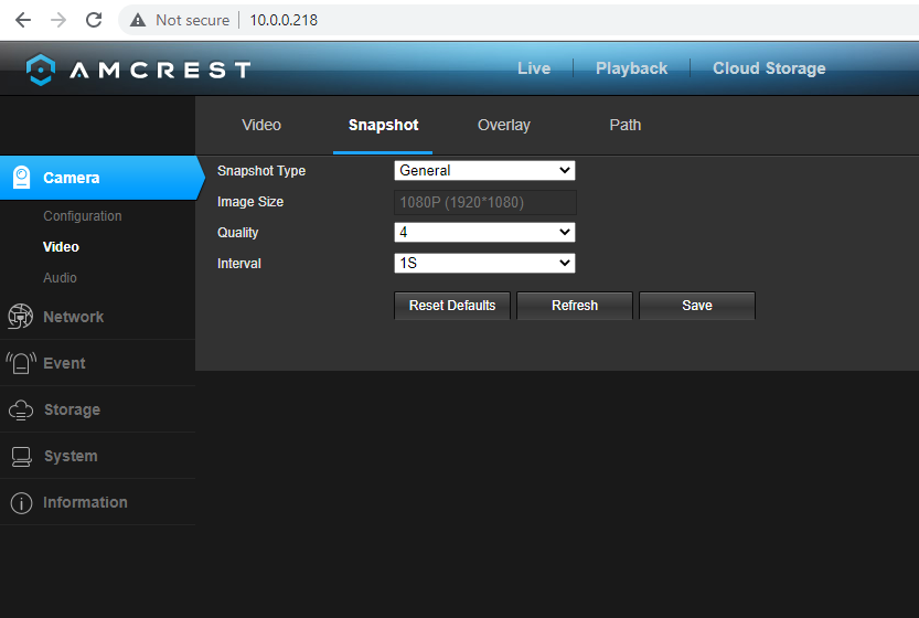

Re: Camera IP3M-943B, Motion detection alerts, but no image
Please see the picture, Log into your cameras WebUI at the IP address of the camera like inmy case it is 10.0.0.218 and then click on setup, then you can see on the left where it needs to go then on the center of the top under Snapshot...
Screenshot (855).png (54.5 KiB) Viewed 3766 times

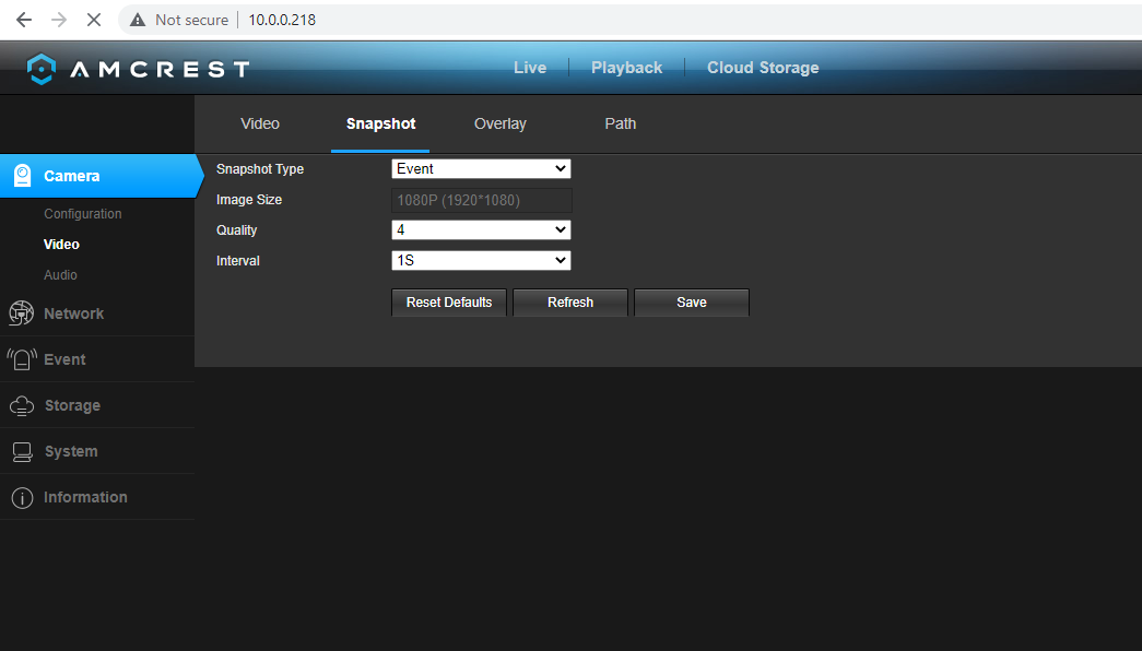

sorry that was for General but if you click on the Sanpshot type and change to Event you can see in this picture as well
Screenshot (856).png (60.13 KiB) Viewed 3766 times
