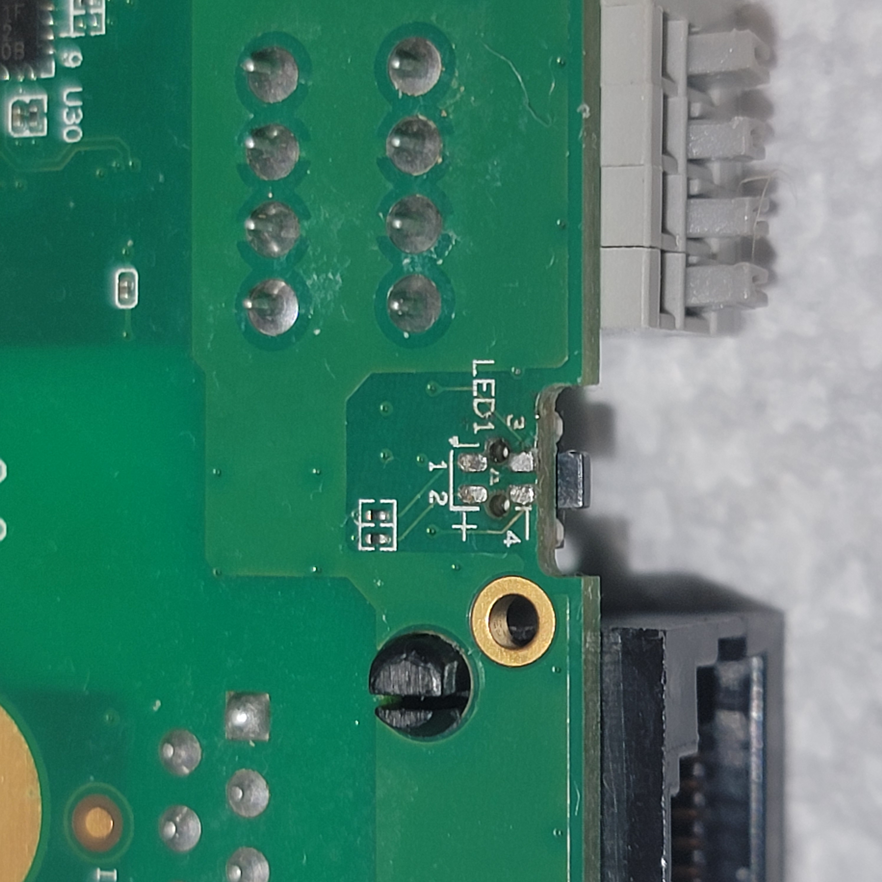

Scratch that lol, so removed the bad cameras Led and tested it and it lites now out of circuit so will have to find the fault past the led.. so I am clear, I tested all other cameras leds and the dead one was only one that didn't lite on green, so thought ok bad led. No something in circuit is clamping to ground in bad camera. So will have to follow circuit to find fault. Testing led off board both leds work. I wanted to confirm red and green lit as well, so both working after removel seeing stress on leds to heat and so yeah not the LED....

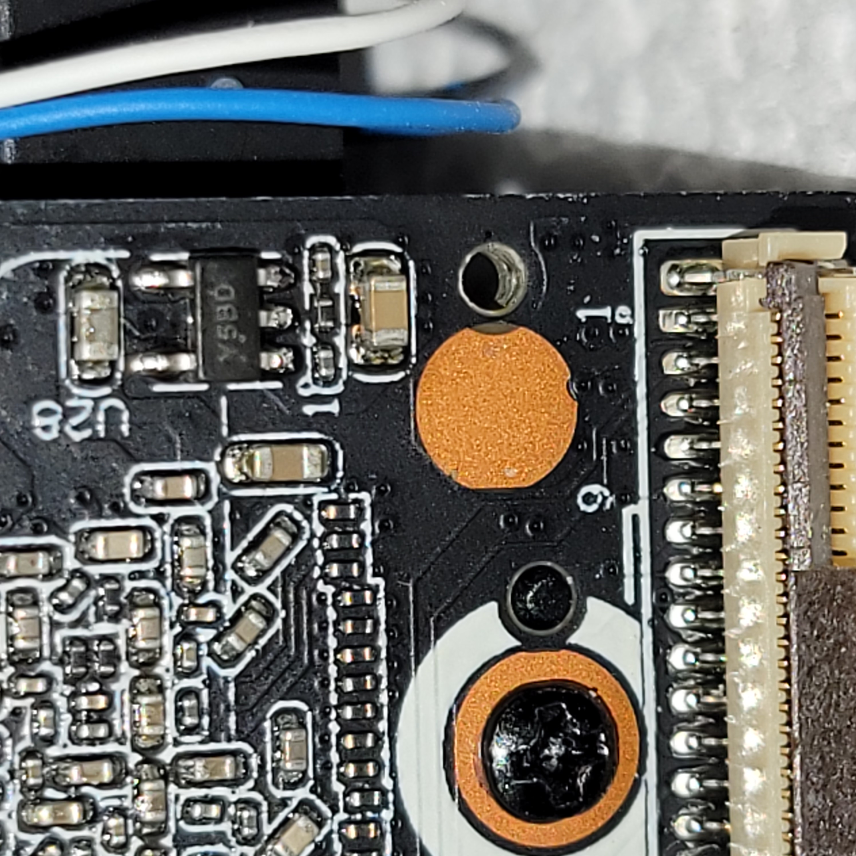

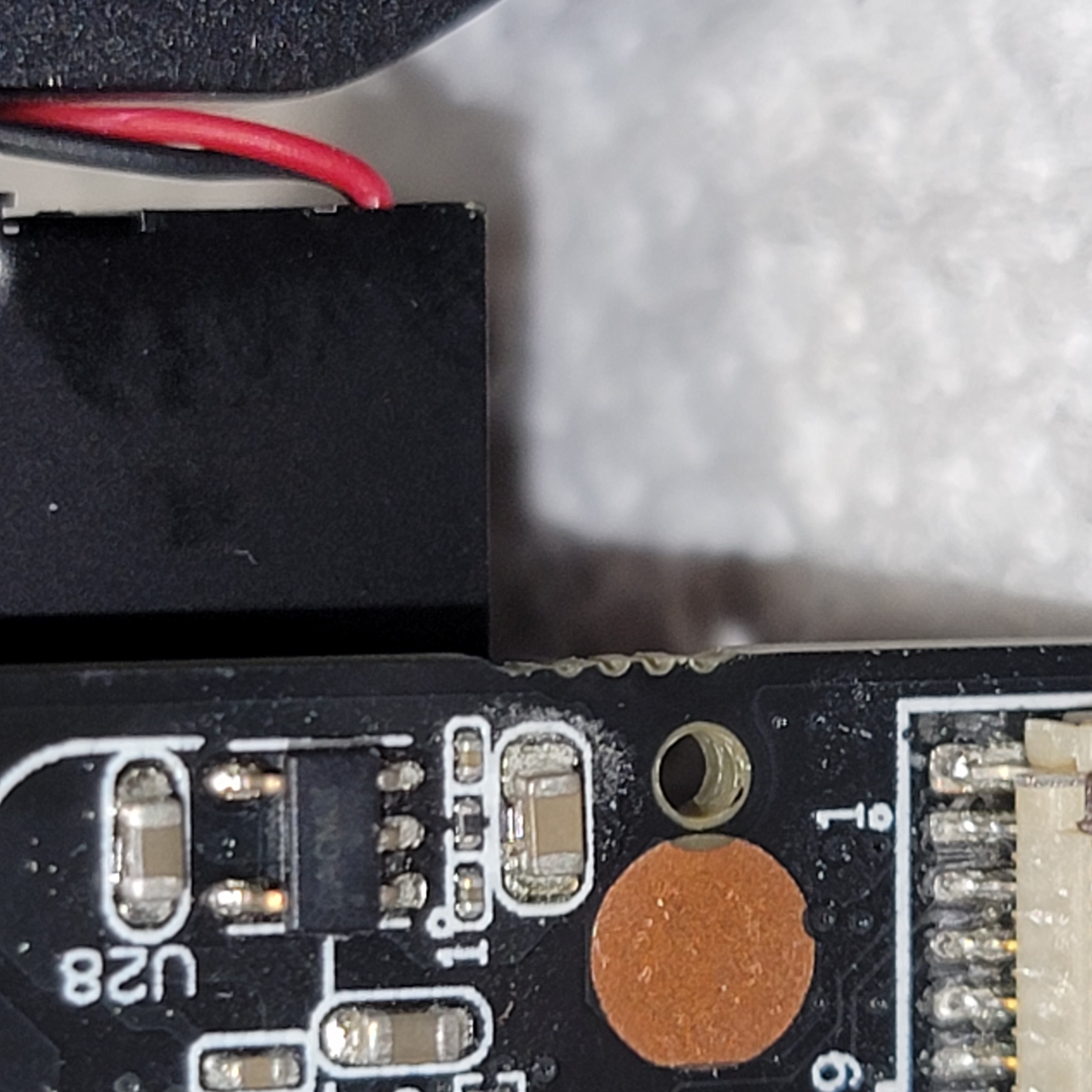

In second picture it looks like the pins had been very hot. 3rd picture of good camera the pins look normal nickel in color. Now that could have been soldering issue when they put together.
Re: Bricked IP2M-841 with wrong voltage?

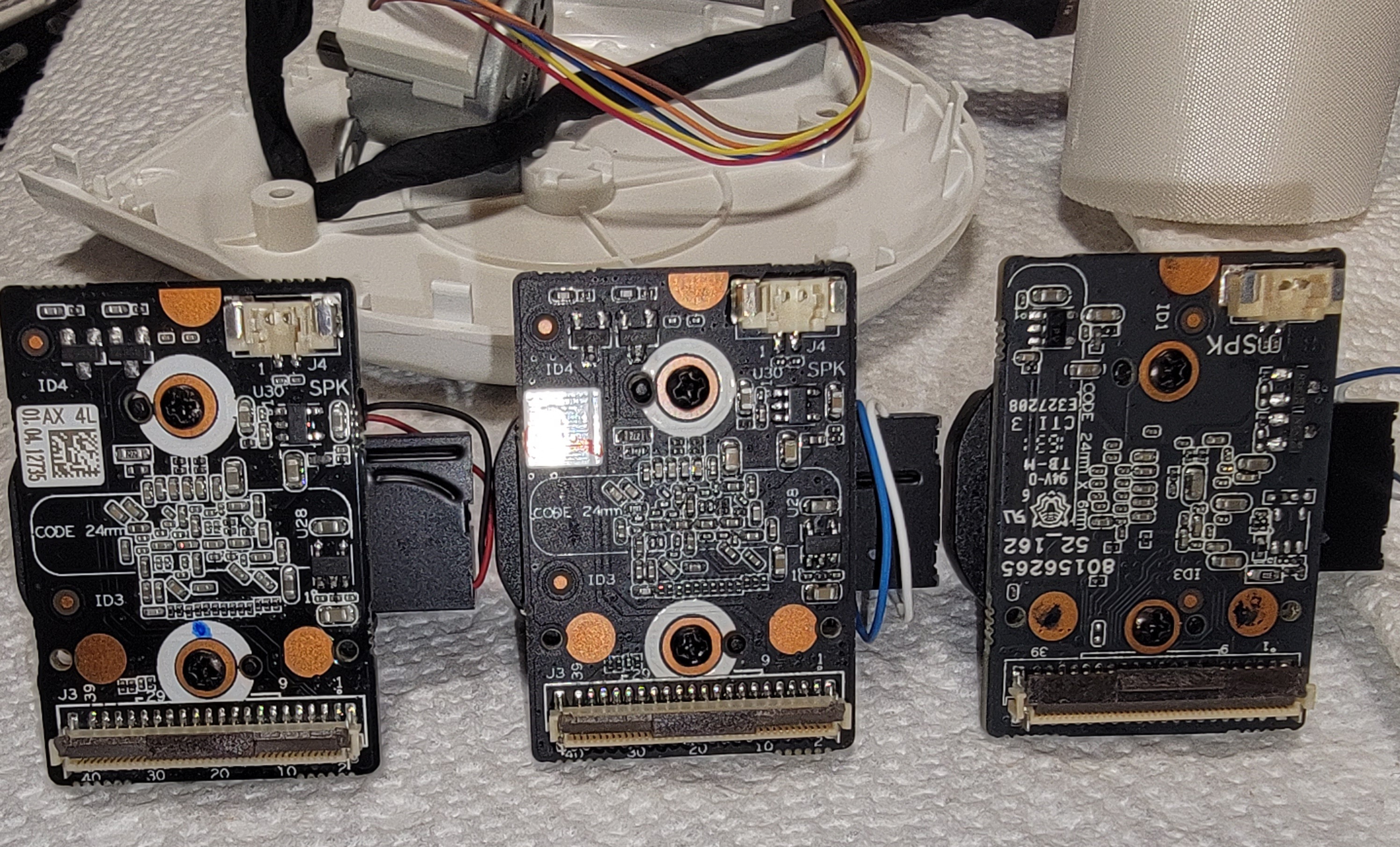

So not sure but bought 10 AP2127K-1.2TRG1 to replace the sot23-5 on the camera board. With any luck it didn't take out the sensor and only the LDO. Output is 0 on the dead one and testing a good camera 5v in 1.2 out so not 100% that is correct value seeing working camera while older 841 circuit is little different as you can see in the 3 camera picture. Right now only thing to go on. Might be a 1.8v and the 5v amcrest power supply has larger voltage drop then when I use my bench supply on the dead one. All I know is sot23 has no output. As soon as I get the chips will install and would be cool if was only thing wrong with the camera.
