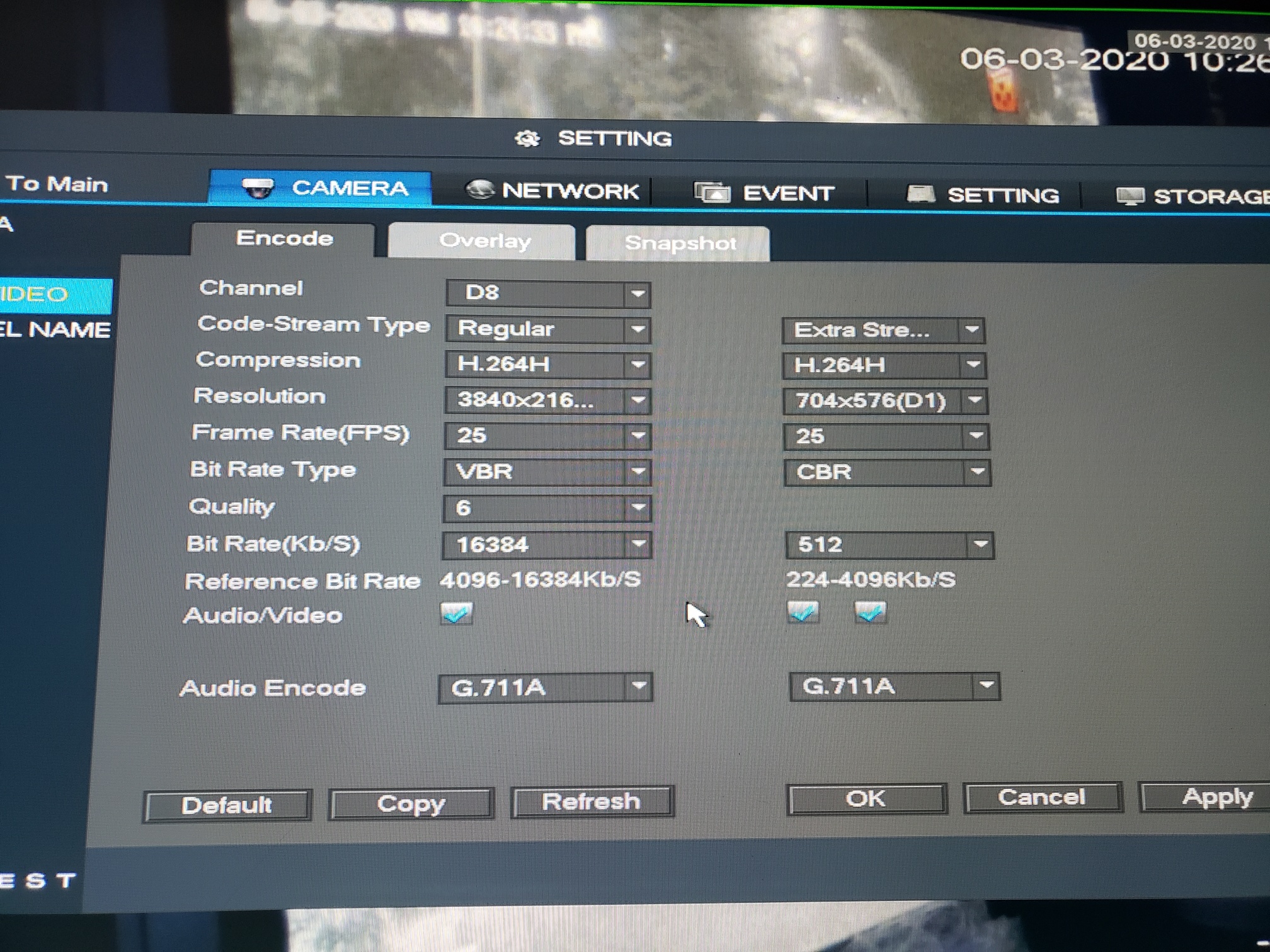

Well did some testing on my 2116hs and tested at 3840x2160 QFHD
VBR
Quality 6
16384 Kb/S
Min was 4096 to 16384Kb/S so ran max and was no ghosting on this NVR over my 4108 in fact this one works better then WebUI

Re: Bit Rate
I changed only main encoding I also didnt have sub 1 or 2 recording.
I am going to guess that you running h265 was why because in yours only need half the Rate
