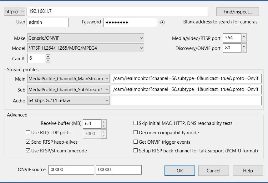

One way or another it will work with BI. If it's currently running on a NVR, BI can simply snag the typical Amcrest MRLs (streams) from the unit either automatically with 'find/inspect' or manually by entering the NVR IP address and login info. You would then simply need to specify the camera's channel as shown below and it's a Blue Iris device with whatever Amcrest capabilities are recognized.
Amcrest DVR-NVR Channel Streams for BI.jpg (130.02 KiB) Viewed 2922 times

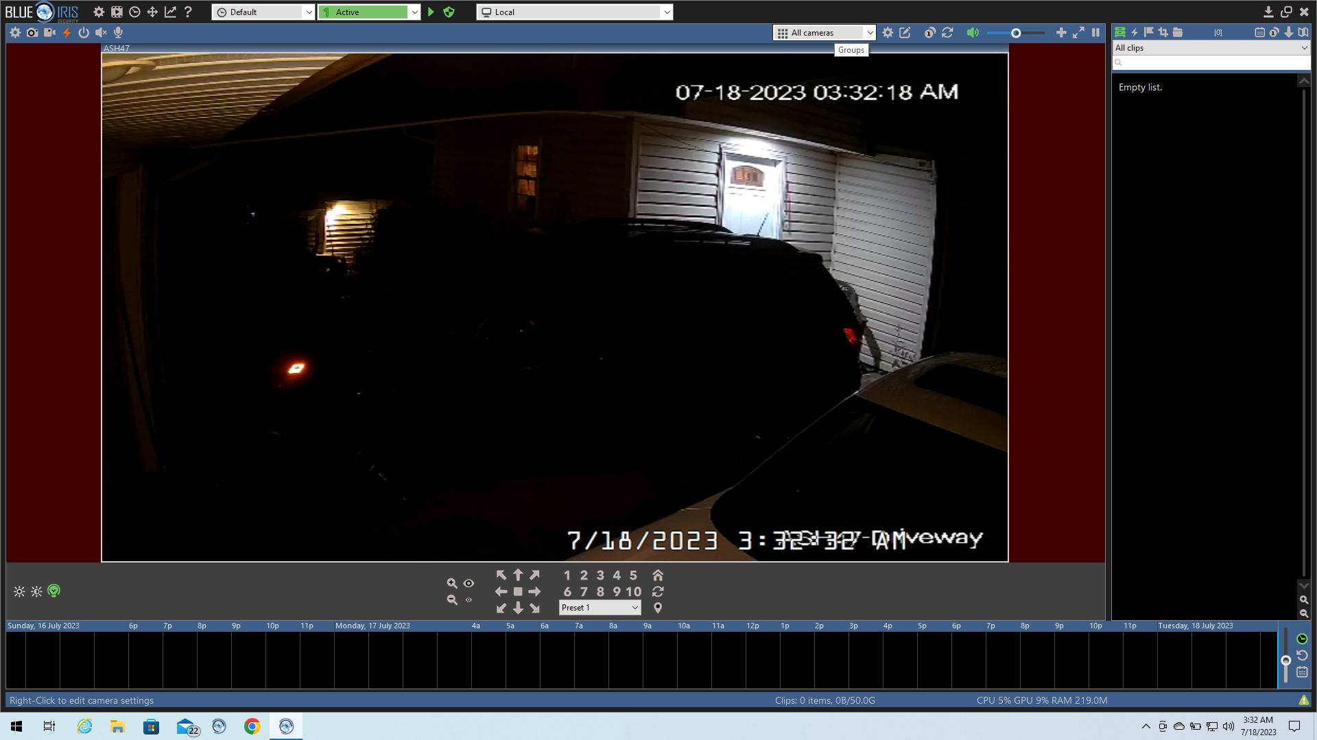

As Pogp said you could use a DVR/NVR to access the camera and then use Bi to access the controls from the recorder. However my guess is that you don't have said recorder and that brings up the ability to access the camera on BI, I was able to access the camera, However I couldn't access the PT controls or should I say when I tried to pan or tilt or even use a preset that I had to setup in my NVR to setup. I couldn't access the presets or make the camera pan and tilt. When connecting using just the camera setup in BI..
Here is a picture of Preset 2 but not because the BI was able to put it there. I took this picture of my Black Chevy because it is the last night it will be in my Driveway. Tomorrow I take Delivery of a 2023 Honda Ridgeline RTL-E
So yeah if you wanted to use your camera in BI only, I would look at the 1190, It isn't built as nice as the ASH47 but it is a real IP camera 5mp...
Screenshot (45).png (572.85 KiB) Viewed 2917 times
