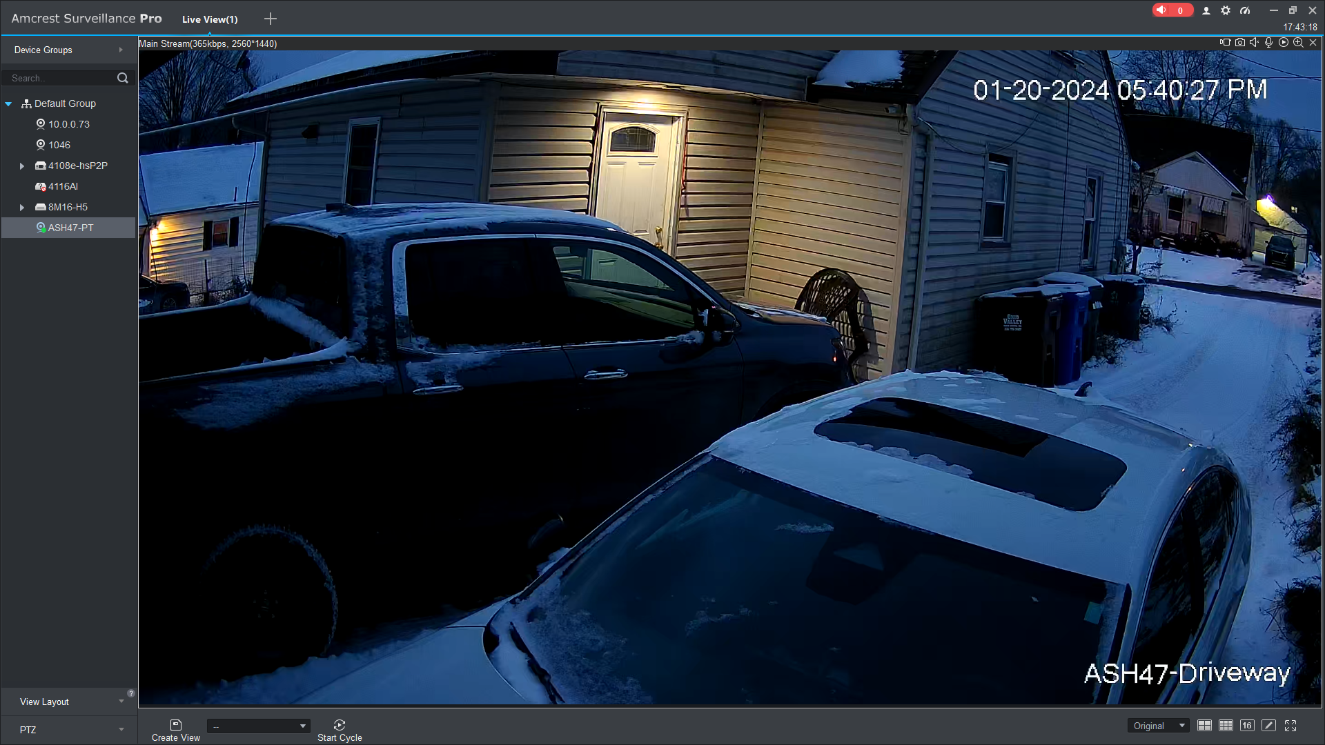

My current state with my ash47..
Screenshot (1045).png (1.9 MiB) Viewed 1887 times
