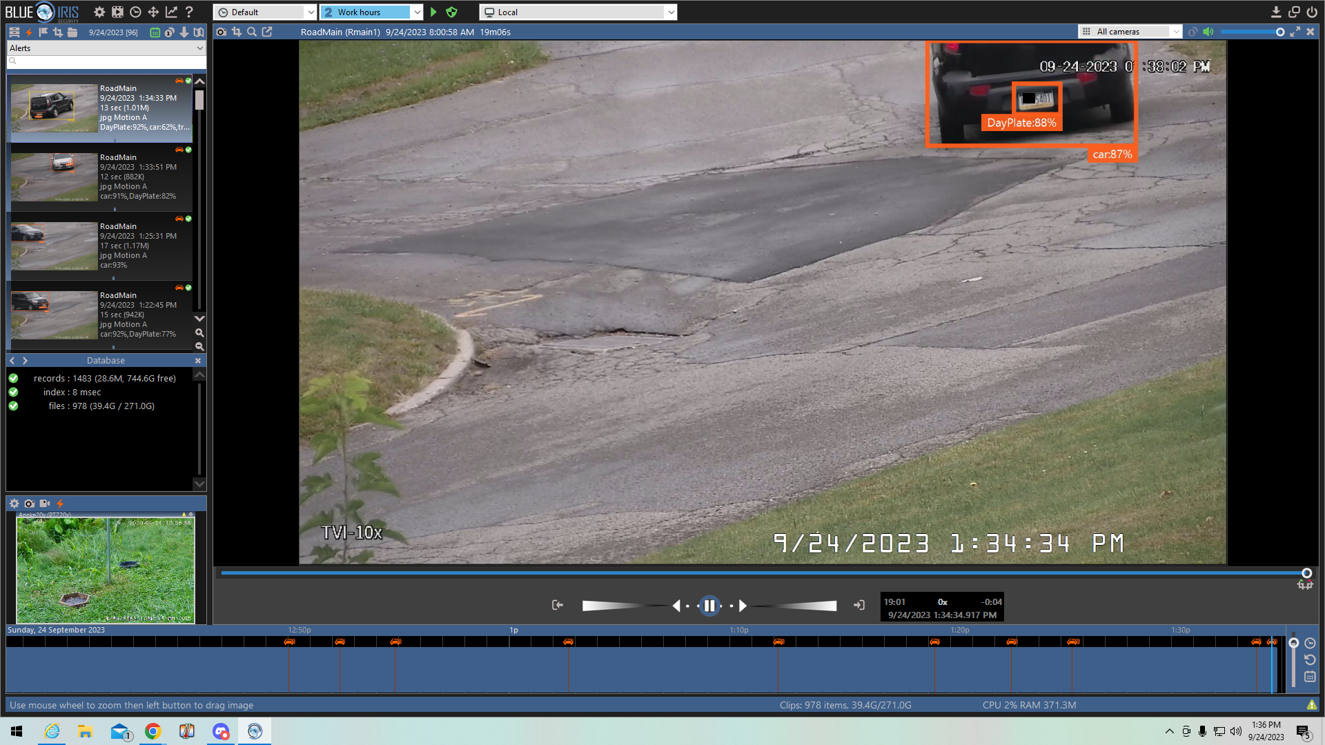

I have setup BI to work with some plate reading. To be clear at the zoom location of that static camera it can't read plates I have to zoom into the road more and plates can be seen. While Bi can record the plates number by design that isn't setup good enough to do so but can clearly see plate if you were to play it back. Here is a Picture from doing so in BI from yesterday..

In that picture you can see that I have my 10x zoom static camera zoomed into a closer point to the road then it was in the video. Normally that area where it would show 92% dayplate would have the plates number in there as well, also can be saved to a database for searching just a plate.
Blue Iris is 70 software and can make even a normal static non AI camera a very good capture of the world around us. Worth every dollar spent. However with that said I wouldn't say that it would work well capturing plates using the ASH47 much past your own driveway. This camera is setup at 30fps with 6144 bit rate. While the ASH47 has better and bigger MP lens then my 2mp camera. I have a Optical Zoom camera that works from 5mm to 50mm and this picture is about 33mm to 35mm as that car is about 80 feet from where my camera is mounted.

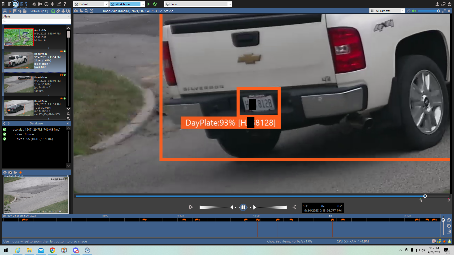

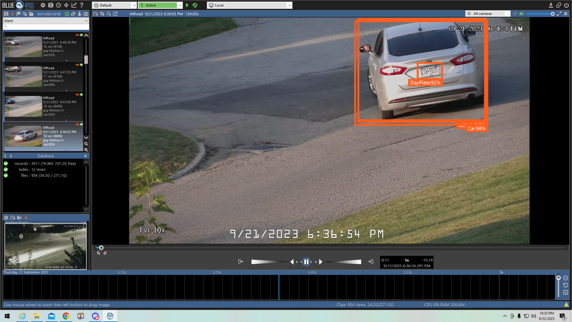

So I had someone ask me about License plate and why his setup that is kind of like mine won't capture a plate. So I thought I would show some of what I was talking about when it comes to seeing the LP of cars. in some cases it could be position of the car. In these pictures added you can see that I waited until it was almost out of frame to show the plate however this isn't the point it was clear just wanted to show in my FOV (Feild of View) I have a good distance between starting point that I can see the plate to almost out of scene . In some cases if the lighting is to low, to high or if the camera isn't setup just right for the current conditions you can't make out the plate. However in this post I will show that the camera did see the plate even at this distance and using the Digital zoom feature of the software or hardware being used can even make that detail clearer then normal view.

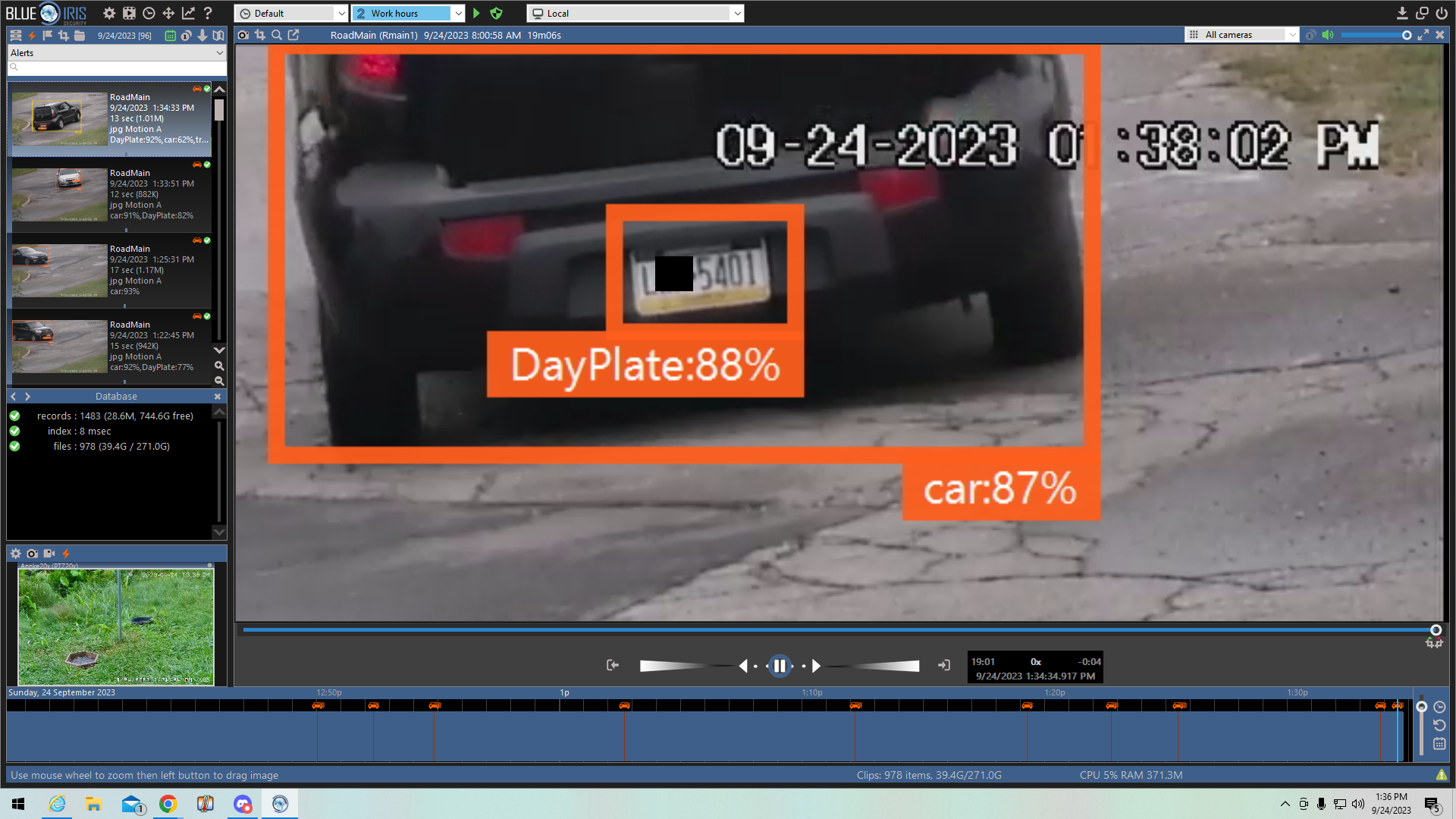

Just a follow up to the ability of BI and the system being able to read the plates and adding to a data base..
