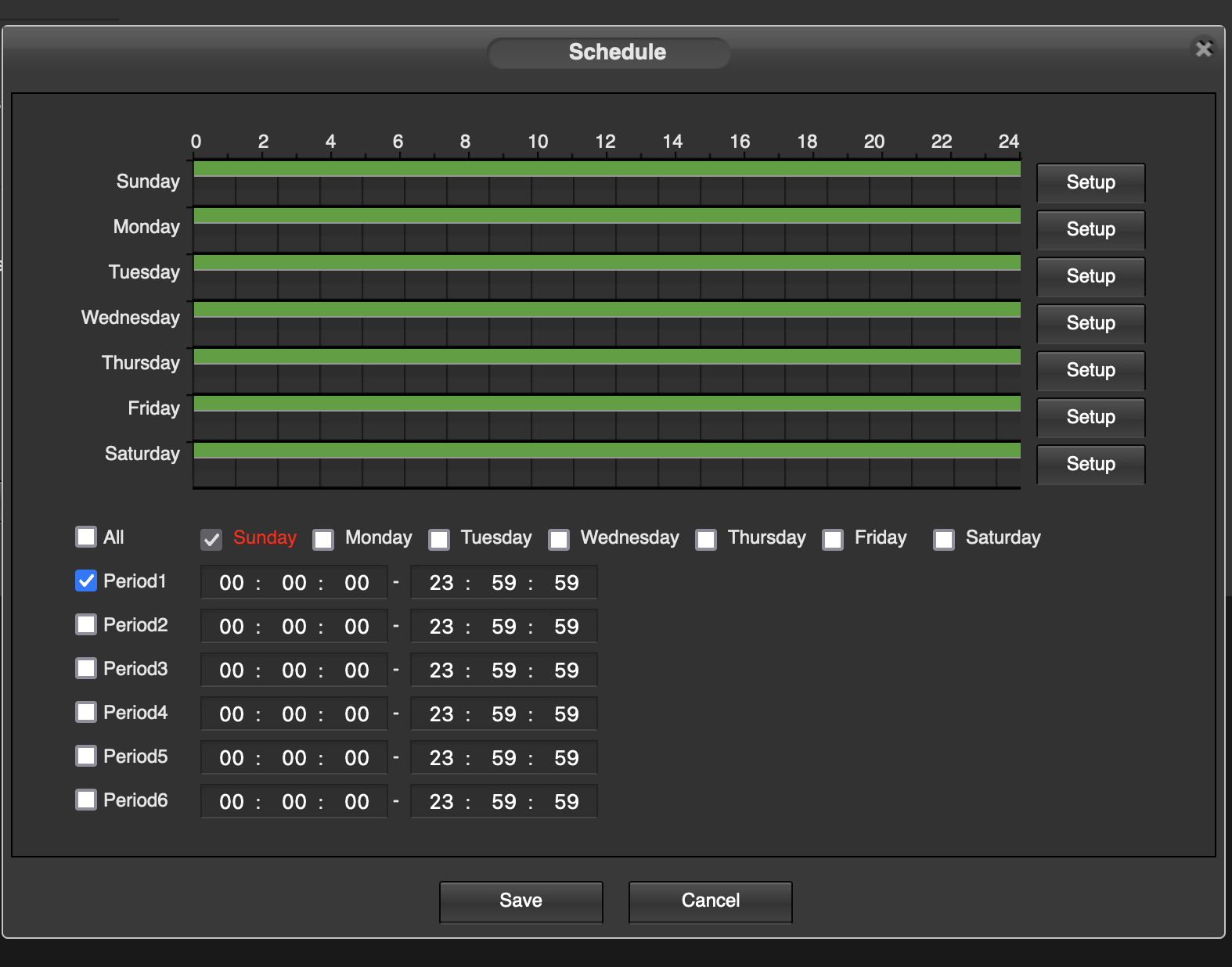

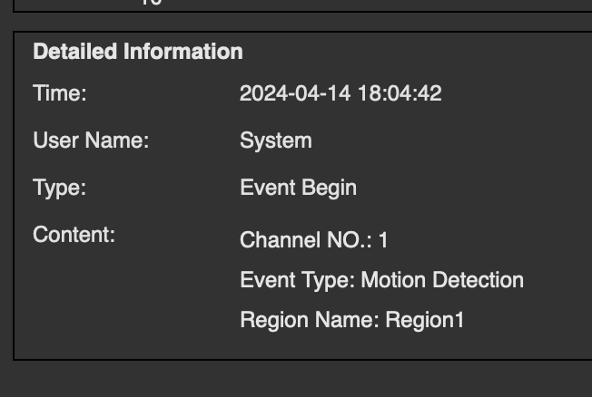

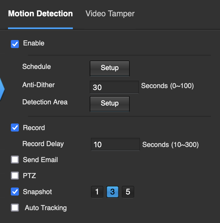

I have a IP2M-841W-V3; I'm trying to subscribe to motion detection events so that I can trigger some other api actions on my other smart devices. I've tried the python library and the sample code found here: https://github.com/tchellomello/python- ... -702815674. I have also tried hitting the api directly with postman and curl http://<camera>/cgi-bin/eventManager.cgi?action=attach&codes=[AlarmLocal%2CVideoMotion%2CVideoLoss%2CVideoBlind%2CFaceDetection] (I have also tried using '[All]').
All my attempts result in the connection being made and then hanging with no output. I've tried walking and waving in front of the camera to trigger an event. I confirmed that in the logs on the web interface show a motion event beginning and ending so it seems just the api is broken. Can someone point me in the right direction or suggest a next debug step? I have posted screen shots of some relevant configs and the log showing that motion detection is showing.
