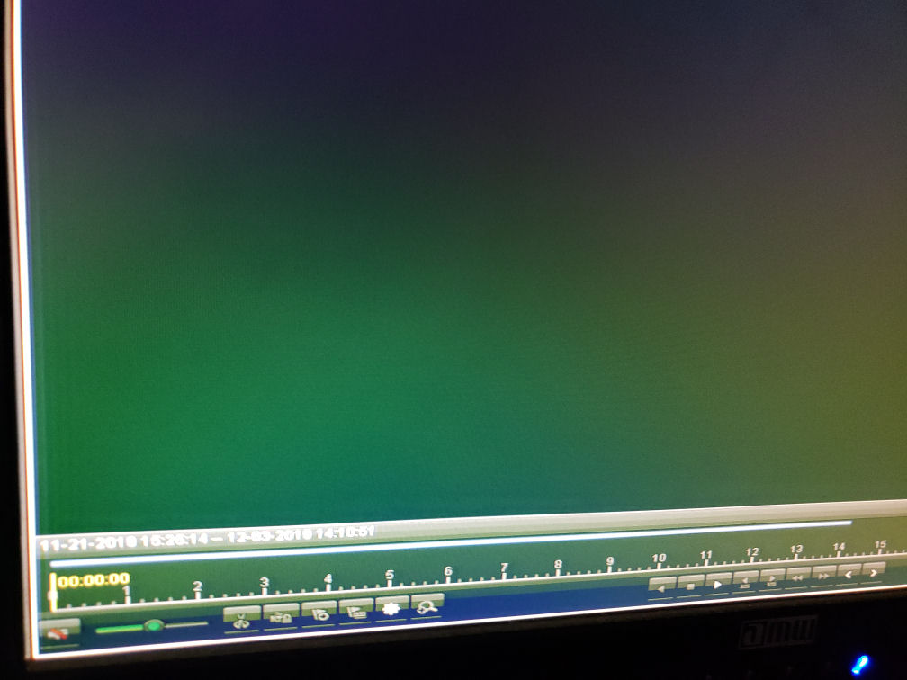

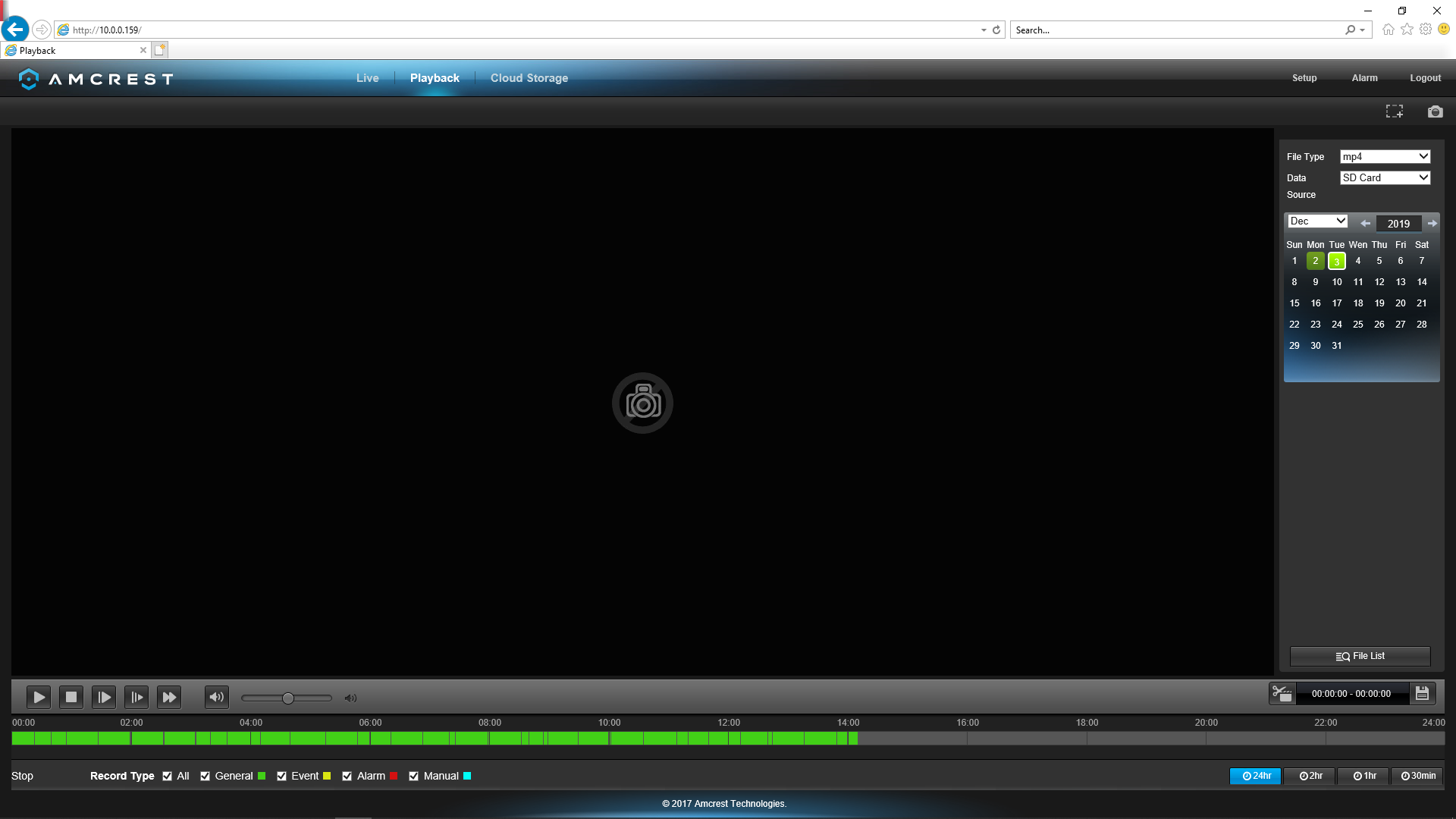

So strange... I have not looked at the FTP Server I better soon I am sure it needs some purging by now lol.. However looking at the data since midnight some strange things going on... First Picture I will add is a Screen shot from local WebUI of the Recording on the MSD.. Second Picture is from Brand N DvR that has IP Camera input and has had this connected for months. Most issues have been found on the DvR with recording because of loss of Wifi.. However since Midnight don't worry about the time saying since 21st of last month that is just a time line of how far back that CH data goes since last Purge... Anyway looking at the Recording bar on the DvR you would think there would be cuts from loss of Connection. However looking over Logs and Network Traffic data there hasn't been a loss of Connection from that IP. So strange that the camera MSD has so many loss data and DVR has all good recording data... If you look at the First Picture at every hour there is always a mark there.. However if you look there area many many marks in the records since midnight. This on the MSD... Again I tested the Card it is good... I wonder if it don't like the Cold. Un-like some of my Other cameras this one don't have a Heater built in it however it didn't get much under 30 degrees F. last night so it is within its Normal temps... The second picture shows what ever the issue with the Camera and mSd wasn't do to power fail or loss of network seeing all was recorded over Wifi that is really outside of its reach anyway and I have Concrete walls to boot... Things that make you scratch your head...

Your 721 looks like it may be in its last days.
In your Web UI screenshot, the green bar with black lines does seem to have some repeating patterns in it. Have you clicked File List? It might help in analysing the blank areas. It appears your camera keeps running but something is interrupting the msd recorder on a fairly regular basis.

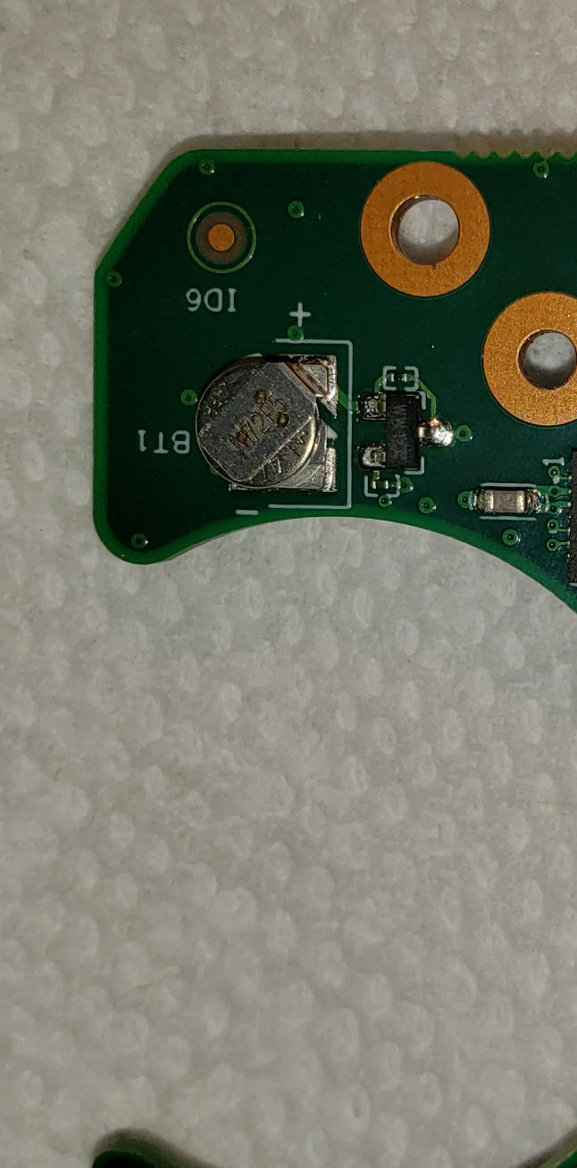

Here is a Picture of the Battery of a 841EB Because of the Nature of the MB I am going to only post a small area of the board showing only battery area. This battery location is next to the Pan Motor and cutout in the PCB for motor. Sadly this don't seem like a slide in and out battery it is soldered into MB just like my Speed dome.. However my speed dome take much larger 3v battery...

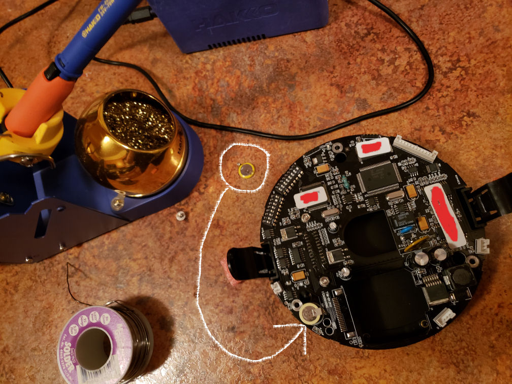

Thought I would post a Pic of the Speed dome MB after I installed new Battery that it needed.. Old Battery was at .91v on a 3.0v battery lol... When power was removed or rebooting, the camera would come back online with Crazy dates lol...
