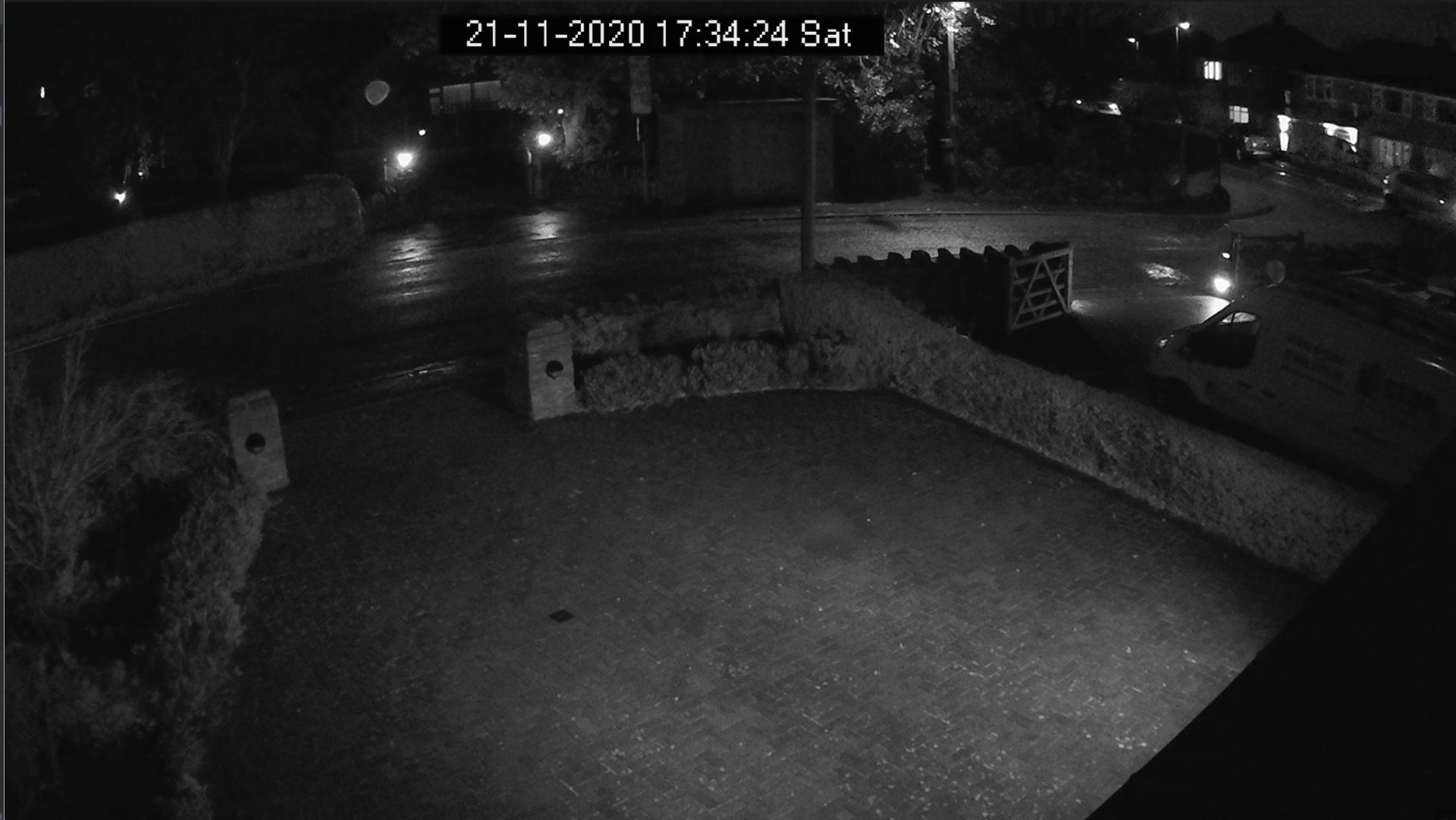

Noty quite the same problem here and I can't answer your question but I have cameras 'looking' out through windows so I have to switch their IR lights off to prevent glare back from the glass but I've got a couple of IR illuminators mounted outside which fill in the IR light from my external cameras very well. I got two and am very happy with them (one for the front and one for the back of the house) - https://www.amazon.com/Tonton-Illuminat ... 306&sr=8-2
My drive is completely dark to the naked eye the pool of light on the right is from the illuminator and the one on the left from an external camera - I solved a problem similar to yours by sacrificing a small amount of coverage and turning the camera away from the wall where it was mounted.
