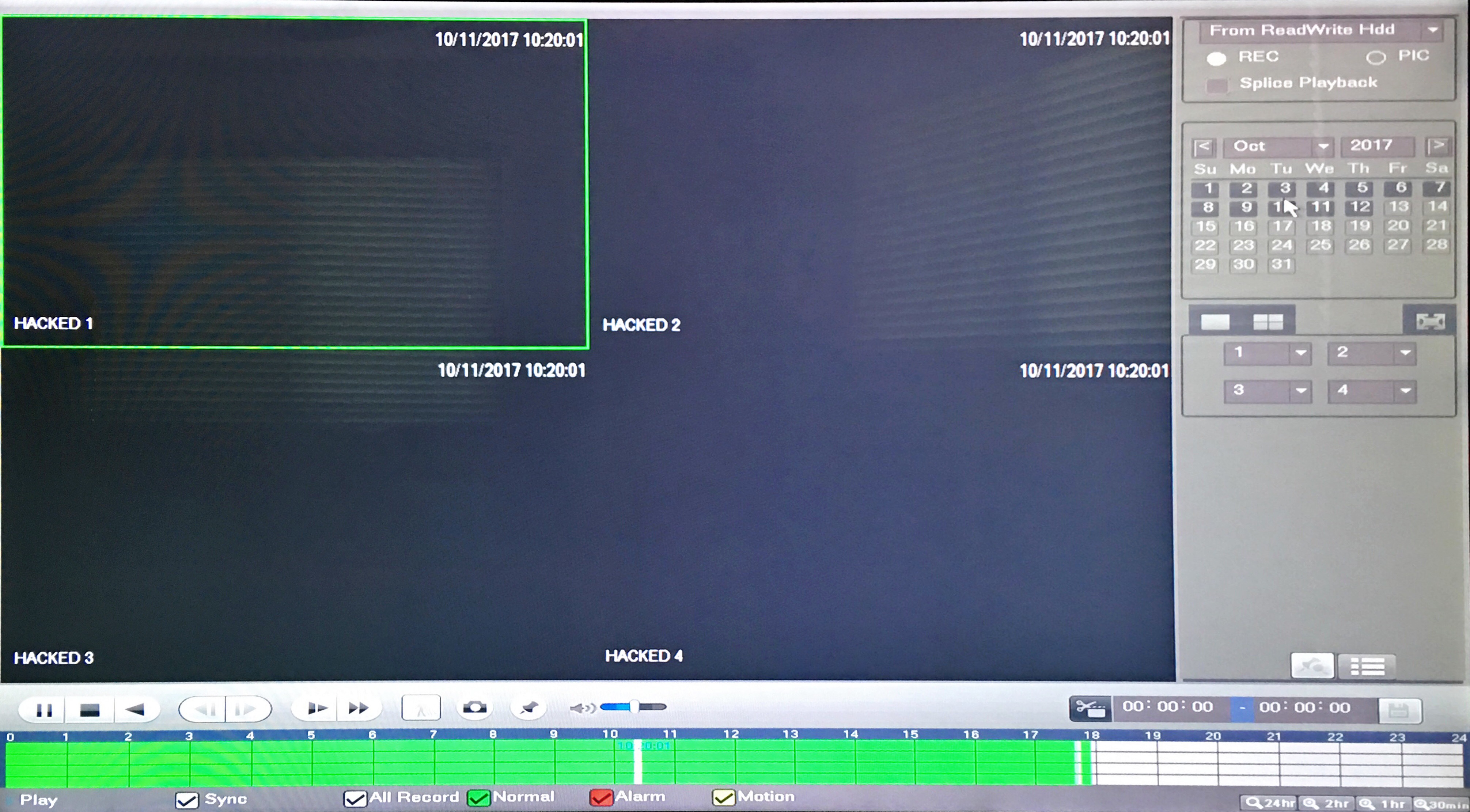

I tried to search for info on this forum, but didn't come across info that could help - yet. It looks like my AMDV7204-4B has been hacked. It had been a couple weeks since I checked the mobile app and when I checked it today, none of my phones would connect to the cameras. I came home to access the DVR and found that each of the camera names had been changed to "HACKED 1-4"!! I also noticed the user name was changed to HACKED. I have never bothered to change the names of the cameras, so I know something is up. I also had previously changed my password from the default.

I found out how to factory reset my DVR version and have updated the latest firmware. Here's a screenshot of what happened to my system. As you can see, all camera names changed to "HACKED 1-4" all with black screens. I've updated all passwords, so hopefully this won't happen again.
