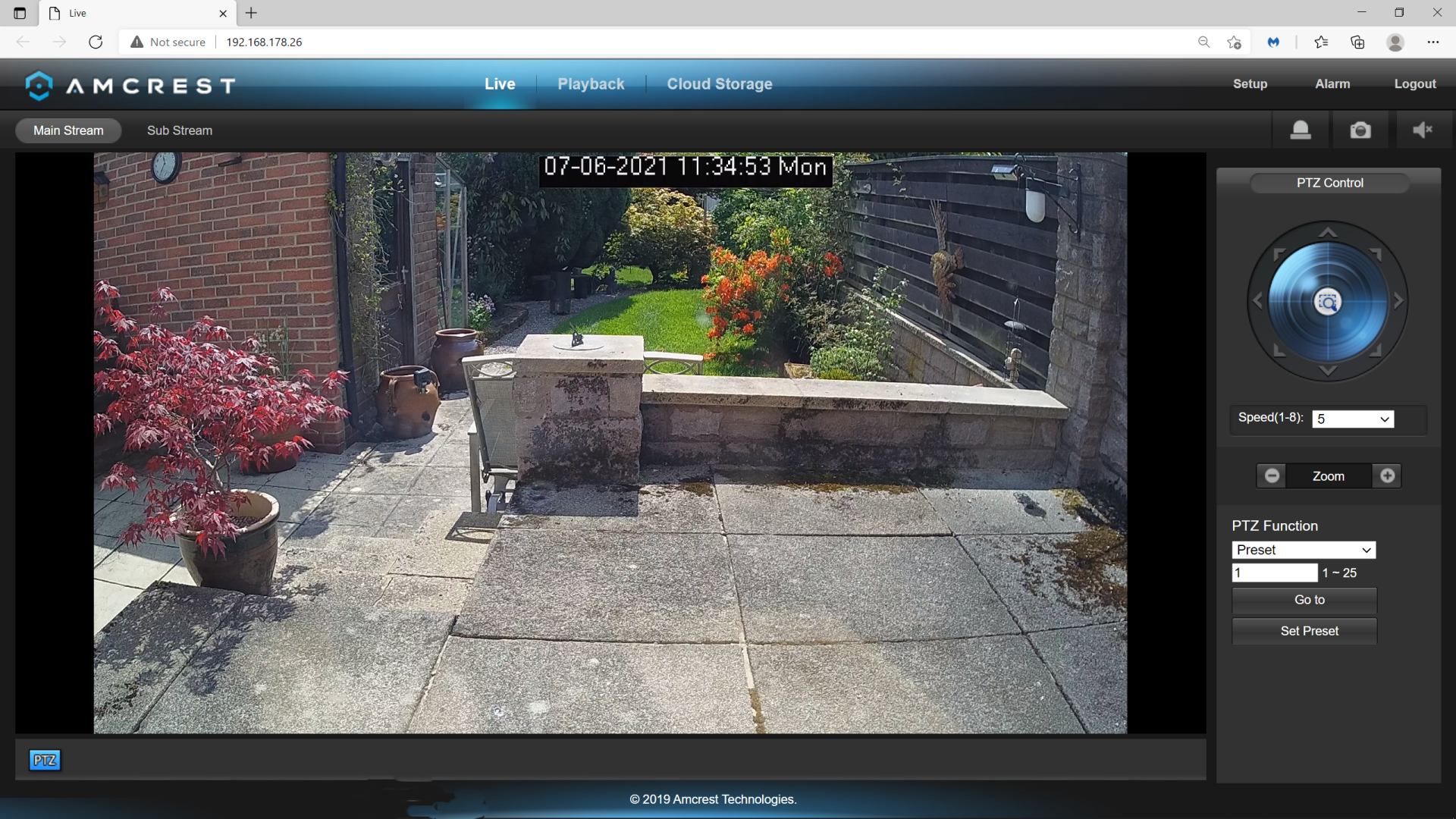

I'm a little puzzled. In your other thread you have posted a screenshot of the live view of your camera. I'm not sure what the address shown in your screenshot is "webrec", I would expect to see the local IP address of the camera. May I ask, have you deliberately blocked out the image from the camera or are you really seeing a black screen like that and how exactly did you get that screenshot? Just as an example, I've just taken a screenshot from the live view WEB interface of one of my cameras and this is what I see.

Re: AMcrest Surveillence Pro - IP4M local video record filetype
that is from using amcrestview dot com... logging into your camera it is almost like cloud service but there is no storage. It is purely a Log in portal to cameras that use P2P and it has been long time since I used it but I think you go and tell the website the camera, then you have to use the user and pass on that website and it will log in your camera. IT uses P2P and can give a good view while away of your cameras in kind of webUI looking format. I pulled it after a different company was hacked and got all the user and password off the server after that I was like NOPE to risky and pulled my account and then changed my passwords incase it keeps a old user log...
Yes I found the way to open WEB interface to connect through the IP number. Then I got seamless video stream.
