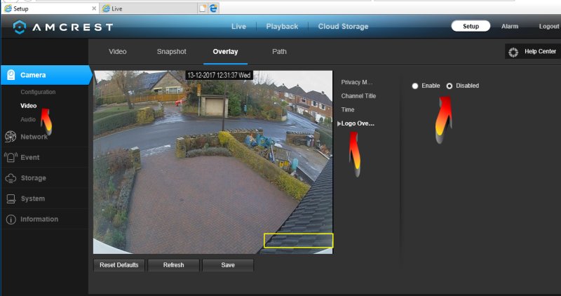

I just tried to find the option in Surveillance Pro and I can't. However I have turned the logo off on my own system and I've been able to do so because I normally use Internet Explorer (with the WebActive plugin) where there is an option to do so in setup. In the attached screenshot you can see the placeholder for the logo but you can also see that I have it disabled.

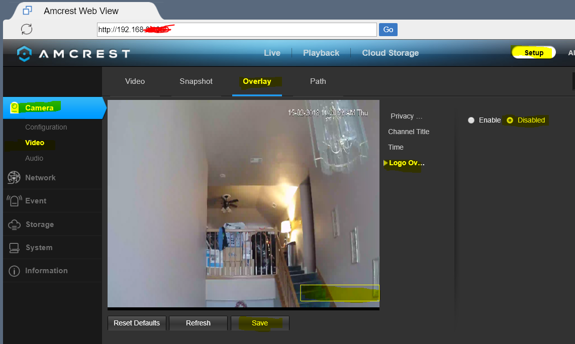

The solution to REMOVING the Amcrest LOGO is pretty simple:
1. Open a browser and enter the IP address into the address box e.g. 192.168.1.12
2. the remaining steps are shown in the attached image: Enter IP into address bar - Login - Select SETUP - Select CAMERA - Select VIDEO - Select OVERLAY - Select LOGO OVERLAY - Select DISABLE - Select SAVE.
