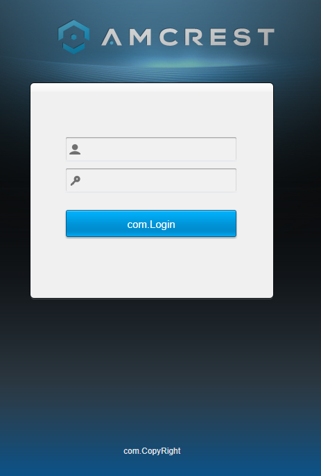

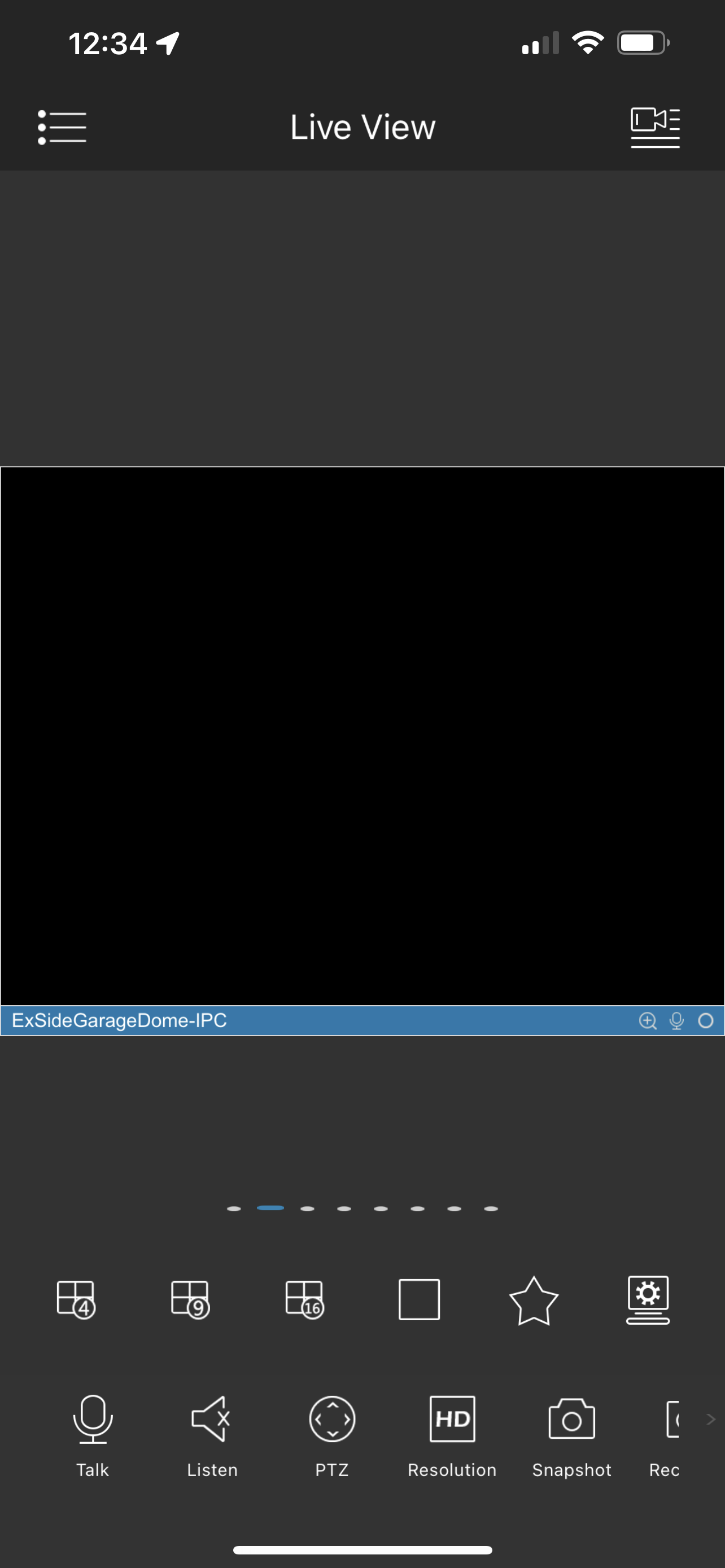

Hello All,
Just installed a Amcrest IP8M-VD2793EW at my location a few weeks back and have found for some reason with two occurances that the video feed will be totally black and when attempting to remote in via WebUI, the UI shows an odd labeling of "com.Login" instead of "submit". And Instead of the splash title of "IP Web Camera Access" its just blank. Unable to access it with any logins...just acts nonresponsive.
So far its seems to resolve itself after a hard power cycle, but worried its something indicative of a larger issue maybe.
Has this come up before? Perhaps try reflashing the firmware to clear whatever it is out? Thoughts?
