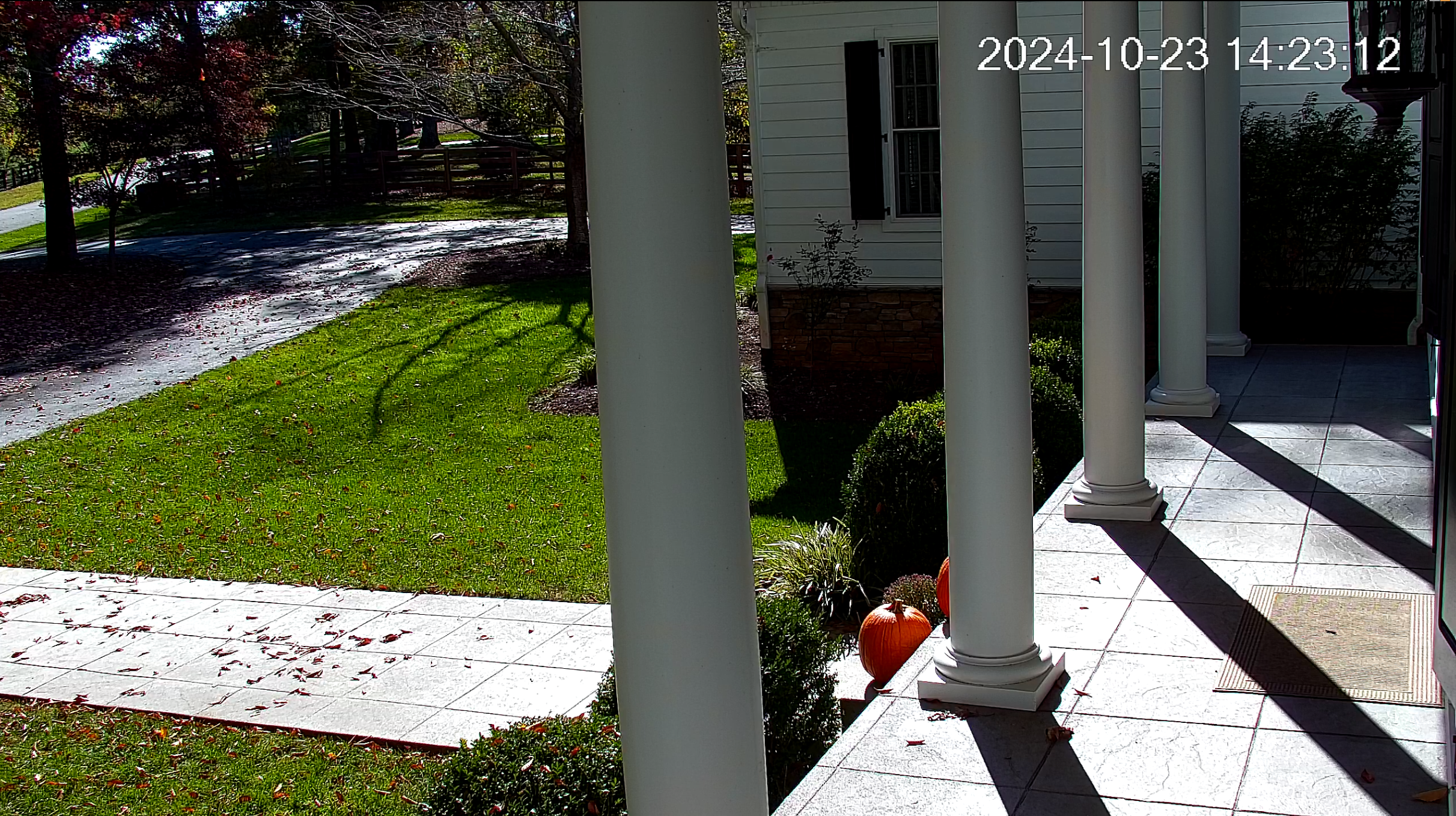

I purchased the IP4M-1063EW-AI-V2 camera recently and am exploring its capabilities. Please see the photo below. Is it possible to have the camera move within the full range of its PTZ capabilities when someone walks through the camera's current view? For example, if someone exits the home, steps on the welcome mat and then walks to the road shown in the upper left corner of the photo, will the camera automatically follow panning, tilting and zooming as needed?

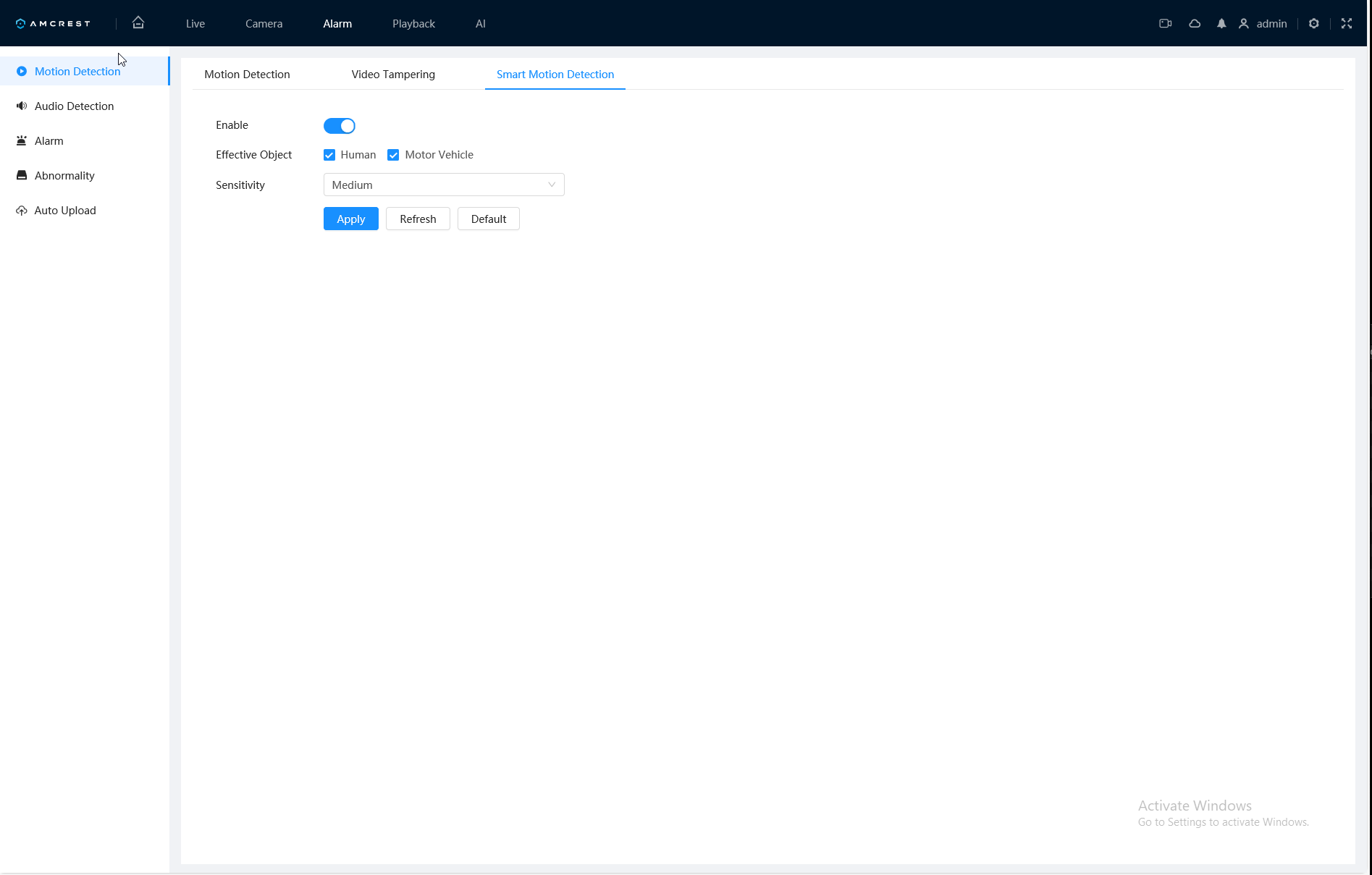

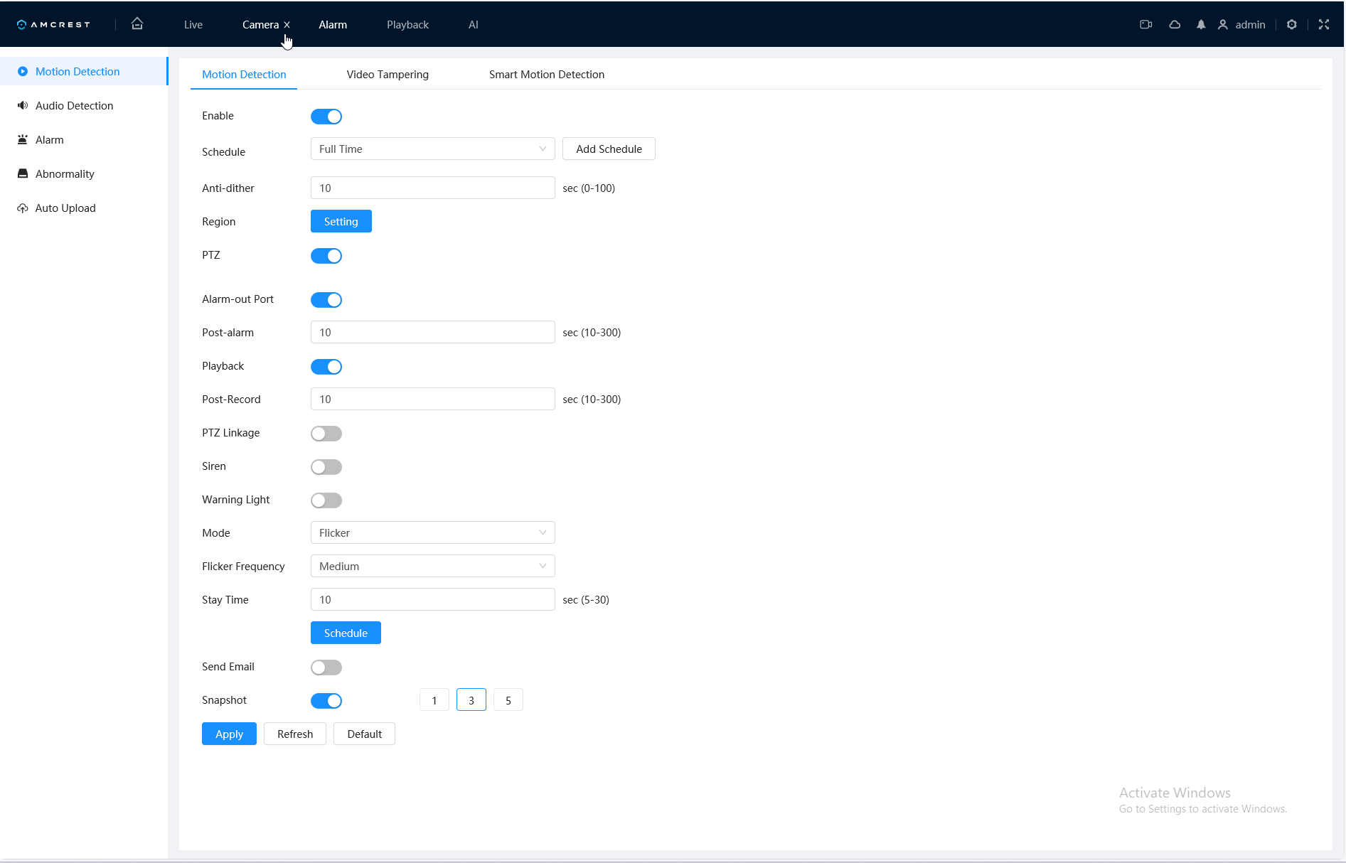

Though I have both Motion Detection and Smart Motion Detection turned on, it currently doesn't auto follow. Note that I do not have an AI rules set. I'm just expecting the camera to auto-follow anything within its field of view. I have other less expensive Amcrest cameras that do this simply by clicking on Human Detection within the Amcrest Smarthome app. I'm looking for similar functionality in this $500+ camera.

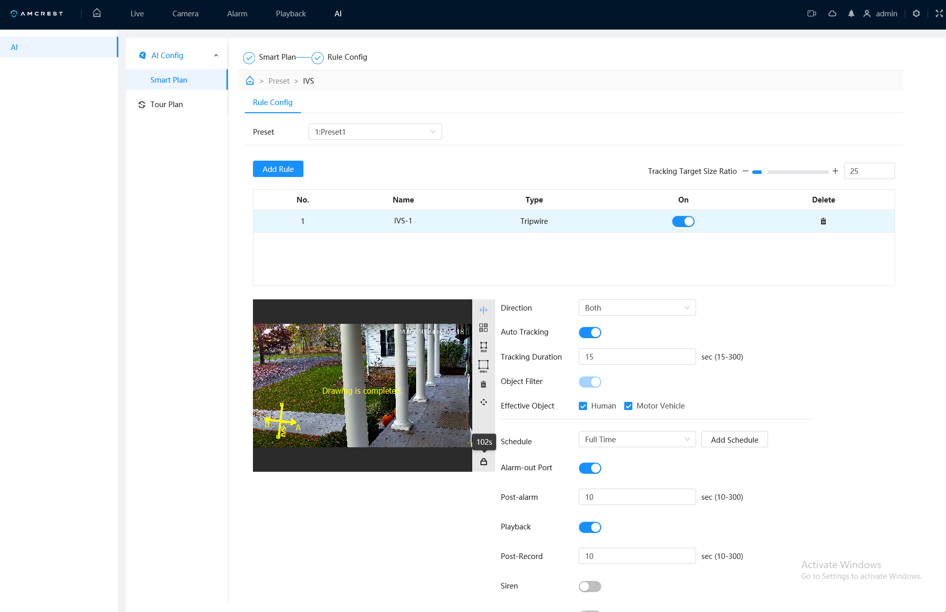

I have tried the Tripwire and Intrusion AI rules and they will track people but only within the presets. They won’t follow someone outside the present to include the full PTZ range of the camera. I keep thinking I’m missing something real simple given the simplicity of my other less expensive Amcrest cameras. Thanks.

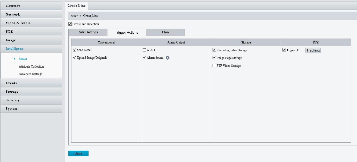

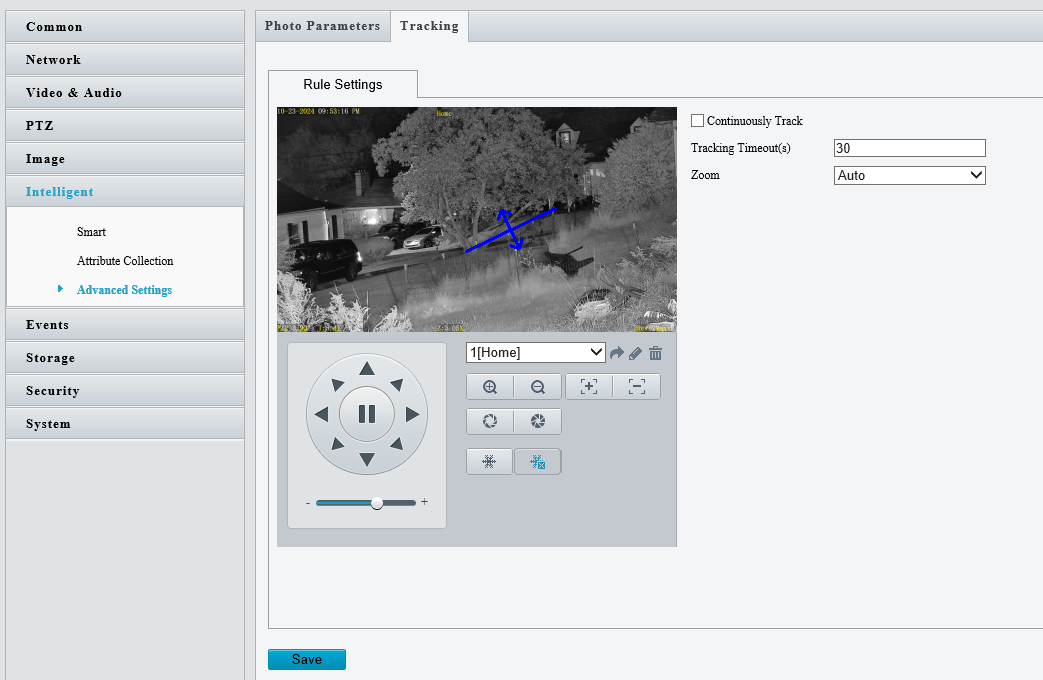

So my over costly POS Ai PTZ camera *From different brand* has the ability to auto track within my Ai rules. It also has a Full time Auto Track.
So lets say looking at preset 1 on my camera, I click on the IVS Tripwire, I click on in my case the Trigger Action, I then have the option to define what I want to do like send emails and set off an alarm, record to NAS/FTP and then there is an option at the end for Motion tracking I click that, Apply.. Now if I leave it just like that it will track with in a Set time. Then to the right of that I have a Button *Tracking* if I click that it takes me to a page where I can enable Full time Tracking and then gives a timer of 30 to 300 seconds..
Does your camera have anything within the Tracking area either under the IVS event tab or under PTZ page of the menu?
Looking at the info for the Amcrest 1063 and 1083 they both talk about setup of Auto Tracking by using IVS rules. Just wonder if there is any like my camera that might offer the Full time Auto Tracking? I don't use it myself, Seeing I have mine setup for a Home Position and if I have it at one of the other presets the Auto Tracking is enabled so if there is Tripwire or Intrusion it will auto track until time runs out or the person is out of view..

Here is my setup.

About your Scene, Can I be honest, If you are looking for a camera to track the movement of someone that crosses your Tripwire to the door I am not sure you will be very happy with the results. I mean sure there are some cameras out there that can do some crazy things. But that all comes with a cost.. See the location of the camera and the area of the trip wire you already have the cameras area in Full view to the door it seems in the picture anyway..
Problem is that at times what we want with a PTZ camera can not always be done with just 1 camera. So for instance your PTZ would be better off mounted on the wall where I see the window in front of the camera current placement. Facing the Garage I am going to assume is to the left of the current scene, Now the camera could be facing the road if that is the main area of interest, With a tripwire that when they access the driveway could trigger and follow, then a second camera Static even with a 2.8mm lens is fine, that is Ai with tripwire that is setup to trigger your PTZ to a preset with an Intrusion box, This setup for Follow and once the camera gets to the preset the person enters the box and you are able to follow them to the front door.
