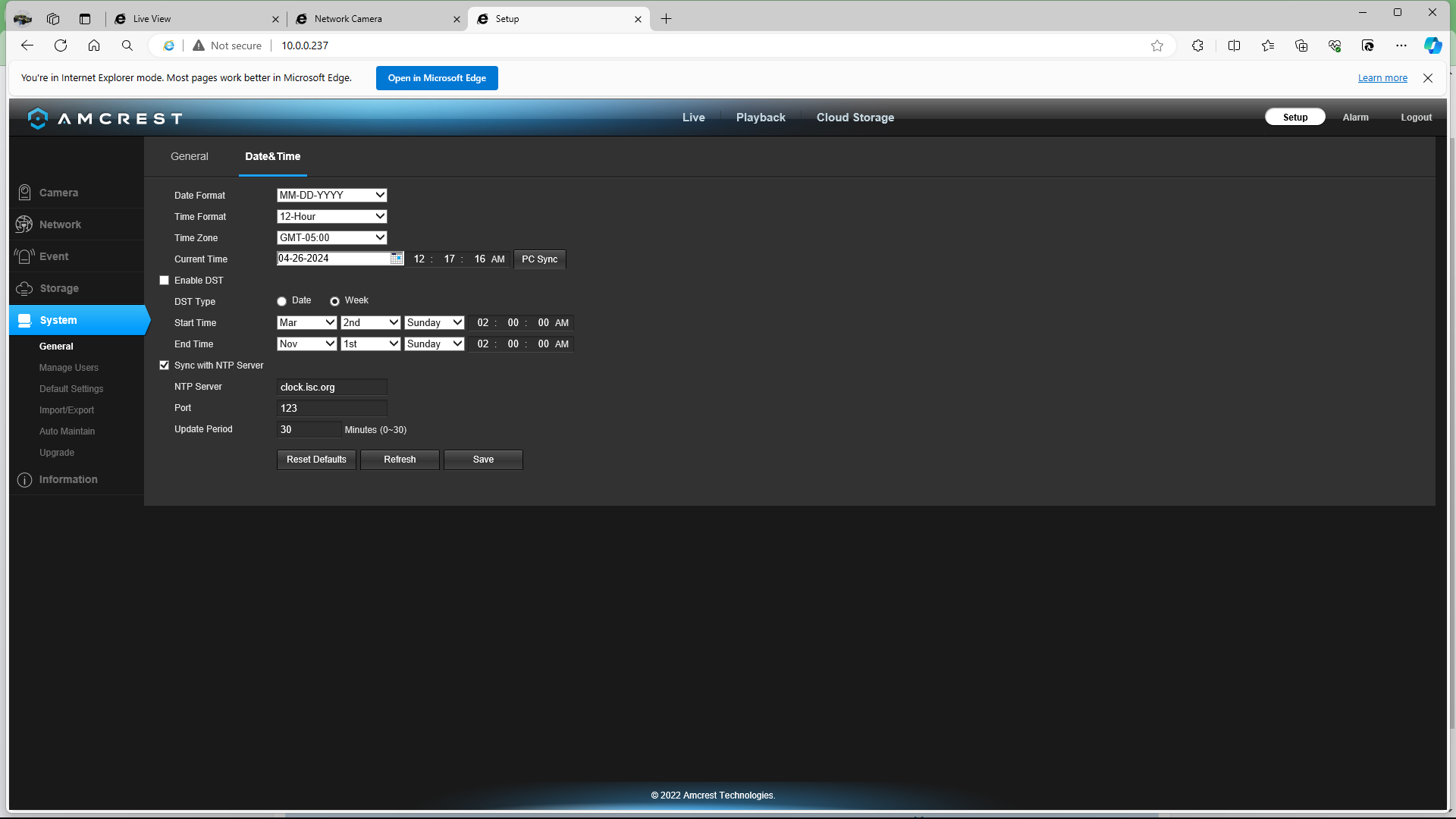

So looking at my logs I don't see any time set besides when I make a WebUI connection, and everyday when the camera reboots there is a time set. Now I will admit that my time is also sync with my NVRs however even then there is no log file in the current FW of my newest Amcrest AI Camera. The NVR also don't have an output of when it updates that I can see in the log of the NVR I looked in. It is setup to sync all cameras every 12hrs. The NVR is setup to check time with server every 60min.

Picture of my current settings in WebUI!
