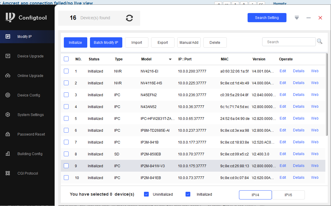

Connect camera to your local Network. Then using the tools do a search for local cameras even the camera on a different range should show up.. Then once you see the camera you will want to click on the settings tab at teh top and enter the password for your camera. Then click the box in front of the camera, then click on the edit to the right of the camera data.. IT will come up ask if you want DHCP or Static. With static you will want to make sure you know the IP info.. Then to be safe and not have to worry about knowing ip and gateway and subnet .. So While Amcrest does offer one. I would personally look at getting the Dahua tools as it has some better optoins for making changes. I keep forgetting that is what I am using. The Amcrest one is a lite model tool. Works good for searching maybe not so much for making changes on the fly. So doing a search for Dahua IP Config tools is what you would want.. IT will look like the picture below and again will have many options that makes working with IP cameras and DVR/NVRs easier..
